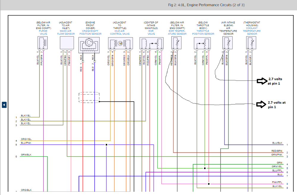

- air intake temp sensor (IAT) and EGR temp sensor (btw, as per my "guided component test component information" in my Verus scan tool, this EGR temp sensor generates a DC voltage signal that is sent to the ECM) both have 2.7 volts (i.e. the signal wire) with the wiring harnesses disconnected. You can see this information on the pic titled "1995_Jaguar XJS_Engine Performance_2 of 3_pg 1_v1" attached to this post.

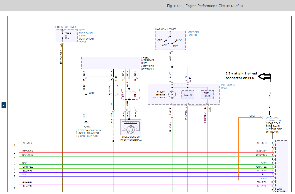

- because I also have 2.7 V right at pin 1 of the red connector on the ECU (see pic titled 1995_Jaguar XJS_Engine Performance_3 of 3_pg 1_v1), I believe somewhere in the wiring loom the EGR temp sensor (which should have NO voltage with the wiring harness disconnected and KOEO) signal circuit is grabbing voltage from the 5V reference to the IAT sensor signal circuit. Is this good logic? This problem maybe obvious to some, but before I start cutting wires I wanted to make sure I wasn't missing something.

That is highly unlikely. It's drawn as a conventional temp sensor circuit which will be supplied current limited voltage by the PCM. Never worked on a Jag but I'd expect 5V open circuit.

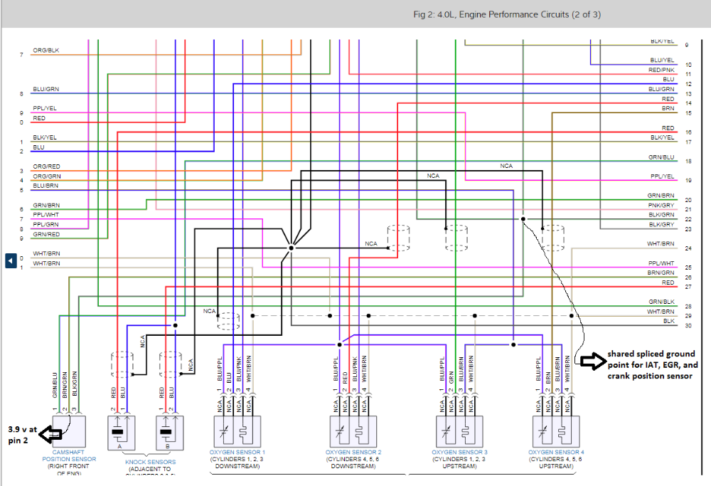

The reason EGR and IAT are both at 2.7V unplugged is probably because they're only being supplied 2.7V by the PCM. The 3.9V at the CMP is also suspect. All points to a problem with your 5V reference.

It does say in the component test section of Shop Key that it generates a voltage, but this misinformation.
More correctly, it pulls 5v to ground as temperature increases. As evidenced by circuit test described, KOEO sensor disconnected, voltage should be 5v which is to be expected on just about any temperature sensing circuit.
I agree with Matt, your test results point to a problem with 5v supply from the PCM.
