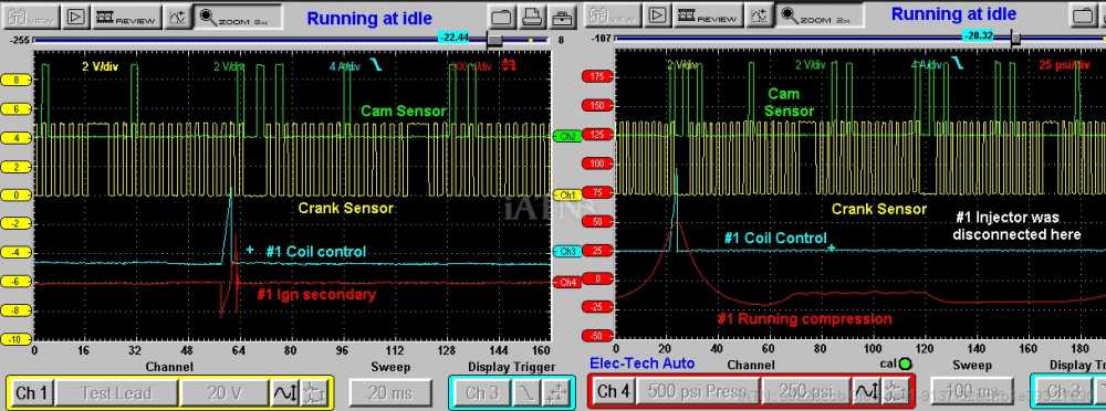

Hello gents. If anyone would be so kind as to check out these waveforms and give me your input I would appreciate it. 2009 Grand Cherokee 3.7 no start. Vehicle was at dealer who told customer "engine is shot." Customer was not satisfied and brought it to us. I found plugs to be soaked with fuel. Especially bank 2. checked for injectors leaking or stuck on with no problems found. Performed cam crank sync and cannot find a known good pattern. Then checked in cylinder compression on cyl. 1 and Primary ignition on cyl 1 to see if it is out of time. Any input would be appreciated.

9 years 8 months ago #5851 by Tyler
Sorry 'bout your troubles with uploading, sir. :( Tracked down a known good waveform, and yours looks in time.
The fouled plugs on bank two, is that the bank that's monitored by the CMP? 'Cause it's possible you could have skipped timing on the other bank and not know it on the waveform. But, you'd think it'd at least start and run badly. :unsure:
Clearly the engine is making compression, at least on bank one... Can you get a cursor on the lowest part of the decompression stroke? I'm not seeing much vacuum there, but I could be looking at it wrong.

Tyler, is there any chance you might let me send you the pico file? I have it saved to my pc and really would like someone with more skill to analyze it for me.
To answer your question, yes the cam sensor is on the right bank which is the one with no compression. I checked each cylinder and it is 0 on bank 2. Bank one I am around 145 across the board.
Cranking vacuum at intake was tough to read on a gauge. It went to about 2 but hard fluctuations.

This is another thing. the same bank upon arrival at the shop was completely flooded with fuel. Pulled plugs blew cylinders out and checked oil for contamination. It is minimal surprisingly. Anyway, I saw the low compression in the relative waveform. I then blew out the cylinders and retested. I saw that it had humps across the board now and installed an in cylinder transducer on cylinder 2. It was a strange pattern which looked nothing like the one on cylinder 1. It was low at about 40-45psi and looked strange in its form. Almost triangular and leaning a bit from the rising edge. I wanted to see if the thing would at least make an attempt to start however, so at this point I installed new plugs and tried to get it to start. It backfired through the intake like a bomb went off. When I pulled the plugs out again they were wet again after just one attempt to start it. At this point I checked compression again and bank 2 is completely flat..this is with the transducer and also a gauge to verify. So..now I dry it up again and make one last attempt to start it before quitting for the night. I should have quit while I was ahead. The intake blew off the freaking truck on the second try. I am disgusted with this thing to no end. 8 hours with no answers yet.

Andy, you are right. This morning I pulled the plugs back out and got #2 cylinder on tdc. I performed a leak down test and confirmed 100% leakage through intake valves. No reason to go any further at this point as the customer opted to replace the engine. What have I learned from this? Well...unfortunately not much...other than stop beating a dead horse. I knew compression was an issue and pressed on thinking I would find something instead of simply doing a basic test. I know better...Thanks for the input guys. I'd still like to know more about the in cylinder capture I have on the good cylinder...but I have a lot to learn in that department.

First thing I saw was the ignition timing, 7 degrees BTDC? Seems a bit too far advanced for a cranking engine. That known good waveform I found showed almost no advance at idle. :huh: Also, LOVE the Pico software for in-cylinder waveforms. Soooooo easy to take measurements.
I thought the decompression pocket looked weird, what kind of transducer did you use here? I ask because it looks like the trace flatlined as the cylinder was going into a vacuum. Almost like the vacuum was outside the transducers range.
Speaking of, it also seems like the transducer didn't zero quite right? It looks like 'zero' ended up at around 1.5 PSI. Nitpicking, I know. ;) I just notice this because my Fluke PV-350 has to be zeroed manually.
