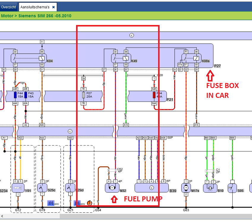

Hi
I have fuel pump problem in Benz A170 (W169) old model
When ignition is on but file bump not working?
Can any one share me fuel pump location and wiring diagram
Thank you
5 years 10 months ago #45147 by Matronix
Replied by Matronix on topic Benz A170 (W169)
It's in the tank? What do you mean with the location? Just drop the tank to get to it. Guess it's the same as in the W168 (where they failed constantly)
Will enclose for you a part of the wiring diagram

Replied by Loney911 on topic Benz A170 (W169)
Matronix wrote: It's in the tank? What do you mean with the location? Just drop the tank to get to it. Guess it's the same as in the W168 (where they failed constantly)
Do I need to remove fuel tank or It’s easily excess from rear seat?
Thanks you
5 years 10 months ago #45286 by Matronix
lower tank, not that much of work on these
