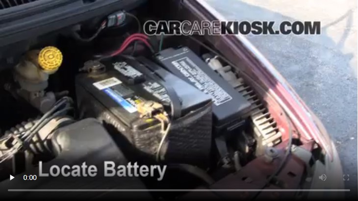

. Based on the diagrams I have seen, I'm thinking ES11 just connects directly to the battery (ie not via grounding to the body -> then from the body to battery negative) Is that what you guys think as well?

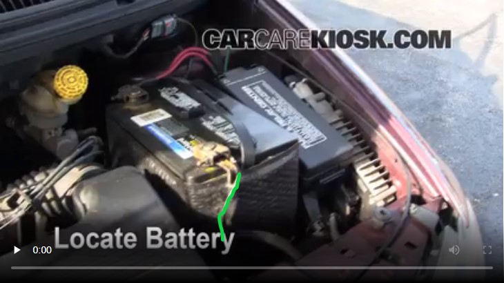

Also agree. I don't know to a certainty, but I believe ES11 is the small cable that attaches directly to the battery cable end. I'm not looking at your van, just inferring based on Google images. :silly: I ripped this image off Google because it matches the Caravans of this vintage that I've seen in the past:
Like I said, I don't know that the small cable is ES11. Or that your van even looks like this. :silly: It just happens to neatly match the wiring diagrams.
2. I'm trying to figure out where ES11 is, but my diagram conflicts with your diagram. Do you know of any diagrams I could use to pinpoint exactly where ES11 connects to the battery (or just so I don't have to tear into the harness lol)?
Negative. :( :lol: I've scoured all my service info sources, and that was the best I could come up with.
Like I said, if this were my van, I'd be 100% OK with overlaying a cable with a new eyelet. Theoretically, you could just splice into the ground wires, pin #10 and #50 of the PCM, and run a new wire directly to the battery from there. It wouldn't be pretty. :silly: But it would work.
Speaking of the eyelet, it's possible the voltage drop is still closer to the battery, or at the battery itself. You could try poking the suspected ES11 cable wherever it's accessible and voltage dropping between the B- post and the cable. If you read 5.5V, you're ahead of the drop. Move closer to the battery. If you read 0V, you're behind the drop. Move closer to ES11.

5 years 7 months ago #47472 by bachi
Right, I should have included images of the car at some point, but yes those images are spot on, exactly the car I'm working on (including the wire that runs parallel to the main cable).
Thanks for the suggestion, I'll try poking at the wire and measuring voltage along it starting from the post to see if I can figure out where exactly the drop is coming from.

5 years 7 months ago #47521 by bachi
So ... I've figured out the issue
Attached to the b post of the battery are the main cable and the ES11 ground wire.
The ES11 ground wire has 3 parts:
The eyelet, which connects to the main cable end
The eyelet clamp, which grasps onto the exposed part of the wire, connecting the wire to the eyelet itself
and the actual ES11 ground wire
When measuring voltage from the exposed part of the wire at the eyelet clamp to the b post of the battery, sure enough ... there was 5.5V.
I cleaned it up thoroughly, retested, 0V, car starts fine.
It looks deceivingly ok, and all of the tests I did before where I attempted to move the eyelet didn't change the voltage (because I had the negative cable on tight), but it was always right there.
You are right Tyler ... the drop was pretty close to the battery
