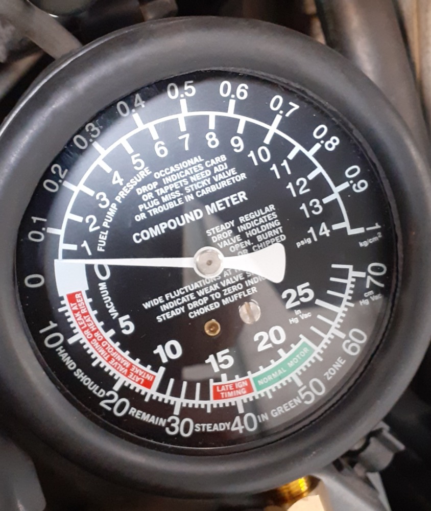

I have been battling to secure an exhaust back pressure gauge locally so this morning I soldered a brake line to the
fitting of my vacuum gauge, the one I bought since joining this forum :) , and attempted to check back pressure.
All I get is 1/2psi at idle, which stays there at 2500 rpm.
But something that interests me is that from a cold start, on a reasonably cool morning, within 2-3 minutes the fitting
got hot enough to melt the solder off.
My current theory, without knowing what the reading should be, is that either 1/2psi is enough to cause the issue
or perhaps there is something rolling around in the muffler occasionally blocking things up.

5 years 10 months ago #45325 by Chad
Desmond6004 wrote: P0401 "EGR flow" keeps returning I removed the new EGR and inspected it and blew out the exhaust gallery
EGR Flow problems happen on the Intake Manifold (low pressure) side of the valve. Relatively speaking, the Exhaust side is high pressure. The hot, high pressure exhaust condenses with carbon when it hits the cool, low pressure passages of the intake manifold. Check the intake manifold passages.
There's no problem, there. I don't worry much about anything under 1 1/2 - 2 pounds. I'm concerned at 3 pounds, though.

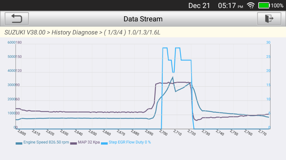

I took the vehicle home and monitored live data on the way.
In this graph the vehicle has been idling in gear, then in neutral it drops down a bit, then
I put it into gear and take off to 50kph and you can see the duty cycle of the EGR.

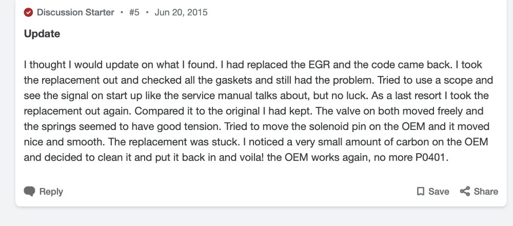

5 years 10 months ago #45332 by Desmond6004
Replied by Desmond6004 on topic Suzuki Swift stalling and EGR codes. P0401
Post #5 on this thread is beginning to sound like my problem - a cheap replacement EGR valve sticking occasionally

5 years 10 months ago #45335 by Matt T
Replied by Matt T on topic Suzuki Swift stalling and EGR codes. P0401
Desmond6004 wrote: I took the vehicle home and monitored live data on the way.
~25 seconds to ~30mph shouldn't be anywhere near WOT. The fact EGR flow is commanded also suggests part throttle.
But the MAP is up around atmospheric pressure?? I'd go after the MAP.
Also the ECM may use MAP to detect EGR flow so funny MAP readings could be the cause of the P0401.

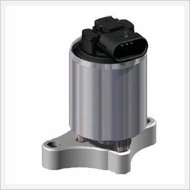

5 years 10 months ago #45343 by Tyler
Replied by Tyler on topic Suzuki Swift stalling and EGR codes. P0401
Wait a second, is this (generally) what the EGR valve looks like?
If so, are there any valve position PIDs? That'll be the trick to catching the valve hanging open or closed.
Just about every vehicle I've seen that uses that style of EGR valve gets checked for flow during a warmed up, closed throttle deceleration. Highway speeds, throttle off and watch the EGR duty cycle blip up. There should be a corresponding change in MAP vacuum. Not enough of a change, or no change, signals a flow problem.

5 years 10 months ago #45353 by Desmond6004
It is a 6 wire EGR - 3 wires for movement, 3 for a potentiometer. But if the EGR sticks open the system doesn't know that, it simply takes longer before the actuator touches the plunger.
