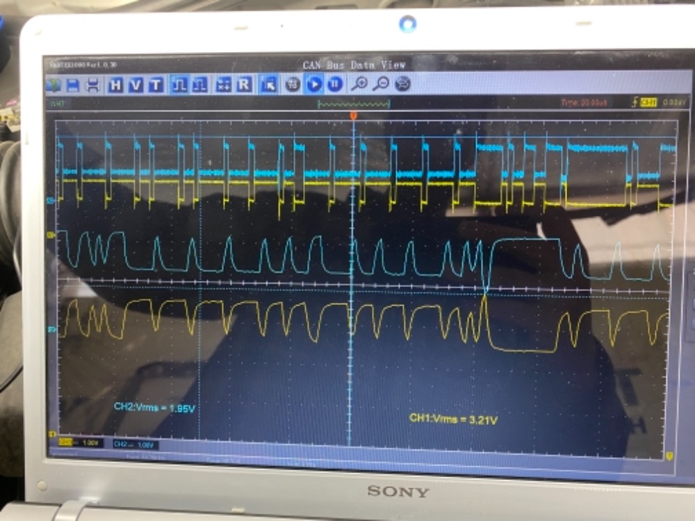

I have a scope I’ll send what the wave looks like. It’s not got the sharp edges on the front of the bit signals.

This is my CAN bus on the scope. The top lines are my scopes explanation of what it should look like. The bottom lines are my CAN buss. I get this with the old ECM and it’s the same with the new ECM.

That wave form does not look good. I would say to do a pin drag test on the connectors and inspect pins for corrosion/ fluid intrusion and check /clean ground points for tcm, fuse box and pcm. But with the communication working on sps i would say you china knockoff is the problem. However one way to tell is to unplug on module at a time on that section of the network and see if signal improves and comms work again with tech 2. Other wise find a identical car and test comms with it.

Are those the waveforms with the engine running? Or just let on engine off??

this scope was with just the key on and the engine off. I will try it with the engine running. thank you for the reply

tested the can bus on my 2014 Ram and it looked the same on the scope as my equinox did. so i have an issue with my scope. I just bought it. Its a Hantek 1008c. I'm a little disappointed with it. I really don't see a way to calibrate it. So my Can bus must be fine. I really at lost on why I can't communicate with the TCM. I have checked all of the connections voltages and grounds haven't found anything unusual. Resistance is 121 ohms. End resistors are 60 and 61 ohms.
