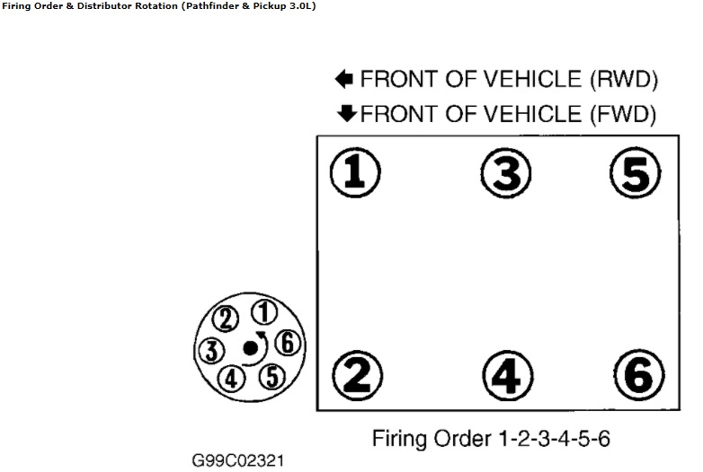

If all 3 cylinders that are misfiring are on the same bank, did you confirm that the spark plug wires didn't end up on the wrong cylinder? I would double check since its quick and easy! I've attached a firing order diagram for you
