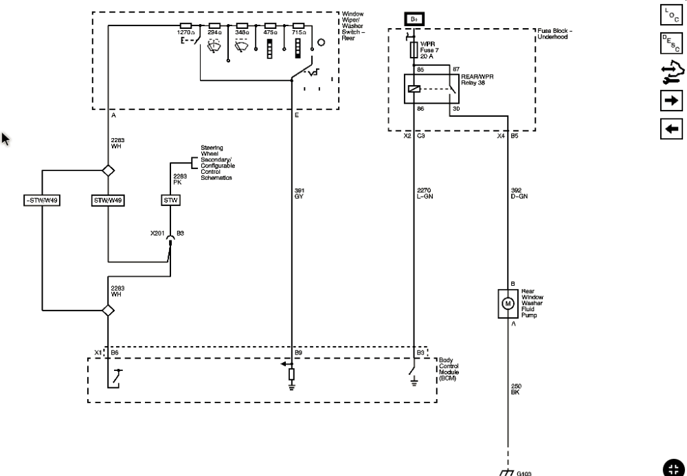

5 years 9 months ago #45815 by autojoe
Replied by autojoe on topic Switch input testing
2008 Chevy trailblazer 4.2. Rear washer don't work. Rear wipers work. Fuse and washer pump good. Relay good. Can bypass relay and pump works. Tested relay good. Watched scanner Danner do bypass test on gmc where separate wire for rear washer pump. On my truck one wire Grey for rear wipers and rear washer pump input to bcm. Bcm sends serial data to liftgate control module. When I push wash button no request in bcm or liftgate module. I would like to do a bypass test at switch and don't know how. 4 wires constant power and ground IP Lighting wire and signal wire to bcm. No separate wash signal uses Grey wire for wipers and wash. Don't understand resistors with wash circuit and what voltage will trigger bcm into commanding rear washer pump on bypass test. Rear switch unplugged got 12 volts on white 0 volts on the back wire 0 volts on IP lighting wire if I turn lights on IP brown white wire voltage is 10 volts. Grey wire is zero volts. Plugged in got 12 volts on white 0 volts on black Grey wire 2.49 volts 1st position 2.49 volts 2nd position 2.95 volts 3rd position 3.48 volts when I push wash button voltage stays the same. Any ideas on how to do a washer bypass test. I am thinking switch but can also be bcm. I replaced washer pump thinking it was that before testing. Don't want to throw parts at it. Maybe scanner Danner has a input. Ty all.

5 years 9 months ago #45821 by Matt T
Replied by Matt T on topic Switch input testing

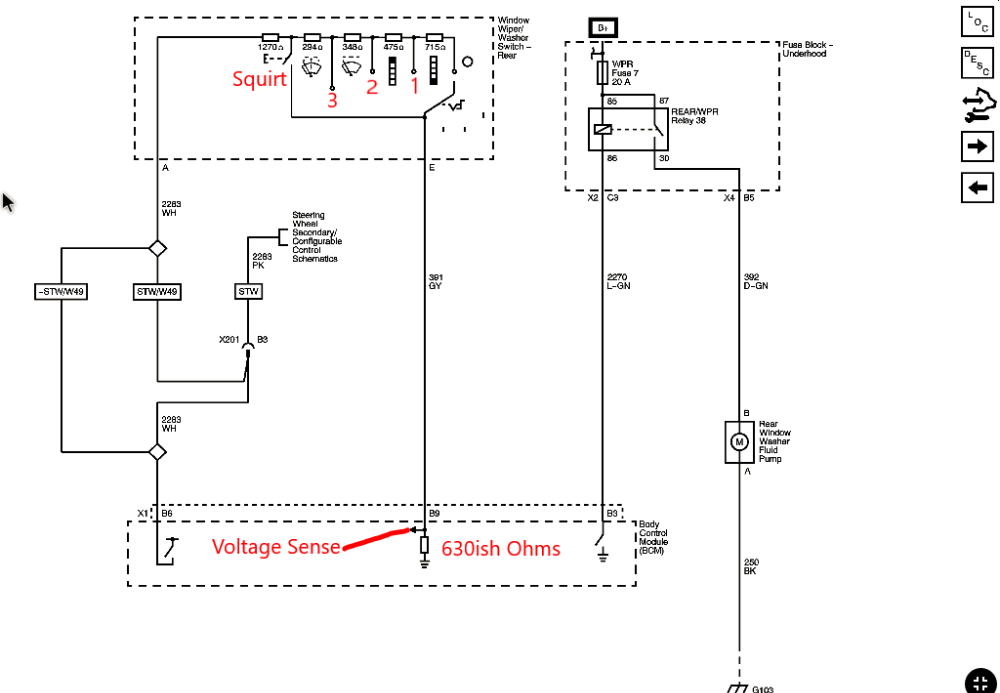

autojoe wrote: Don't understand resistors with wash circuit and what voltage will trigger bcm into commanding rear washer pump on bypass test.

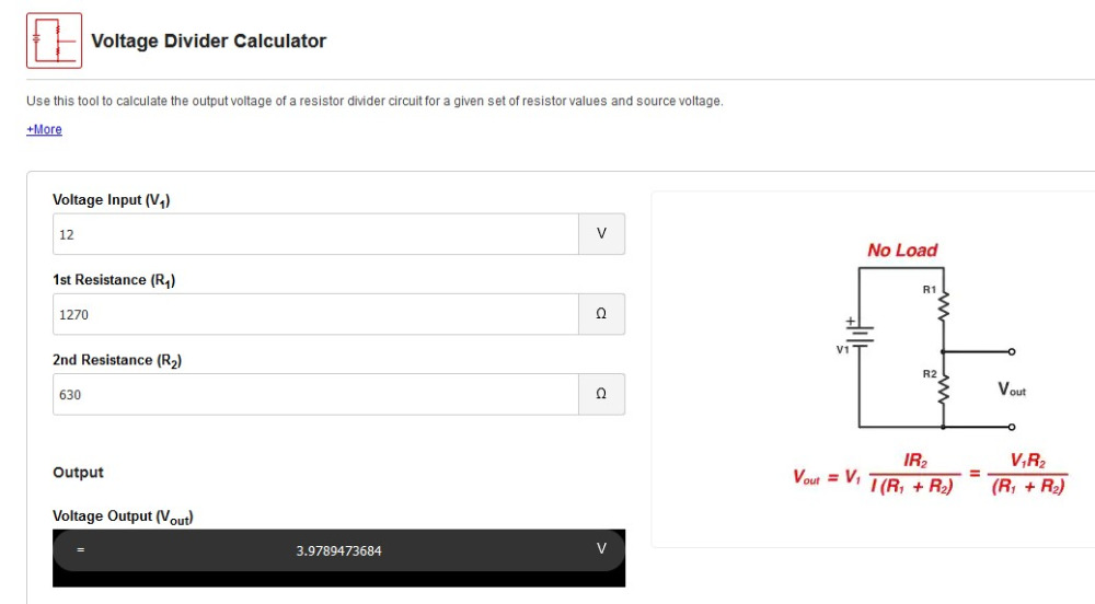

The resistors in the switch are R1 of a voltage divider circuit. R2 is the resistor inside the BCM which appears to be about 630 ohms. BCM senses voltage on the switch side of R2.
www.digikey.com/en/resources/conversion-...ator-voltage-divider
Position 1 switch resistance is 1270+294+348+475 ohms. Resistance steps down thru' positions 2 and 3. Then squirt bypasses everything but the 1270 ohm resistor. Plugging all that into a voltage divider calculator you should have about 4 volts on the grey wire for squirt.
Easiest bypass test would be to put 1270 ohms across the white and grey wires if you've got resistors you can do that with. Or a pot you can adjust to 1270 ohms.

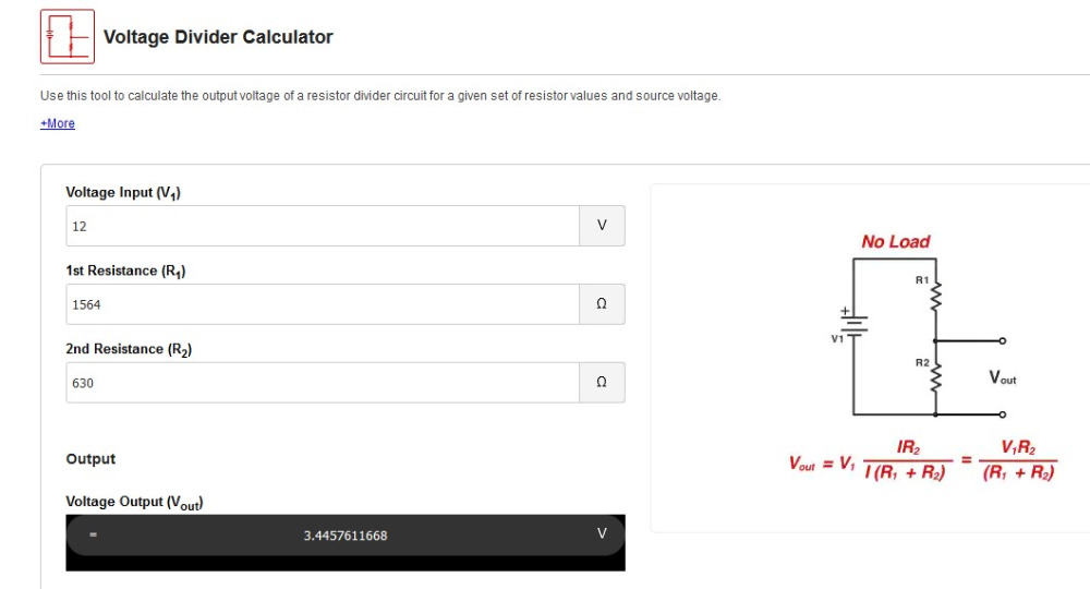

I tried to calculate using tool came up different numbers. Could you please explain. I would appreciate it. Thanks again. JOE

5 years 9 months ago #45829 by Matt T
autojoe wrote: I tried to calculate using tool came up different numbers. Could you please explain. I would appreciate it. Thanks again. JOE
I'll use switch position 3 for this example just to keep the math easier. You measured 12V into the switch and 3.48V coming out. R1 in that position is 1270 + 294 ohms for 1564 ohms total. I just plugged 12V and 1564 ohms into the calculator and played around with the R2 value until I got about 3.48V. 3.446V actually so I probably started with one of the other positions. I actually ran all three positions to check they all calculated close to what you actually measured.
Now I've got a believeable number for R2 I changed R1 to 1270 ohms, which is the resistance for squirt, and it calculated about 4 volts.
