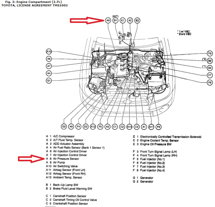

Looking for the location of the map sensor on a 2010 Toyota Tacoma. Or the sensor it using for barometric pressure. PID displays 99 kPa at all times. Thanks

Assuming it is a 2.7L, I have attached a component location diagram.
