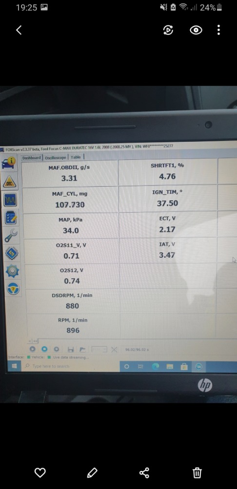

Hi everyone I'm new here, I recently bought a ford cmax 2008 that has an engine hesitation only on acceleration. I've bought a forescan elm cable to plug it in however it shows no dtc codes. I have access to live data however I'm not sure what I'm looking for. So I thought I'd come to the pros. Doee anyone have any advice for me on how to diagnose this fault? I really appreciate any help thanks very much.

I recorded this from forscan today the first part is the sensors you mention then I flipped to throttle position sensors on idle. Any help would be much appreciated thanks.
5 years 9 months ago #45876 by Hardtopdr2
Replied by Hardtopdr2 on topic Acceleration hesitation live data
Was this taken with engine cold?
I believe it said open loop for the open loop/closed loop fuel trim info. When does it hesistate on acceleration with engine cold or warmed up? Both?
If you have the capability start recording those pids again from cold engine till warmed up and the issue occurs. Then save the data for the whole trip. The main things to look at is grams/sec maf reading, rpm, fuel trim ST and LT. I did not see an issue with iat, ect, tps, or o2 sensors though you were switching between screens pretty quick. ST Fuel trims showed a positive 9 which after a throttle snap is normal though when recording stuff like this you want to make sure you record the engine restabilizing afterwards as well.
From the looks of the data nothing is out of the ordinary, however you might want to pull spark plugs and check the gap, as well as check maf for dirt on the wires inside maf and clean with a qtip or acid brush with maf sensor cleaner.

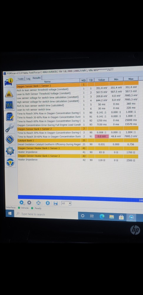

Thanks i will do. The only other thing I took was this photo after I drove it.
  • Kylet1990
  • Kylet1990's Avatar Topic Author
5 years 9 months ago #45878 by Kylet1990
Replied by Kylet1990 on topic Acceleration hesitation live data
And this one
5 years 9 months ago - 5 years 9 months ago #45891 by Hardtopdr2
O2 sensor Bank one sensor two looks like it is having an issue from that pic. That i would look into / test. i also noticed the ohm reading is higher compared to bank 1 sensor 1.
The other thing i noticed is timing is at 37.5 degrees at idle i would say to look at service info for what it should be or an identical vehicle to compare to.
