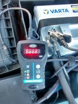

My answer would be 70ma is ok 80ma is the top limit of high normal. Repeated deep discharges (ie. discharging a battery below 50% of its amp hours capcity) especially coupled fast recharges reduce the amp hours capcity of lead-acid batteries.
I would suggest you get the battery tested with hi-tech digital battery analyzer (sometimes called an AC Impedance tester or a Conductance tester), this will give you an estimate of the true Amp Hours of the battery, the effective cranking amps and predict the life remaing as a percentage.
Don't be surprised if your battery which started out as 50 to 60 amp hour battery now only has a 15 to 25 amp hour capacity left. If you replace the battery consider the slightly more expensive AGM battery type as they stand up better to this type of use pattern. As you live in a sunshine state also consider using solar charger when the car is not in use.
This is the low cost battery analyzer I use
