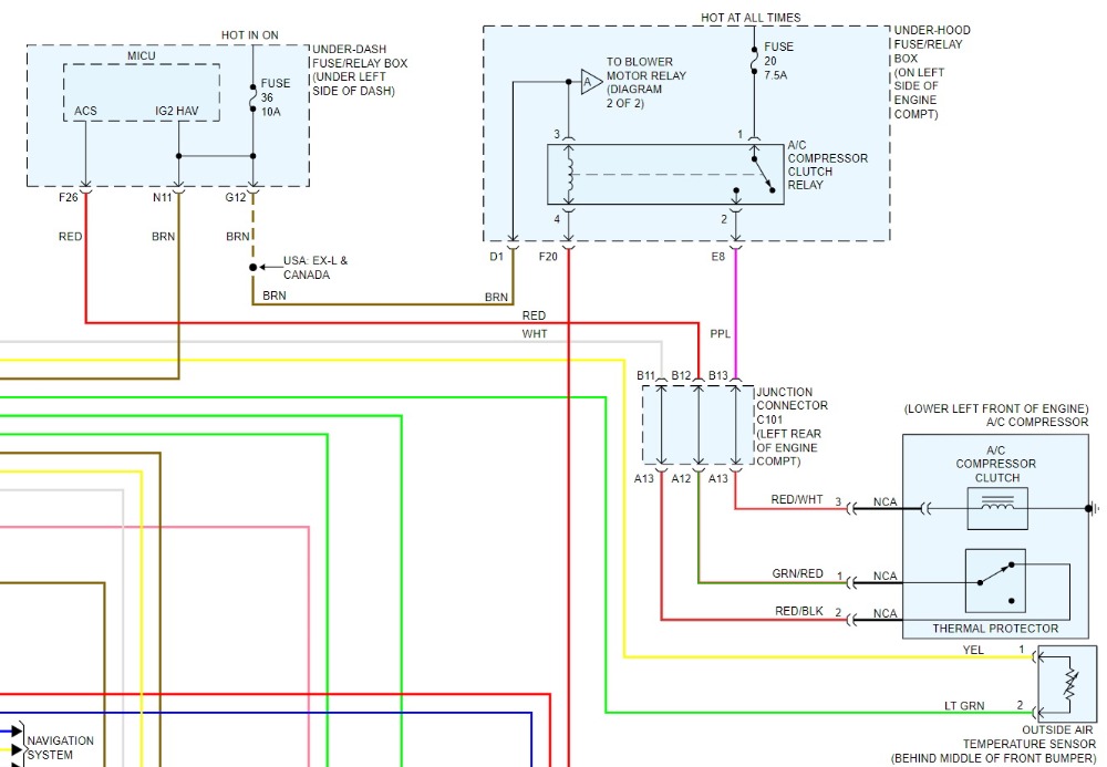

Making an assumption that this is manual controlled and not a climate controlled system here. I looked back through your question and I don't see a distinction anywhere. Most of them are manual so if you have an automatic climate control system, this information may differ...
Accessing Alldata to look at the system, I see the following: I'd start with the basics.
First - Check fuse 20 - 7.5 Amp under the hood. Let's make sure that guy is healthy.
Second - Check fuse 36 - 10 Amp under the dash
From there, I'd check to make sure you're still getting power on E8. Comes out of the compressor relay as a purple wire, turns into a Red wire with a white tracer at the compressor connector. I'd backprobe it with your gauges on.
If the compressor is just not receiving the appropriate 12 V signal to command the clutch engagement, you should be able to force it on by applying voltage. Apply a fused 12V signal to the clutch. Watch your gauges and see if you get compression. At that point, you should see the low side drop, high side raise, and get compressor engagement.
If you apply 12 V to that red wire with the white tracer and you aren't getting compressor engagement, stop. There's something wrong with this compressor. Compressor is case grounded so the only input for commanding this thing on should be that wire. The other two wires have more to do with thermal protection than compressor operation.
Do not apply voltage for too long. You are bypassing the compressor's safety systems by doing this. Great for testing but disaster if you keep it engaged for long.
I know it's basic but I'd start here.

You might be right, as I said, AC isn't my strong point.
With a bad expansion valve, you'd still get compressor operation. It sounds like we have none.
That being said, my understanding of compressor off pressures would typically be around 60 PSI. It sounds from what he said like he knows he's not getting a commanded signal to engage the compressor clutch.
Even the video you linked to has low side values of 30 PSI and high side at just above 100 PSI.
"Now no ac fan motor and no power to clutch which tells me system is not being commanded on."
This tells me he probably verified some of the things I even said earlier, although I'd want to double-check.
I'd agree with him at the moment, given the little information that I have. The system isn't even being commanded on, which is why I mentioned starting with the basics.
My guess is that there's a bad signal from either a pressure sensor or a bad wiring issue causing the HVAC system to prevent the compressor from cycling on. Something either didn't get plugged back in when the compressor was replaced, the AC system was not properly refilled, or there is a wiring or sensor issue. Just my guess. Either way, the HVAC control unit is not commanding the clutch to engage to begin with.
Again, I absolutely could be wrong. This is based on my understanding of the system and what he said is happening.
