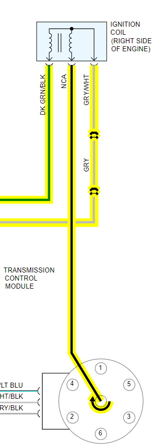

Hello guys, (and gals if any). I have a 1994 Jeep Grand Cherokee with the 4.0. As the title says, I am getting 7.3 volts at the coil terminal. Of course, the engine won't start. I checked the Auto Shutdown relay and it is good. I also swapped with other similar ones and there was no change. I get 12.x volts on the 30,87 and on 86 or 85 terminals. I don't have my notes handy. One of the two read nothing. I plugged in a u-connect and was able to get 12v at the coil and fuel injector terminals (since they are in the same circuit) and I was able to start the engine. It ran great. It would not start with any of the relays, including a new one I got just in case. It would seem it is a relay issue, but they work in their respective places, (horn, A/C). Could you point me what to check next? I would appreciate it.
Previously, the Jeep would die in all kinds of circumstances; at stops, on the freeway, etc., and it always restarted, until it would start no more, which is where it's at.

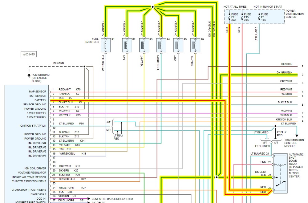

It appears that battery voltage is supplied to the ignition coil and the fuel injector through the ASD relay. The wire that supplies voltage to everything is the dark green with a black tracer. Those are all grounded by the PCM for activation.
Check to see if you have the same voltage at one of the fuel injectors. If that's the case, take it right to the ASD relay.
Assuming you have some type of scanner, I'd see if your scanner reads RPM while cranking. If not, I'd start with scoping the crankshaft position sensor. Make sure you have a healthy waveform. Crankshaft sensor in many cases provides the PCM with engine position so it knows when to fire the ignition coil and such. PCM likely uses that information to cycle through the fuel injectors as well.
These crank sensors are known for failure. It will absolutely have this type of result.

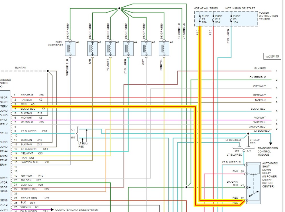

Thank you very much for the reply with the valuable information. I do indeed have the same 7.3v at the injector and coil. You say to take it to the ASD relay. What can I check there?
I do have a Solus Ultra with the adapter for the data port so I will see what information I can get. It must be an OBD 1 system, being a '94. Thank you for the schematic. It is a far cry from the PDF vehicle manual I have.

You should have battery voltage where it says "Red 22" by the ASD Relay. Starts at Fuse F2 - 20 Amp, comes down at the red wire to the ASD and splits off from there to the PCM. It appears that when the ASD is energized, battery voltage is transferred through the relay to the green wire with the black tracer Dk Grn / Blk 24
I'd check both sides of that. You should have equal voltage on both sides and it should be 12 volts, I think. If it's lower than 12 volts, you may have to trace that wire back to Fuse F2 - 20 Amps to see what you have there. Really should be battery voltage throughout though, from what I can tell.
