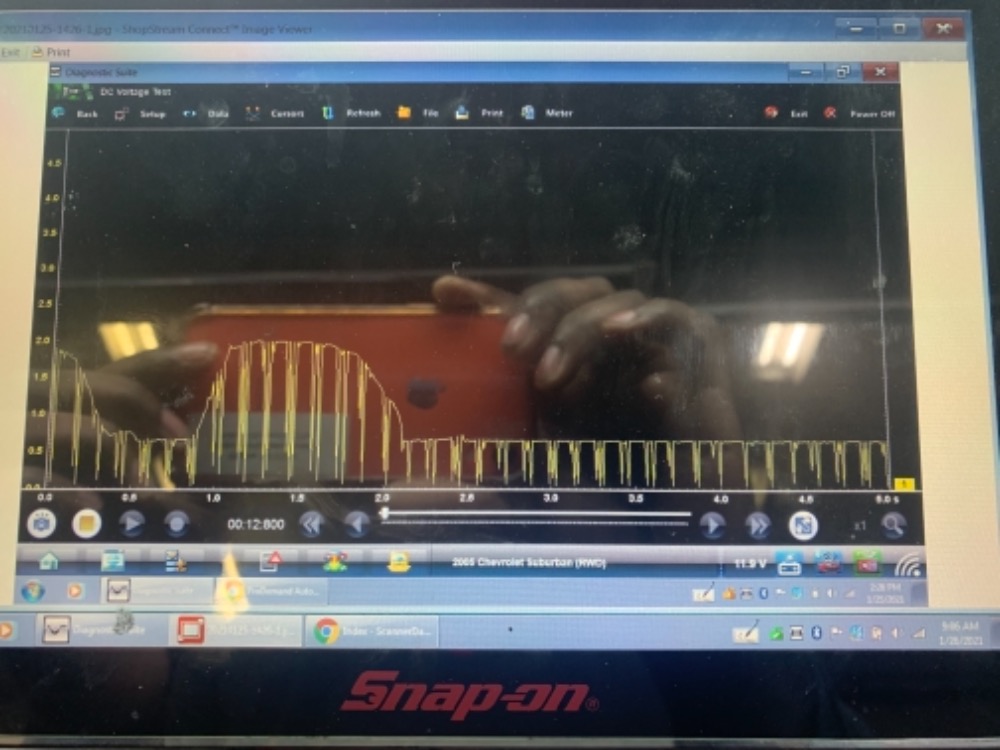

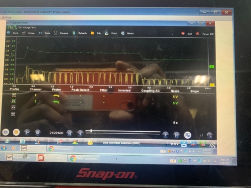

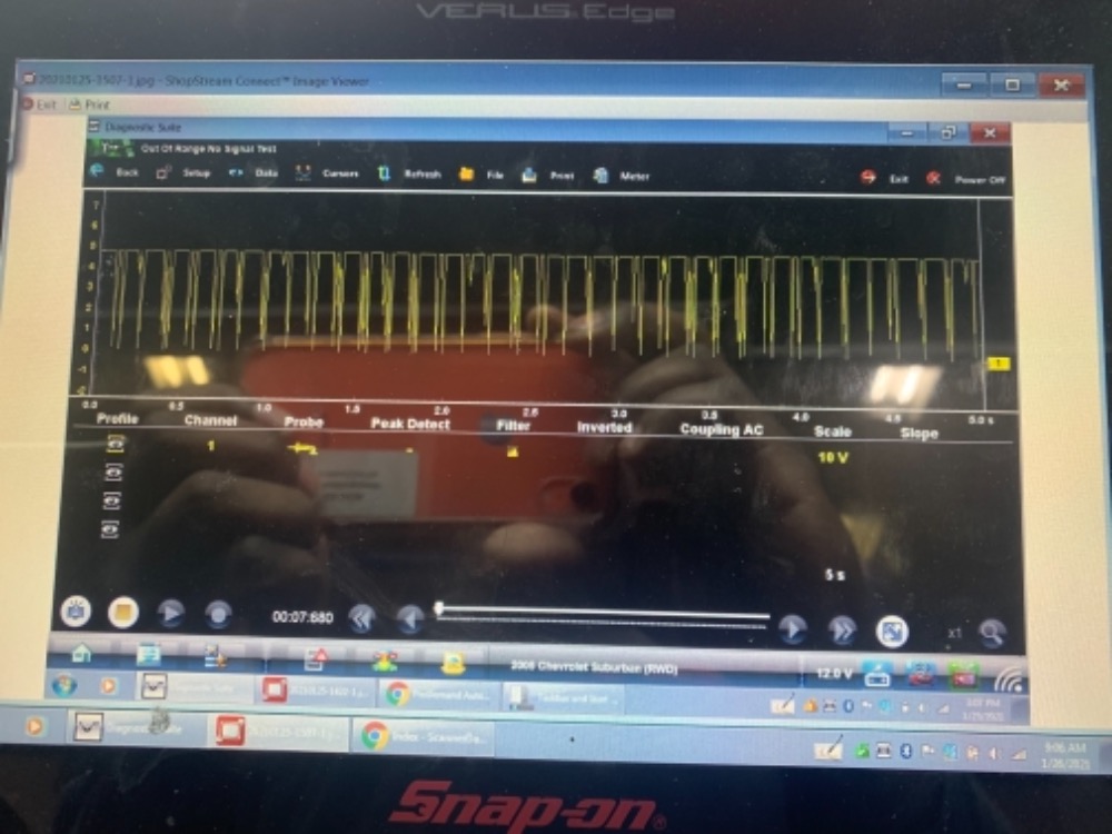

2005 Chevy suburban APP sensor 2 and Throttle body Position Sensor 2 circuit have drop outs in 5v and sensor circuit. What's my next step?

Pretty sure those dropouts are normal. Part of the PCM's diagnostic strategy to detect if APP1 and APP2 (Or TPS 1 and TPS2) get shorted together.
What's the fault code? Like Cheryl asked, how long does it take to reset?

Replied by DigorDiePerformance on topic 2005 Chevy suburban APP sensor 2 circuit
I think you're right about the dropouts being normal on the app/TPS sensor 2 side of the circuit. I.have 2007 Chevy 6.0l truck in the shop. Same dropouts on that circuit. For now im just clearing the code and shipping it since it passes.
