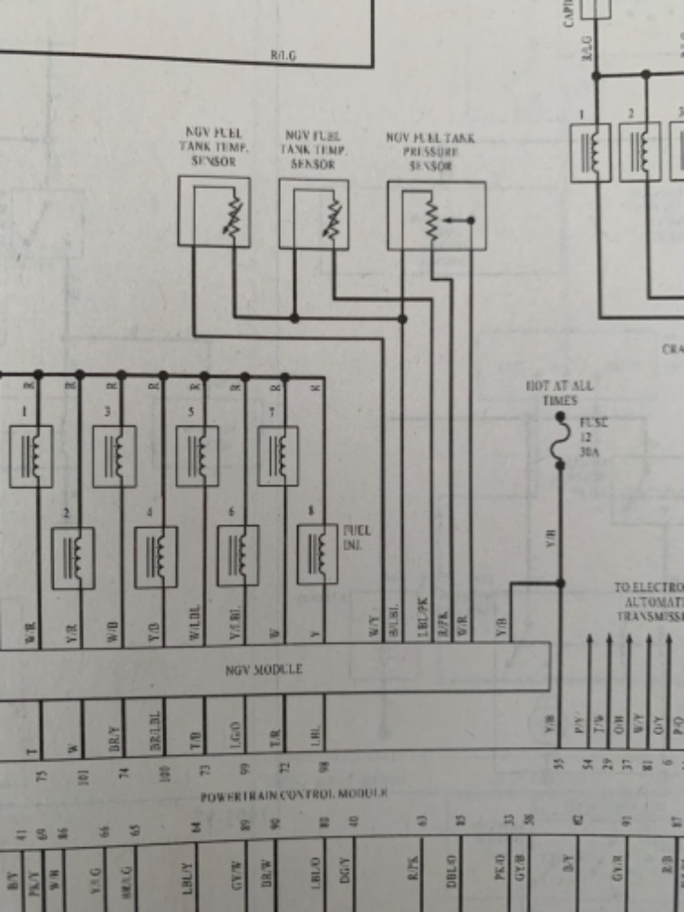

Looking at the wiring diagram that my friend purchased (haynes manual) this wiring diagram is kinda difficult to identify circuit design.
I'm still trying to locate this sensor, because I'm trying not to bring the gas tank down. So I haven't been able to test at the connector yet. I'm trying to upload the wiring diagram that I'm using. so Noah, Tutti, Tyler what's the best course of action. plus, I don't know whether the pressure sensor is on the tank or in the tank. I'm still trying to research that. thanks.

5 years 9 months ago #46269 by Tyler
I got it. :cheer: No worries.
At the FTP sensor, grey/red is the sensor ground, red/pink is signal, and brown/white is reference voltage.
The only location description I can find is, "On upper fuel tank assembly." Soooooooo, probably in one of the lines on top of the tank. :silly:

5 years 9 months ago #46277 by Mechanic 350
That’s not the wiring sequence I have Tyler. I’m going to try to upload this picture so you could see what I’m seeing

5 years 9 months ago #46286 by Mechanic 350
Hey, at your convenience, can show me a picture of that FTP sensor so that I can make sure that I have the right wiring sequence you mentioned because mine is totally different except the signal wire.
5 years 9 months ago - 5 years 9 months ago #46287 by Noah
The ftp is in line on the vapor hose on the top of the tank on the passengers side. ;) (Pretty sure passengers side)
I think the wires go through a grommet into the passengers compartment somewhere behind or under the back seat.

5 years 9 months ago - 5 years 9 months ago #46293 by Mechanic 350
Tyler, the wires that I have are the following:
Black/Light Blue = ?
Red/Pink = Signal
White/Red = (with the wiper) ? I thought that the wire with the wiper was the signal wire moving back and forth. Correct me if I'm wrong Tyler.
all 3 wires are going to the PCM.
