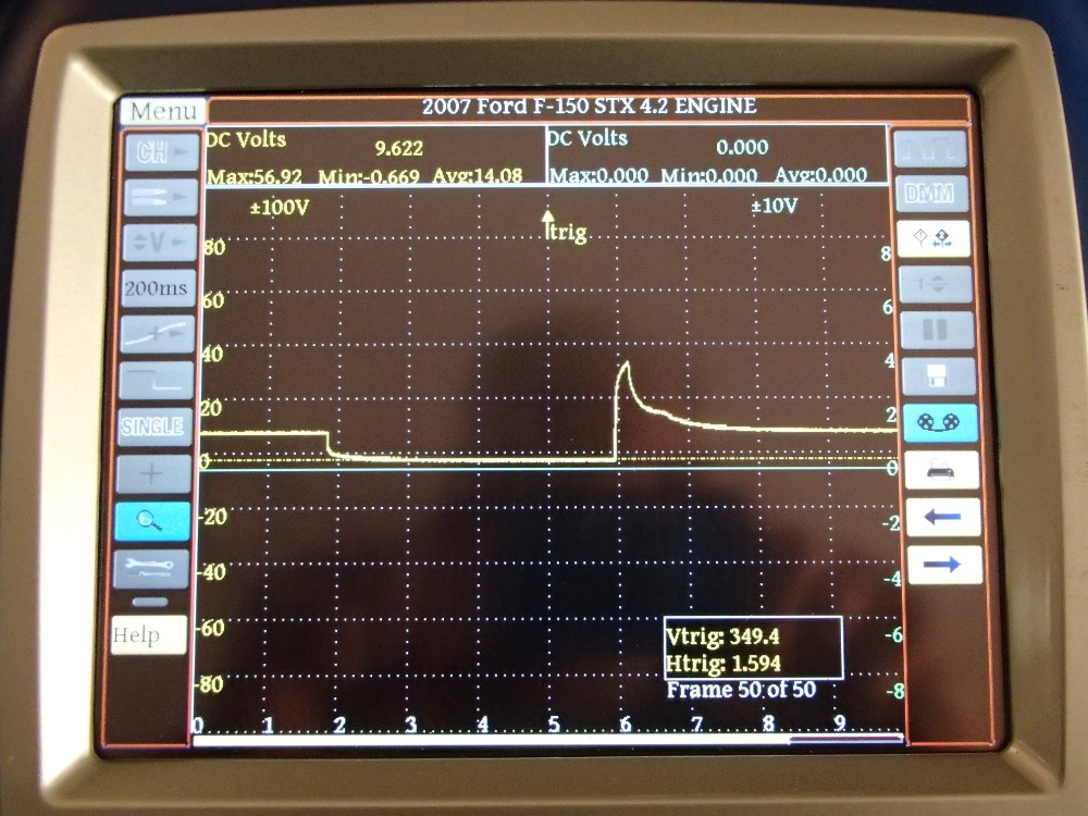

You, likely, won't see a clogged injector through injector waveforms. The mechanical movement may be present, but there might not be sufficient flow. To determine if an injector is clogged, do an injector balance test. Watch for the fuel pressure to drop, equally, for all injectors.

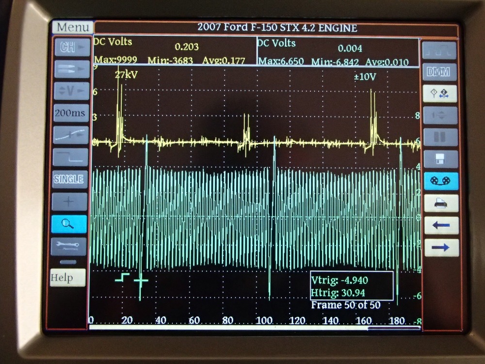

5 years 9 months ago - 5 years 9 months ago #46324 by cadman777
Chad,
Thanx for your detailed reply (including that excellent Tutorial link! I'm still foggy on reading the 'ramped' wave forms. Your overlay chart is superb!).
Answers:
O2S1 B1 & B2 both swithing btw .1-.72 according to spec
O2S2 B1 & B2 Sensors holding around .72
WOT & return to idle seems to be good too w/the correct delays and return to normal switching
STFT & LTFT: I recorded it, but for some reason it's not showing up in my 'Playback' list. Bummer! That means I gotta do it again. But Ineed to do the other 2 tests too: Tail Pipe Pressure and Frequency. If memory serves, both of the LTFTs were around -7, and both of the the STFTs were around +4.
From what Paul says in his book, I figured they're OK, b/c they're w/i the +/- 20 that Ford requires, but other than that, I have no idea except that one is lean and the other is rich. But then what else do I need to look at in combination to make sense out of these?
Was wondering about that w/the Injectors. Didn't know if I could tell if they were 'squirting' enough volume or what the pattern is. There's ONLY ONE Injector accessible to get a spray pattern and do a true volume test. To get to the others, you gotta remove the Intake Manifold! But I don't know if I can get that one off w/o first removing he fuel rail which means off comes the manifold, which ain't gonna happen until I figure out what's wrong w/this thing. So your suggestion of doing the PRESSURE DROP test. That's gonna be my next test.
There is no VVT on this engine, so that's eliminated.
I can't figure out how to get the Frequency on my scope like you show in your BLACK wave form? Any ideas?

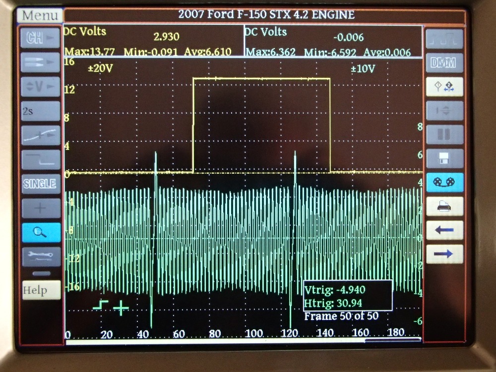

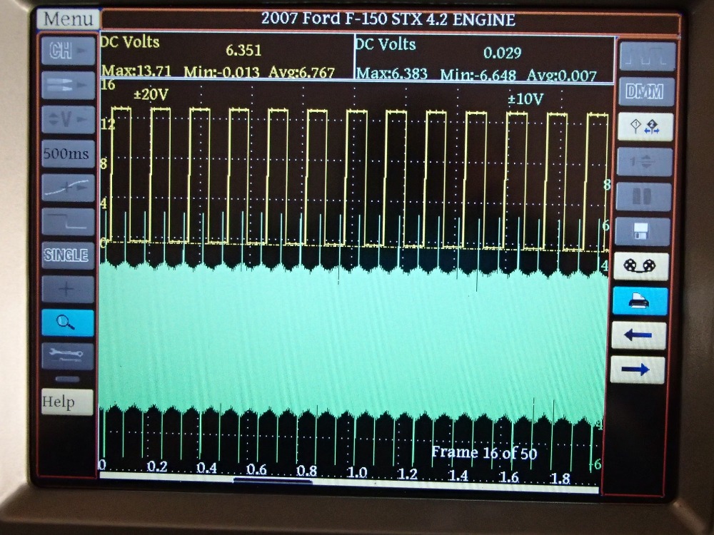

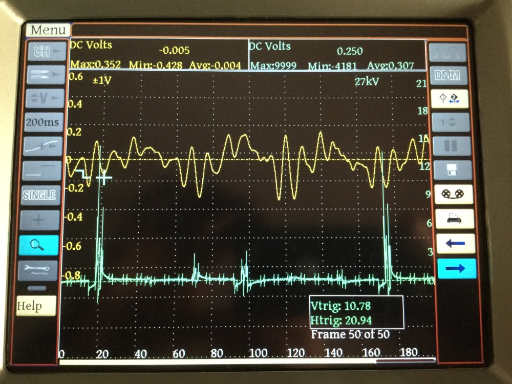

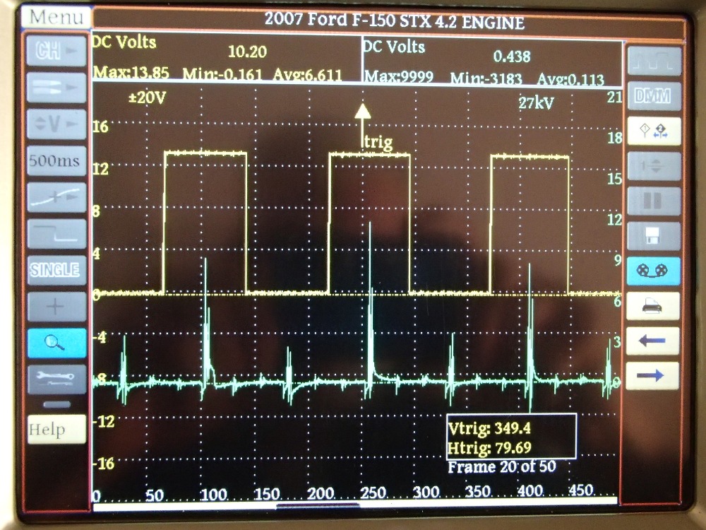

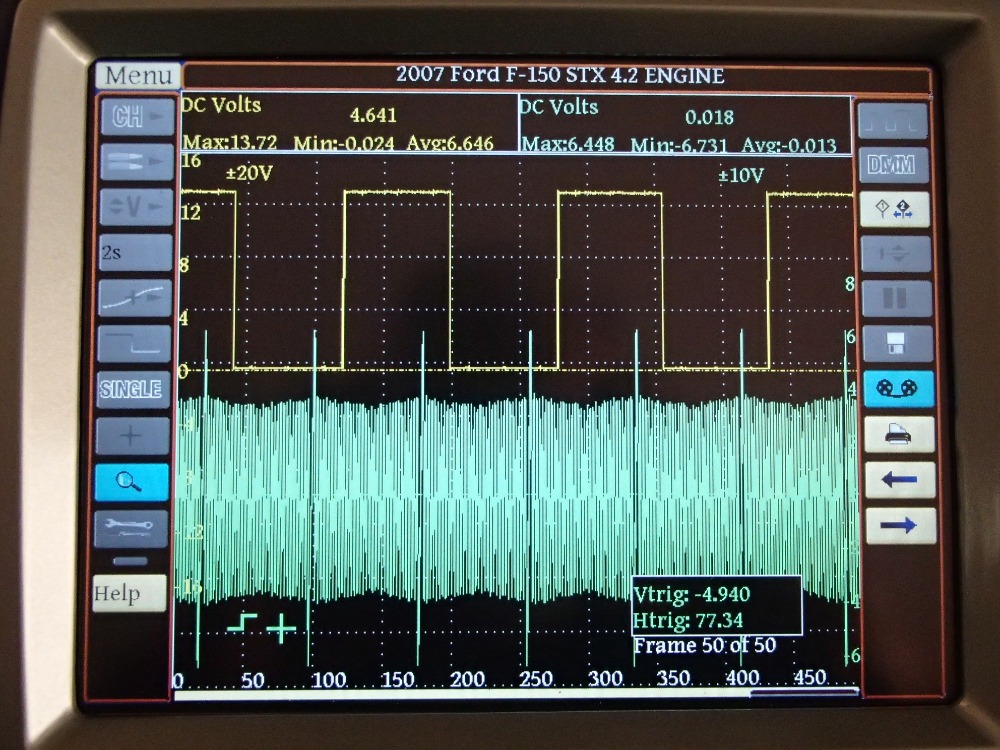

Here's some pics of some the WaveForms I got:
Typical Injector:
CKP & CMP
CKP & CMP
CKP & CMP
CKP & KV#1
CMP & KV#1

5 years 9 months ago #46329 by Matt T
cadman777 wrote: They were consistent, except with the CKP & CMP the CMP signal kept swapping rhythmically, and not sure if that's supposed to happen (Cam waveform consistently jumped to the left and then to the right of the Crank start point).
That's because the crank rotates twice as fast as the cam. CMP will repeat every two CKP syncs not every one.

OK, I get how you identify each cylinder on the Black trace.
But not sure how you identify each cylinder on the Blue trace.
Is it 140° past #1 (kV) marker on the 1-3-2-6-5-4-8 firing order?
Or is it something else?
Would you please post a link on how to read the Blue trace by firing order?
Thanx!

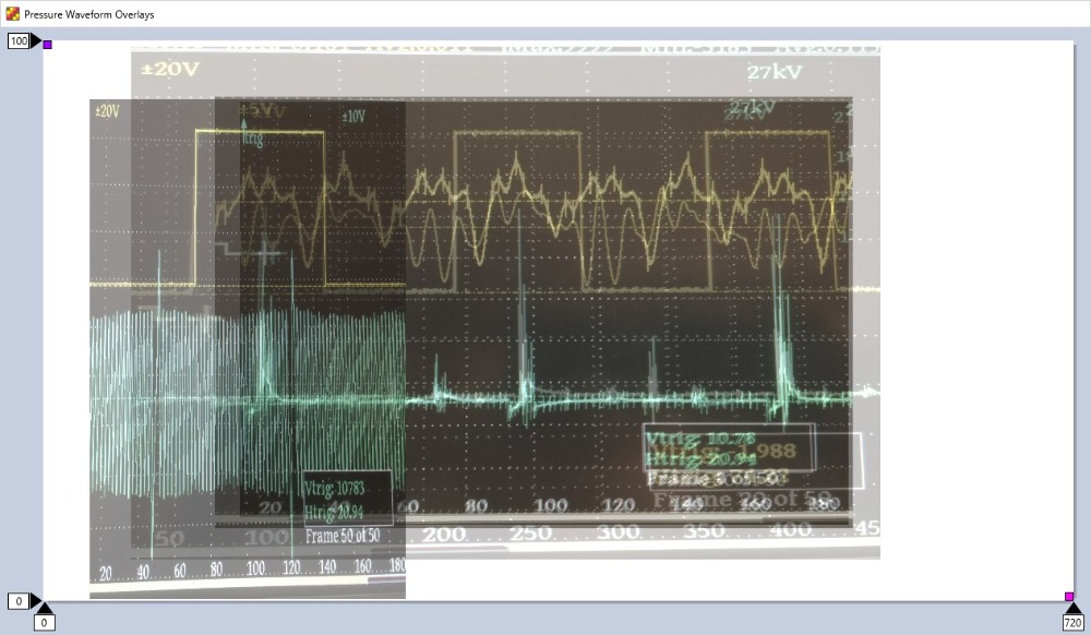

5 years 9 months ago #46454 by cadman777
OK, I get it now.
The idea that the exhaust waveform is for EXHAUST ONLY just didn't sink-into my thick skull.
So making these overlays is not big deal for me.
But do you do all this in Paint?
Or do you use another software?
Doesn't that mean you first have to save your waveform from Pico software (or whatever) to disk first?
If you save the image from Pico software, what file format do you save it in?
GIF, so you can make the background translucent?
Or do you just do a screen shot and then save it as GIF?
Just curious is all.
Probably save me all the R&D trying this and that and the other method...

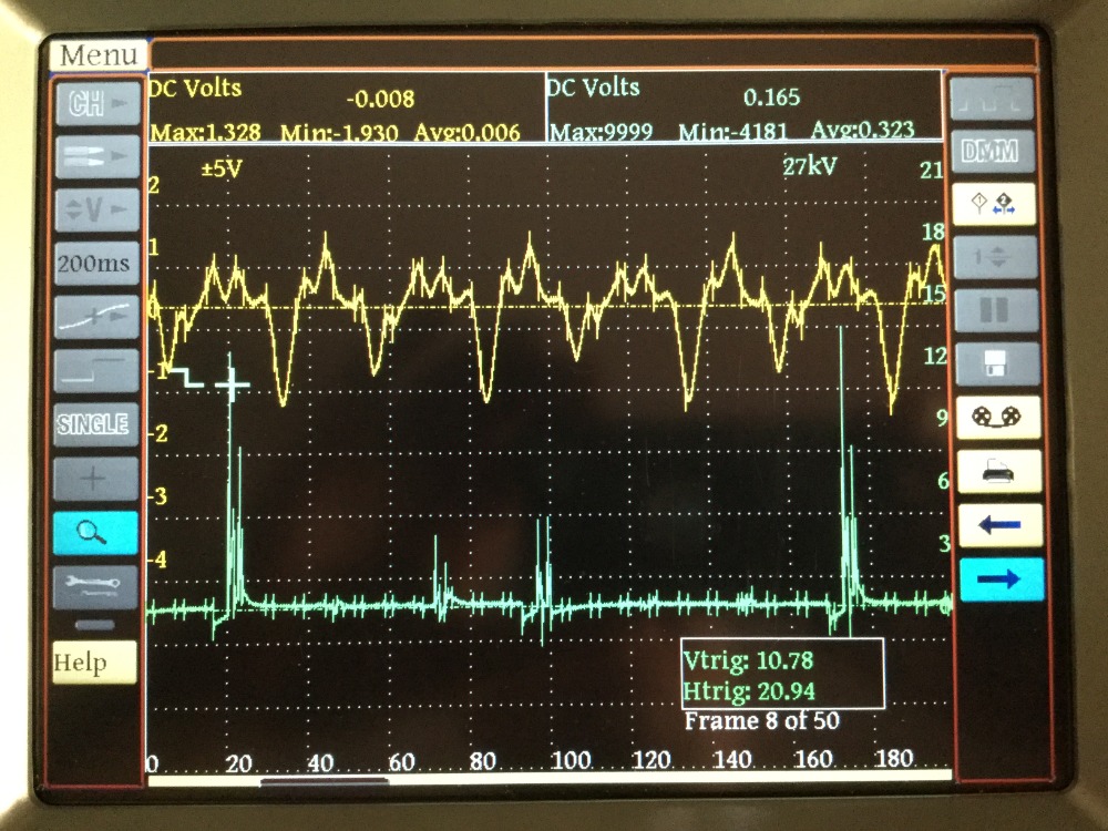

5 years 7 months ago - 5 years 7 months ago #47455 by cadman777
I'm back on this truck again.
Made a differential pressure sensor from a piezo disk taken out of an old CO sensor.
Worked like a charm!I scoped the Exhaust pressure and the Intake vacuum (disconnected the hose going to the break booster).
See scope screens below.
At this point I'm beside myself as to what makes this truck run rough.
It really doesn't feel like a misfire, but it does feel like the crank is imbalanced.
If anybody knows what I'm talking about, I'd appreciate any more ideas on how to diagnose this thing.
What I REALLY want is to get a Rotkee or USB Scope and get all the scope signals that are needed to check all the timing and other vitals on this engine.Is that even a real thing I can do?
Also wondering if I can use the scope to test for a broken crank or some other kind of physical damage, such as a stretched timing chain or something like that?
TIA...Chris
Exhaust
Vacuum
Overlay
Sorry for the mess.
It's all I had to work with.
(Yes, after all my whining, I finally sucked it up and put together a Win10 SSD for my laptop...)
