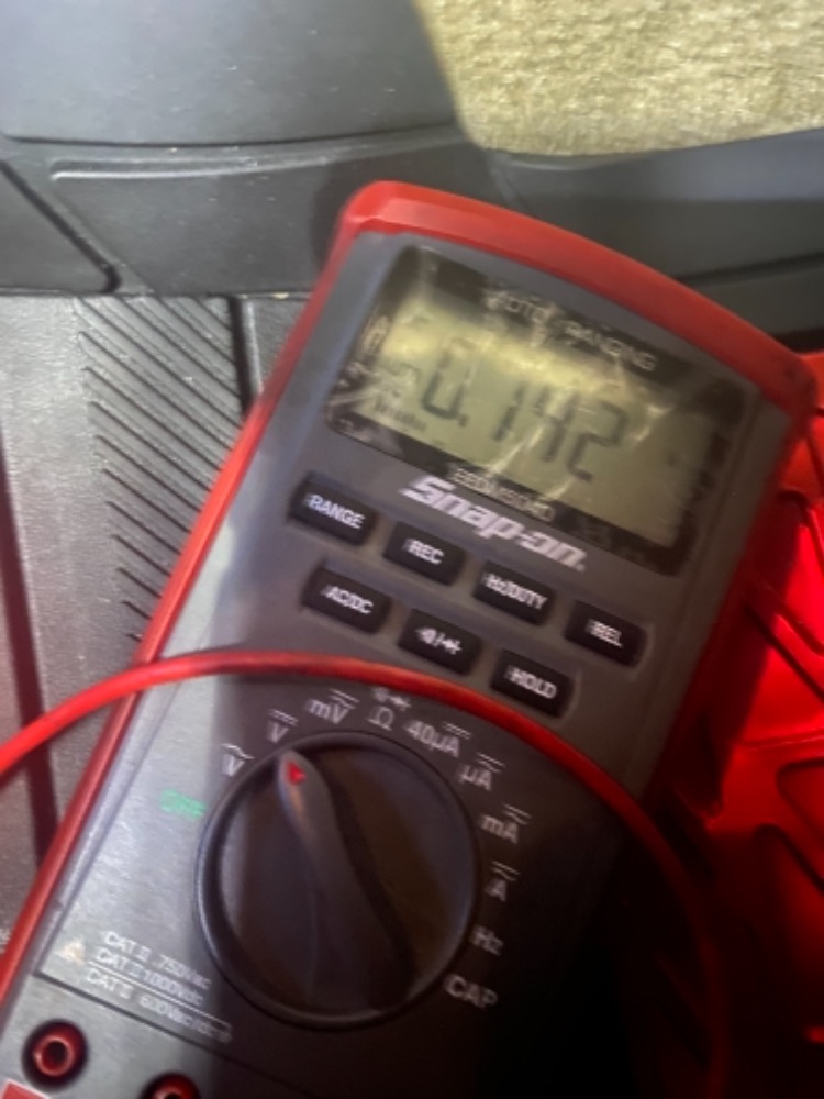

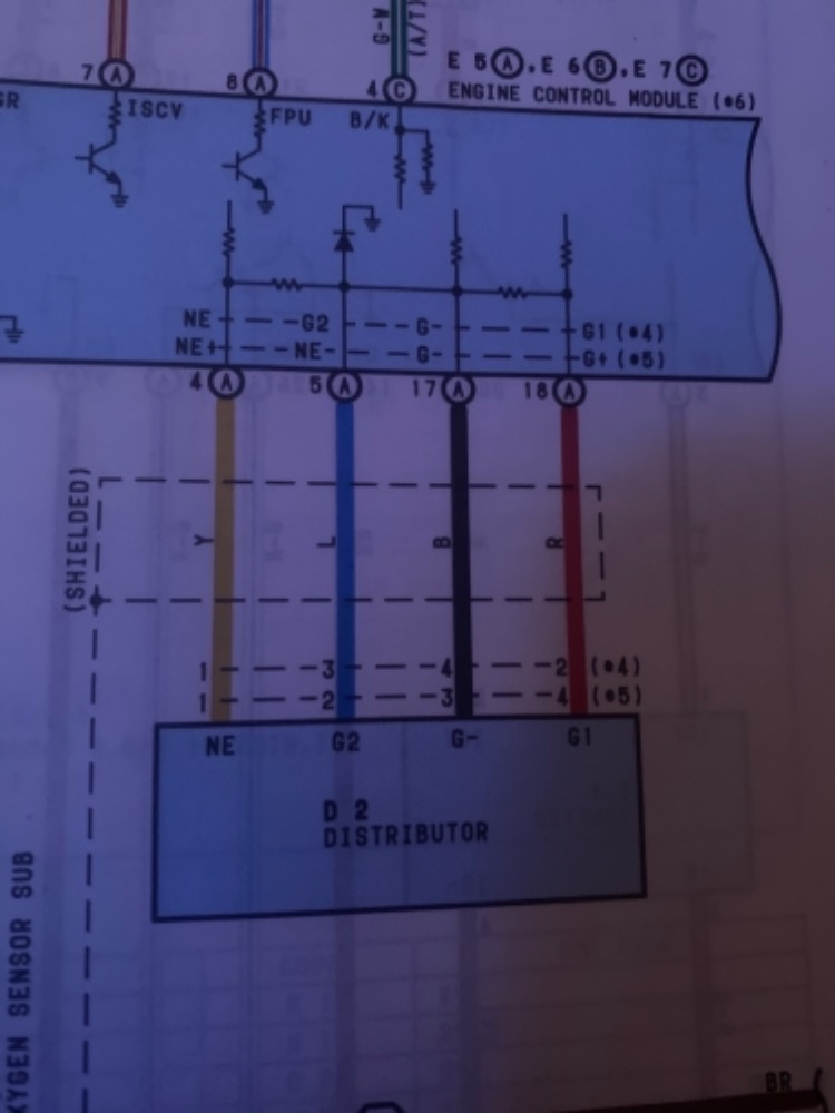

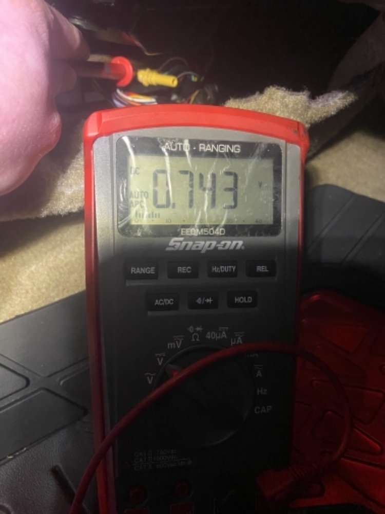

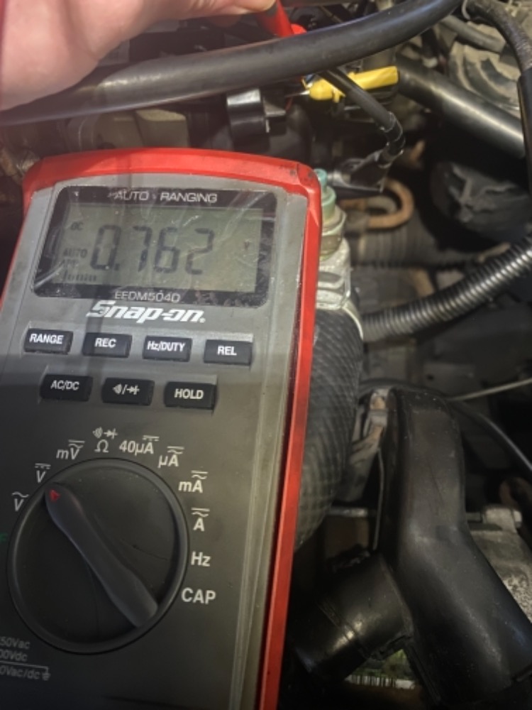

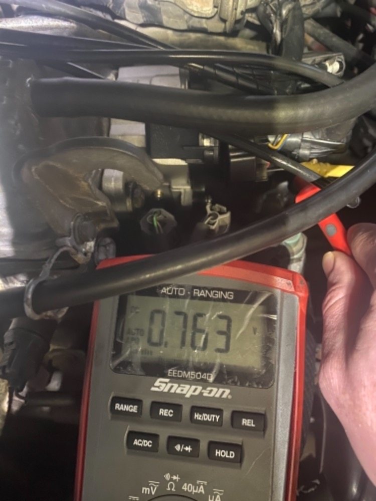

I have a 1994 Toyota Celica GT 2.2L 5sfe. It has a code 13 in it for a missing g or me signal. I got these readings at the computer and distributor with the connector plugged in and unplugged across of four pins. I had the key on engine off. It bogs out when you go to drive from a dead stop. I believe the right circuit design is shown below.
