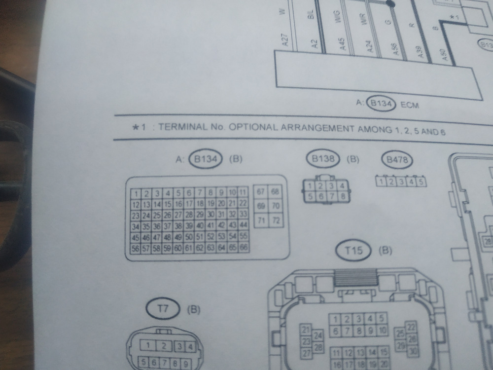

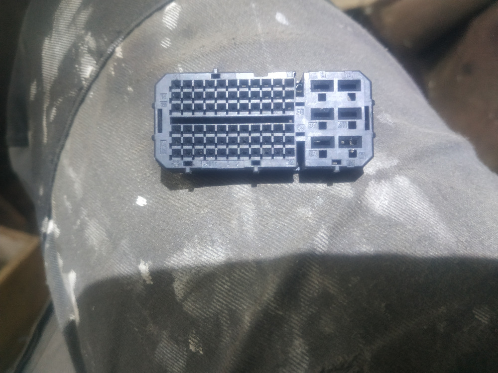

5 years 9 months ago - 5 years 9 months ago #46513 by GasPro
Hi! Thanks for reply. I Know about mitchel....I found diagrams from couple
source, but they did not match in some pins i thought it because it was from another subaru ,crosstrek....as i thought....than one good man send me diagrams from this Forester.
When i began to study all information ,i found out strange thing. It misleaded me in diagnostic.
I will post to fotos below. The foto of Pcm conector and foto of this conector in PDF diagram...
The pin location in Pcm conector on the car is different from PDF pcm pin location.
I thought its because my diagram is from another hardware pcm.Thats why i was looking for Correct diagram. But i was wrong. All Pdf are the same. PIN location on pcm connector match to pdf diagram only from 1 to 11 and futher it differs...
Never seen this before...
May be this info will help somone!
Thanks a lot For help!

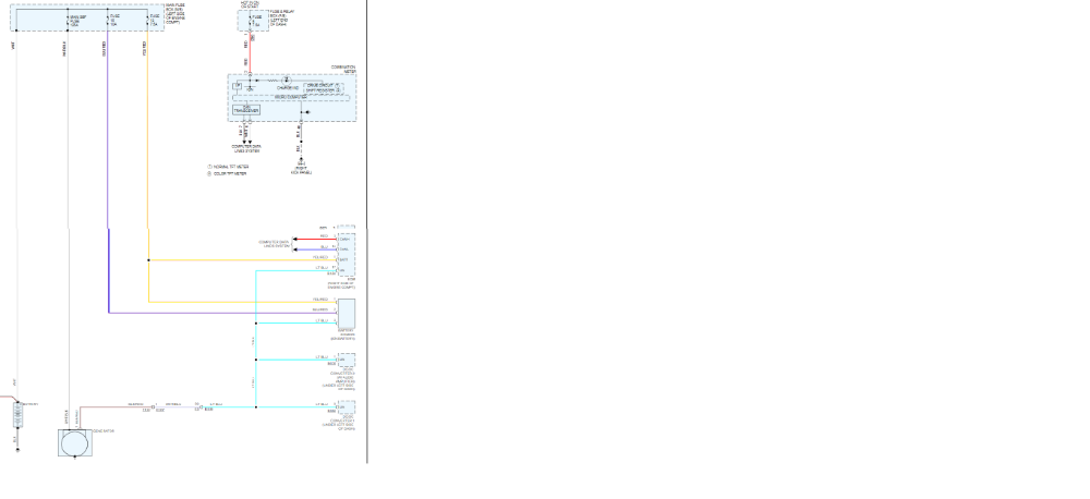

5 years 8 months ago #46751 by John Curtis
Starting and Charging System.
The following user(s) said Thank You: GasPro
