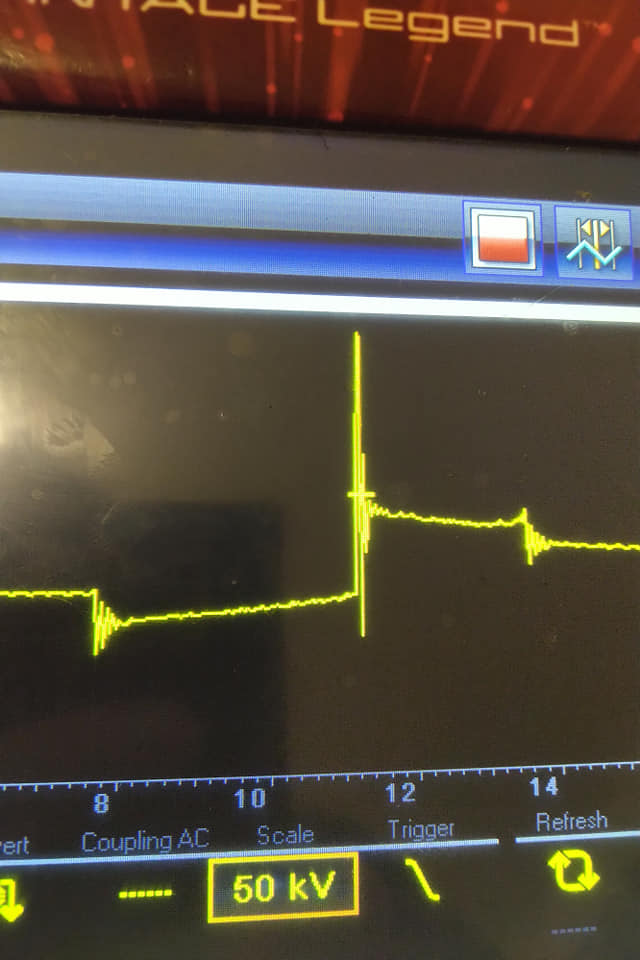

2017 Elantra 2.0L P0302
5 years 9 months ago #46450 by abvw
2017 Elantra 2.0L P0302 was created by abvw
2017 Hyundai Elantra 2.0L (Nu), 120000km
ECM logged P0301 a few weeks earlier, swap coil with cylinder 2, cleared codes, sent, got P0302 now. Checked misfire data and it shows 0 miss at cylinder 2 and 2-20 misses on cylinder 4.
Hole #1

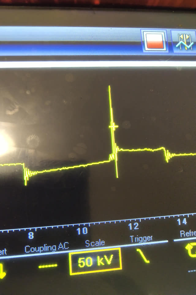

Hole #2

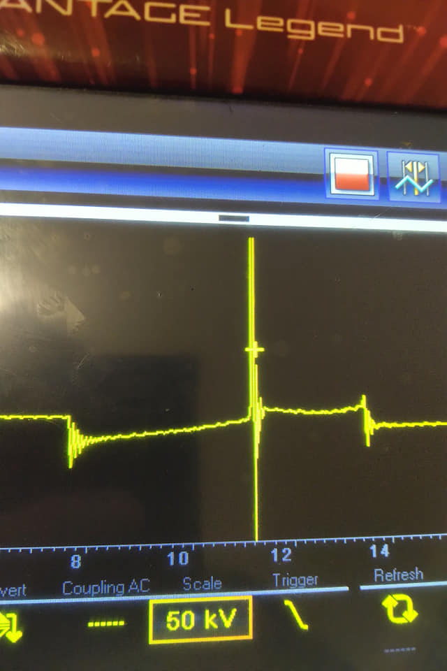

Hole #3

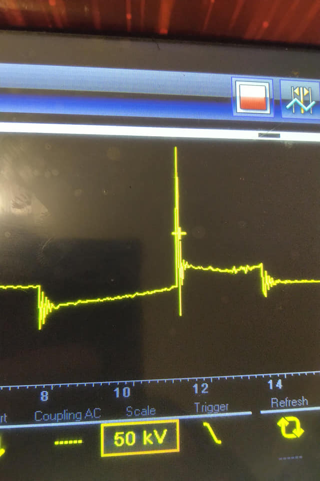

Hole #4
What is that oscillation at the end of dwell, before the spike for Hole #4??
