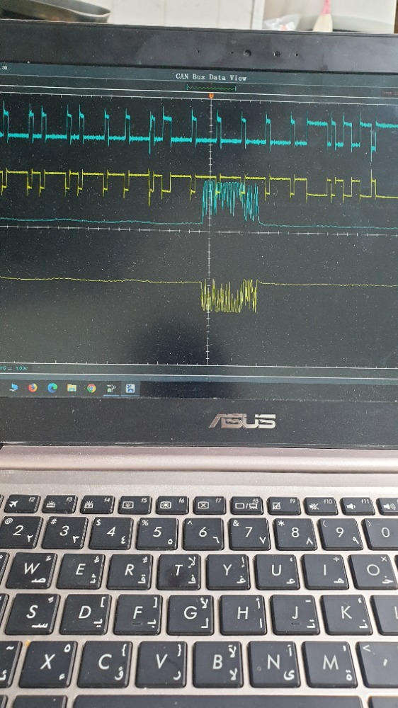

Waveform of can bus
- Batdrest
- Posts: 30
5 years 9 months ago - 5 years 9 months ago #46462
by Batdrest
Waveform of can bus was created by Batdrest
Last edit: 5 years 9 months ago by Batdrest.

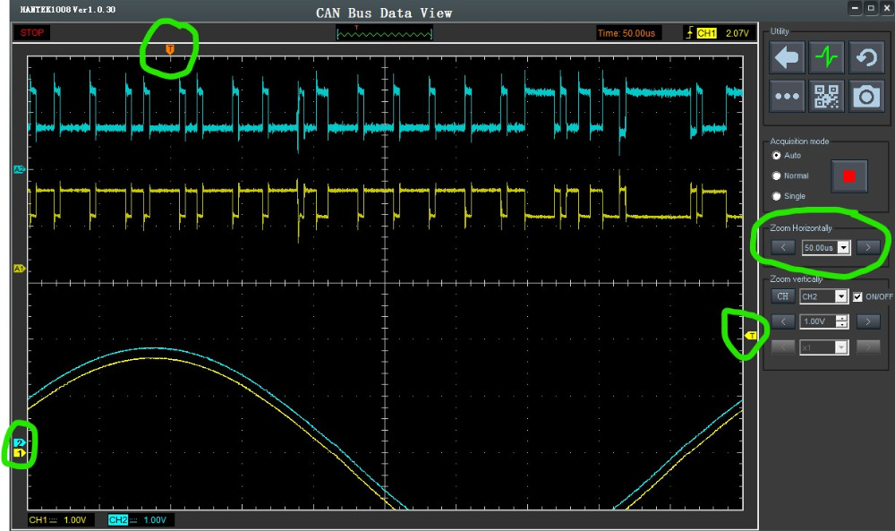

5 years 9 months ago #46484
Replied by Andy.MacFadyen on topic Waveform of can bus
What you are seeing is the limmitations of your scope
5 years 9 months ago #46485
Replied by Tyler on topic Waveform of can bus
That waveform doesn't look terrible. You're not seeing every little detail of the packets, but it's really not that important.
Any PATS codes stored? What happens when you try to enable Security Access?
