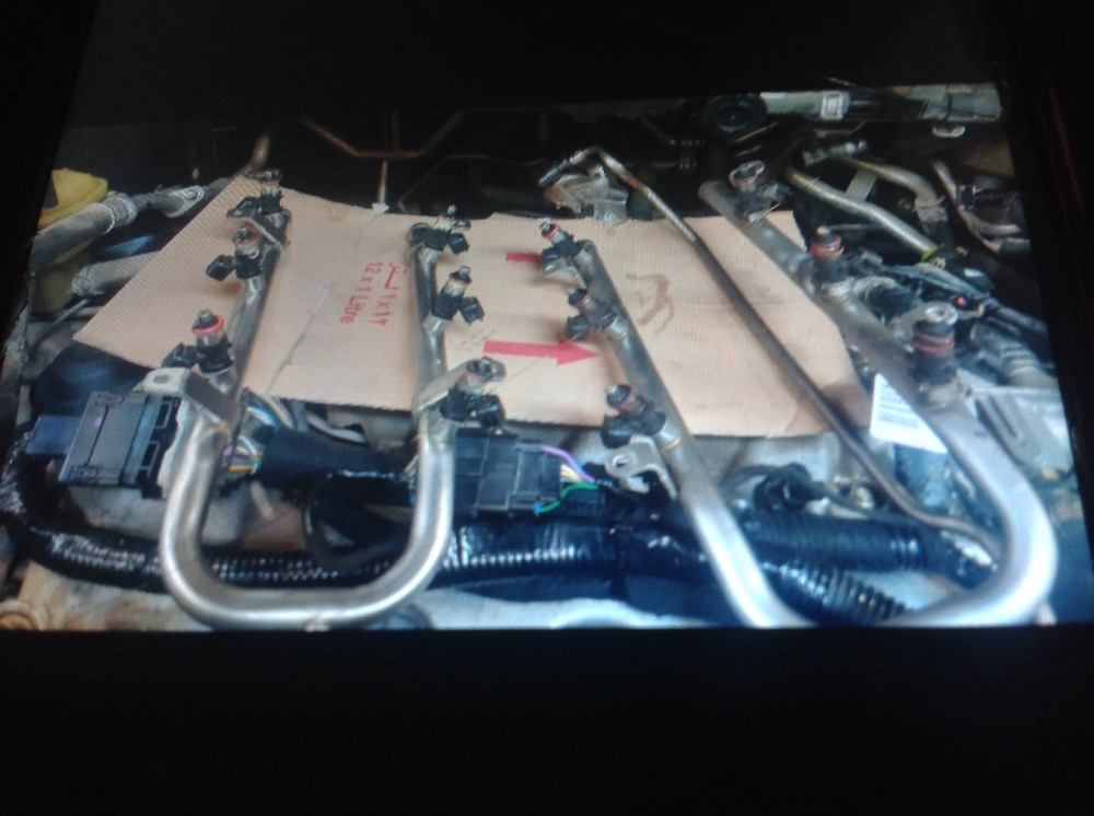

Hello Guys' How are you , Hope Everythings are ok , Im working with 2012 Mazda C-x9 That having a Fault code P219B which is Air fuel Ratio imbalance Bank 2 ,This Car came from another shop and the costumer told me that they replaced sparkplugs clean injectors, The car running fine no misfire at all , So i tried to look at the fault code and erased see if lights come again amd roadtest and light is on again .P219B . I read on the TSB that this fault code you can eliminate by making another line for the signal of 4 oxygen sensor. or on the other words you have to re wire from ECM to Oxygen sensor you can separate this line to the emission control . but idid not yet try it may some you guys encountered this fault code . I much appreciated, Thank you and Godbless

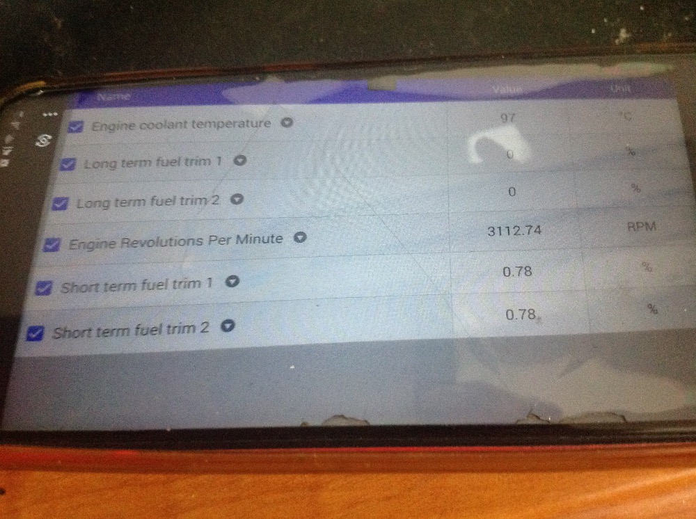

Hello my friend Here are some Fuel Trim Result

These are the result after I relocate the 3 injectors from left Bank 1 to Right injectors Bank 2 but im not sure if my Idea is good or not im not good or dont know how to read Fuel Trims thats why I put here so you guys understand what are those reading in Fuel Trims Thank you and Gobless

Awesome my frriend Thank you for helping me you said Fuel injectors after I transfer From I Bank 2 Injectors to Bank 1 The Fault code Would Changed tFrom P 219B TO P219A so it means that there is Problems on the injectors . Now I Tried 6 used injectors see if this code Fix ill give you update ,,THANK YOU and Godbless

Hello everyone ! Mazda is FIXED after i Transfer the 3 injectors right Bank 2 to Injectors Left bank 1 so the fault code is change from P219B to P219A SO thanks a lot ScannerDanner for giving me guide how to make this trouble even if im not familiar with those Fuel Trims The costumer is happy after I Fixed his car ..
5 years 8 months ago #46752
Replied by Tyler on topic 2012 Mazda C x9 v6 3.7
Nicely done.
There was definitely some fuel trim correction going on there, even if there wasn't a misfire present.
