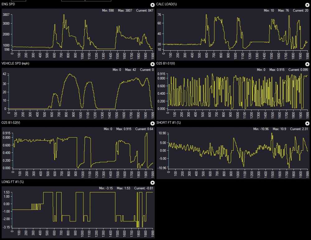

9 years 8 months ago #6178 by Tyler
Replied by Tyler on topic '03 Corolla P0171 Issue - UPDATE
69Camaro wrote: That is extremely helpful. I may take a "wait and see approach" here and see if the light comes back on, then check the freeze frame from that to see how it compares. Interesting thought on the O2, that definitely narrows the issues down. I don't see any issues with the injectors/MAF due to the testing and since the O2 looks good for now, I'll see if the issue comes back and if it shows more signs towards a vacuum leak issue.
So far it's been an interesting learning experience.
I think this is a good approach to take. B) It seems like multiple issues to me, but I could be wrong! Also, I dug up some known good scan data of the O2 behavior off my Scion, for comparison:
You can really see how the downstream O2 kinda 'creeps' back up off of lean at times, as you saw on your Corolla.

9 years 8 months ago #6221 by Tyler
69Camaro wrote: This is very similar to what I saw on the downstream O2. Is there a reason the downstream acting differently vs. normal switching on the upstream (maybe a video you can point me to help explain, if not no big deal)? The other thing I saw was normal square waves but cut in half, meaning the bottom end of the square wave was like .400mV and then peak was around .700mV. In the meantime have gone back to Paul Danner's book and I'm re-watching a lot of his videos on ST/LT FT's and O2 to refine some of my learning.
Thank you for all your help, I'll post something if the problem reoccurs.
No problem! Happy to help further if this one comes back your way. :)
The downstream acts that way due to the catalyst and it's oxygen storage capacity. This video explains some about oxygen storage testing, if you haven't seen it already:
Were your 400mV and 700mV readings noted on scan data only? That can happen sometimes due to a slow data rate problem. Not with your equipment, necessarily, some vehicles just don't have a very fast data rate. Testing at the O2 directly would be needed to confirm this.
