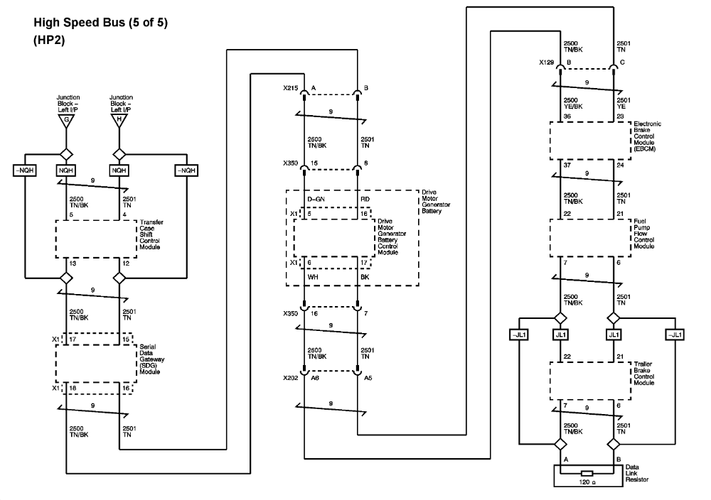

5 years 8 months ago #46575 by cjames22
If there are faults on the EBCM ~ DTC's
will programming TBCM be inhibited showing no communication with TBCM when dealer tries to program module.
the dealer stated that it must be a wiring issue.
Powers and Grounds on TBCM, Good
5VRef, good
Data lines high and low. good wave. Mirror imaged.
there are no comm codes on any module
scan data shows TBCM data, but when dealer tries programming *no communication* happens.
needing to replace EBCM on a 2011 chev 1500 and 2012 chev 1500. both needing TBCM Programming.
EBCM Also needs to be programmed by dealer.
In a module needing to be replaced is there any inhibits in communication for programming.
also for a 2012 that needs a new EBCM, will the brake lights remain illuminated for the duration of key on running or not?
5 years 8 months ago #46578 by Cheryl
Replied by Cheryl on topic chevy TBCM - EBCM programming. 2011 - 2012
Do you have 60 ohms between data link connector pins 6 and 14?? Also do powers and grounds light a test light?? Or you front probing the connector with a multi meter??

5 years 8 months ago #46593 by Cheryl
You might have to unplug one module at a time. Jump the data lines in and out to eliminate one module at a time until the issue goes away. Do you have 60 ohms at the dlc??

5 years 8 months ago #46597 by Cheryl
Be nice if ya could do j2534

5 years 8 months ago #46600 by Cheryl
They might of tried programming the fpcm and it does no communication. Is this a dorman replacement tbcm??
