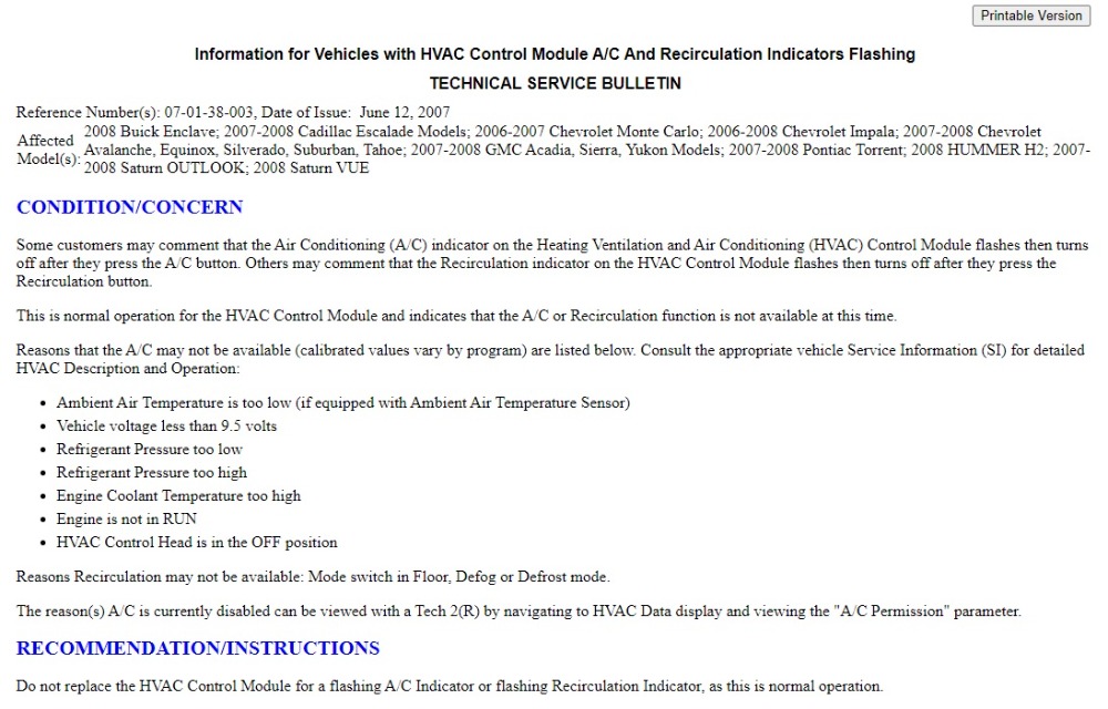

5 years 8 months ago #46629
Replied by Tyler on topic 2007 Escalade ESV AC snowflake blinks.
Check the A/C pressure sensor reading in the PCM. If it's near zero, that'd be why the light flashes. :lol: Find out where the refrigerant went.
You can also check the A/C Disable history in the PCM. Should store the last eight reasons it disabled the A/C.

5 years 8 months ago #46635
by RJMARRA
Replied by RJMARRA on topic 2007 Escalade ESV AC snowflake blinks.
I Found & attached a TSB on this issue.
