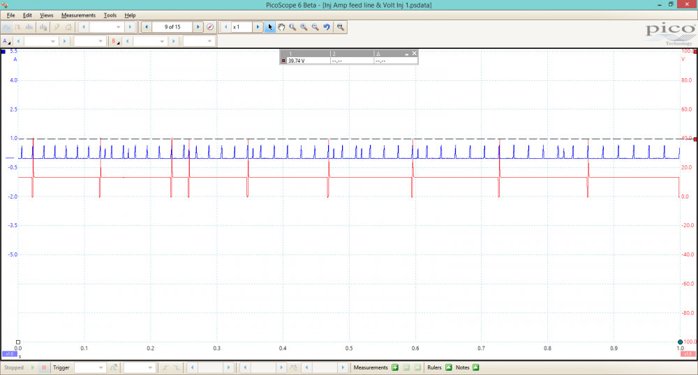

So, onto my scope question, I have included a trace of Injector current from the feed line and Injector 1 control wire voltage.
It appears that there are additional injector firings when i don't believe there should be.
Engine firing order is 1, 6, 3, 5, 2, 4.
Looking at the attached, you can see the blue trace (Inj current), you can see the smaller current draws between the higher ones, included in this image is the red trace, Injector 1 control wire, you can see where the current draw occurs just after firing the injector appears to fire twice.
Is this normal? PS, I have monitored Injector 2 also and see the same pattern on occasion.

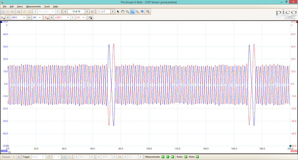

I have scoped the CMP and CKP sensors, all appears normal with them as far as i could tell. Unsure if im on the right track, but thinking if the injectors were being commanded to fire by the PCM that i may be able to see something wrong with one of these sensor waveforms.

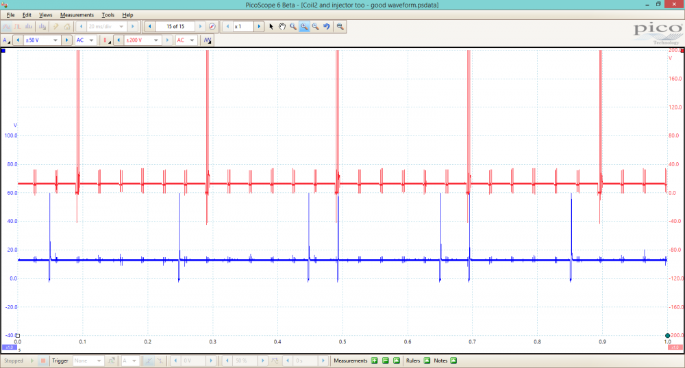

Last night while looking through the waveforms i have taken, i come across the below.
Red trace is injector 1 voltage and blue trace is Coil feed amps.
There are a few additional injector fires here, worth mentioning they are the same through the whole trace, coincidence, or not im unsure.
But if reading the firing correctly, Inj 1 fires, followed by Coil 1, next Injector 6 would fire (which we cant see obviously as its not included), but when Coil 6 fires, either an injector (or in this case as shown) injector 1 has been fired again.
Wondering...if i were too scope say Injector 2 with Coil amps that i may see a similar pattern where the injector is firing exactly when another cylinders Coil is.

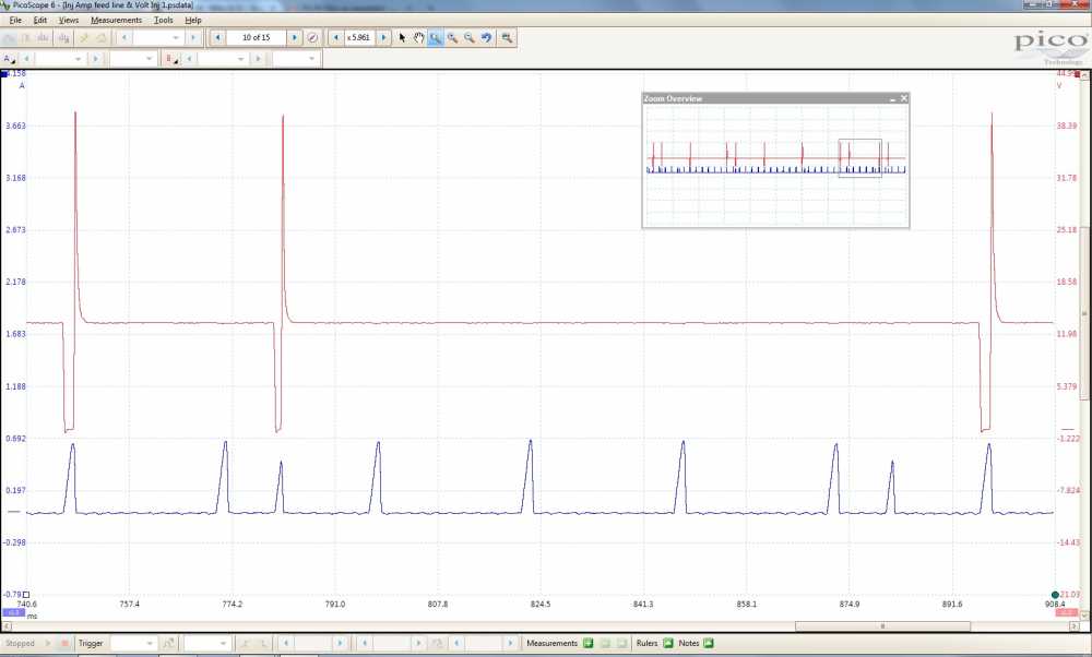

9 years 8 months ago #6179 by Tyler
Replied by Tyler on topic Ford FG F6 - Miss
Got your capture, sir, thank you very much! This capture is B-A-N-A-N-A-S. :lol:
A quick screenshot for anyone following along:
The random injector ramps show up in between all the 'normal' ramps at various times, but seem to most commonly show up between the #6 and #3 injector firings, and the #4 and #1. :huh:
We don't get the turbo 4.0L here in the States, so help me out - Is this a waste spark system? COP? Also, where are the CKP and CMP's located on this engine?
That coil capture is excellent, BTW. B) The fact that we don't see any random coil firings suggests to me that the CKP is working perfectly, and that our problem may lie with the CMP? That's my theory right now, anyway. :lol:

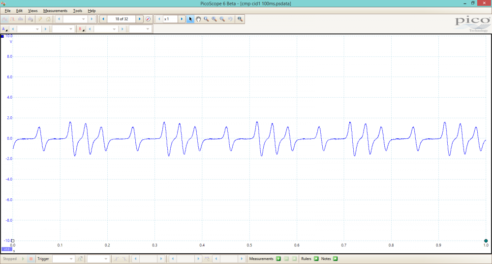

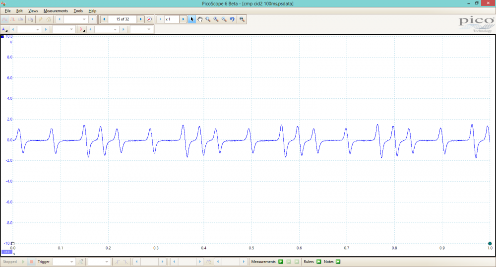

I was thinking possibly CMP also, looking at the waveform, nothing stood out to me, but im not an expert.
See included Intake & Exhaust CMP's.

Yep thats intake and exhaust cam sensors.
Below is the ckp sensor (main and sub), looks ok to me, but im not sure on the voltage.

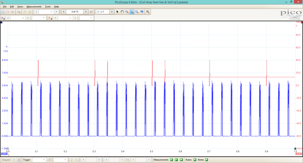

The first one is the amp clamp on the injector supply wire using a fuse breakout , this shows all the 6 injectors, the 2nd channel is hooked up to the pcm control wire for injector 1 only. These are ground side switched by the pcm

While the injector firing seems to be random, from what i can tell the correlating COIL firing appears to show a pattern.
So just to note, all injectors do appear to fire a second time, but thus far this appears random, although does show on more injectors than others.
As an example, i believe i included one of the scope pics which showed Injector X fired the second time at the same point that Coil X seemed to fire.
After scoping each coil and Injector, below is what it looks like.
Engine firing order is 1-6-3-5-2-4
Secondary Inj firing:: 2-4-1-6-3-5
Hopefully i have explained the above well enough.
So when the additional injector firing occurs on say Injector 5, it always occurs when coil 6 is firing.
Again, when the additional injector firing occurs on say Injector 1, it always occurs when coil 2 is firing.
Welcome any thoughts, as you can see this all appears too well timed.
