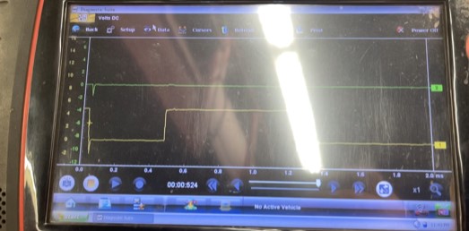

Really need help finding a misfire f150 ecoboost 2015

5 years 8 months ago #46937
Replied by Tyler on topic Really need help finding a misfire f150 ecoboost 2015
I couldn't make the video link work.
I suck at this.
Anyway, that looked like a clean coil control signal to me. Unfortunately, with this design of coil, the control signal won't actually tell you all that much about what's going on with the coil or what's going on inside the cylinder.
I'd still suggest the relative compression and injector balance test in either the IDS/FJDS or the Snap-On. Both will do the tests.

You have to be signed in to google account and then try it or if some one didn’t mind I could send the video over if that’s okay

Don't worry too much about getting the video up. Give those two tests a try that were mentioned a few times earlier with your scantool.
