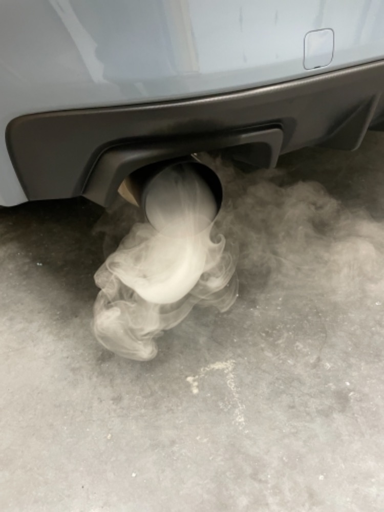

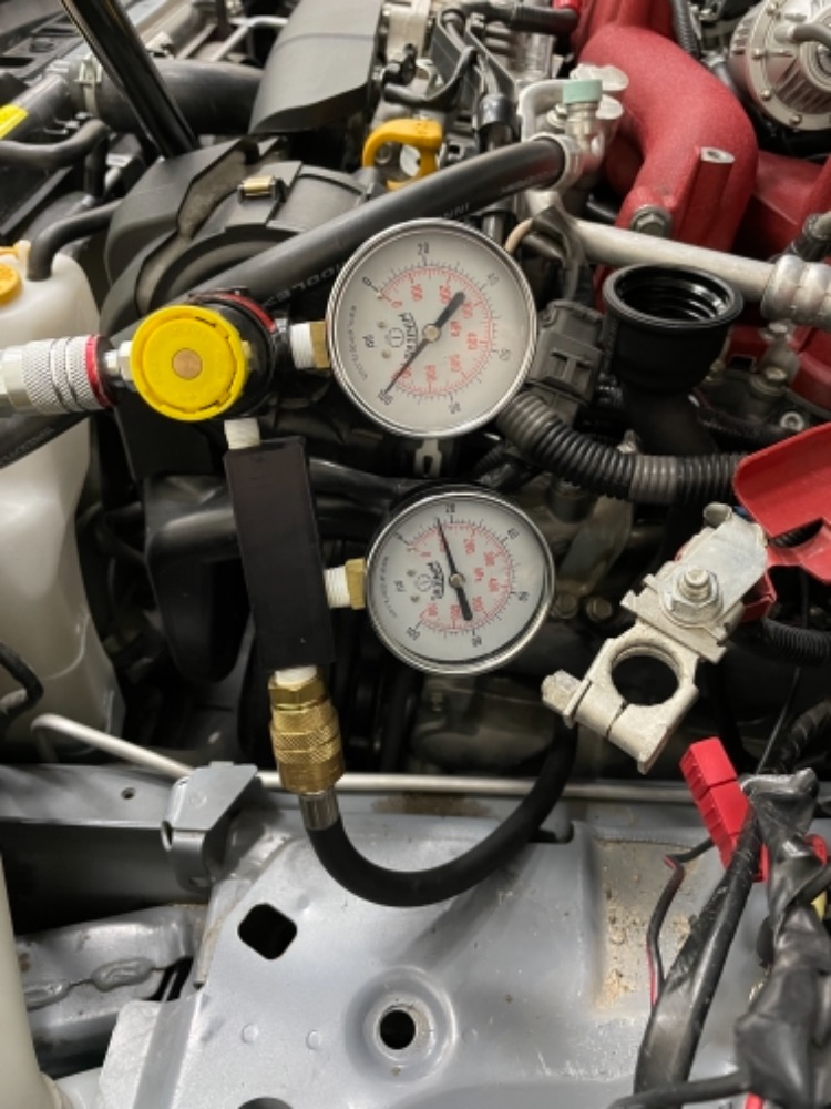

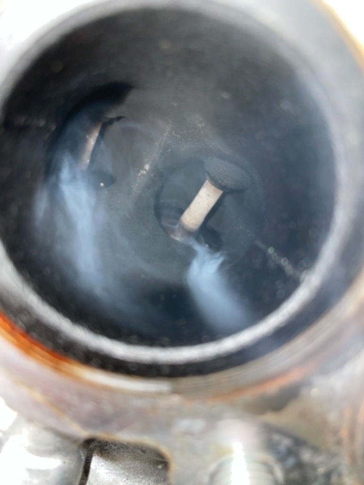

Take this with a grain of salt, but with the combustion process, it would use some of that O2 and convert it to other gasses, so a set or multiple sets of leaking exhaust valves could in theory do this as it’s not completing the combustion process.
I’m currently working on a 2019 Subaru sti with a hunting idle that leads to a stall(no codes) that I found to have low compression in cylinder 2. Leak down showed about 80+% leak out of the exhaust valves, and currently the owner is trying to decide how far he wants the fix to go, as in heads off refresh or just sell it. But the exhaust valve lash on that hole are certainly too tight(common on subarus).
Now I should mention this car is fairly modified with larger injectors, turbo etc so my data would not be super useful to you, but I’m happy to help in anyway I can :)

Leak down test is easier ;)
Since the compression is bank specific valve timing is another possibility.
