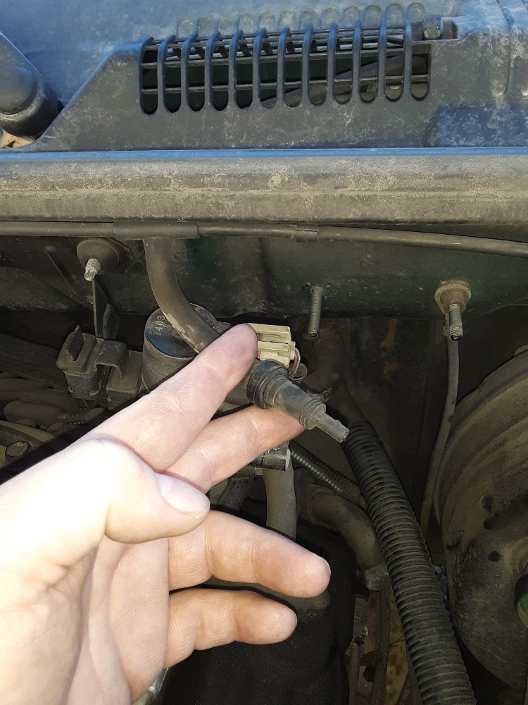

Found it I believe! Just not sure where it comes in through the firewall from the engine and cab sides.
5 years 8 months ago #47154 by Matt T
Replied by Matt T on topic 99 Durango no heat and no zone control
Looks like you're on the right track. Neither of the following links are super helpful but might help you figure out what that line connects to.

Thank you! Found the hose entering the firewall and the tiny piece of plastic hose sticking out! Was able to bridge the two ends with a piece of rubber hose. The zone control works now!
