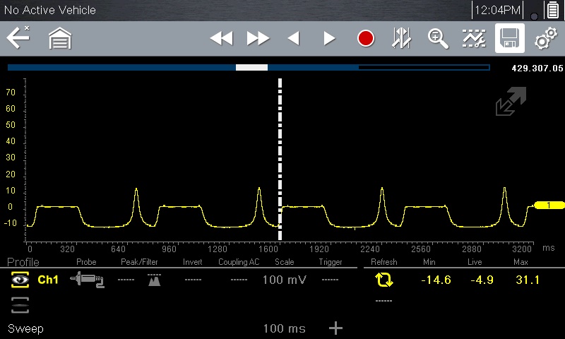

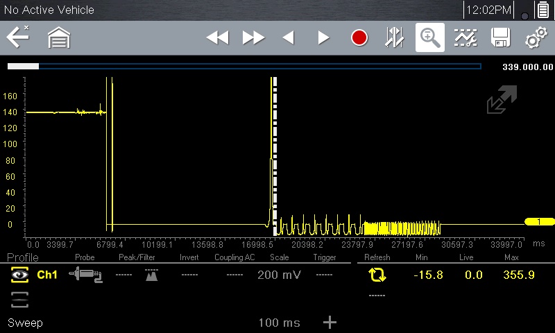

This L83 will start to misfire on #7 during a WOT run, and continue to misfire for 30-60 seconds afterwards, at which point #7 starts contributing again. No, the injector is not getting shut off. Ignition waveform during the misfire shows a very low firing line, suggesting low compression. An audible relative compression with no miss present sounds perfect. Same test with the miss present has a distinct problem.
After awhile, I get the timing right and pull into my bay with the miss present. Because of the intermittent nature of the problem, I don't believe I have time to remove the valve cover to see which rocker isn't moving. The problem will have gone away by then. But I feel like I can get a plug out and the PV350 installed.
Here's a clear flood crank, followed by running at idle. 1mV = 1 PSI:
Here's a closer view of the cranking pressures:
At this point, I feel confident there's an AFM problem. Very likely an intake lifter that's intermittently collapsing. BUT, I also wonder about a failing VLOM , causing both valves to stick closed. I've never seen it, but the intermittent nature of the problem has me worried.
My question to the brain trust is: Do I have enough evidence here to confidently say ONLY the intake valve is stuck closed during this capture? And therefore that the cylinder heads are coming off. My understanding is that, if both valves were stuck closed, I'd be seeing two (low) compression events. One like normal and one in the exhaust section. The fact that the exhaust section is going to atmospheric suggests that the exhaust valve did indeed open.

Tyler wrote: Do I have enough evidence here to confidently say ONLY the intake valve is stuck closed during this capture? And therefore that the cylinder heads are coming off.
I'd say you called it right. You can, clearly, see a defined pressure change in the "expansion pocket", before the cylinder reaches BDC, indicating EVO.
I believe, you are right on the money, here, too. If BOTH valves were stuck shut, there would be no distinguishing between compression and exhaust strokes. Or, expansion and intake strokes.

Tyler wrote: My understanding is that, if both valves were stuck closed, I'd be seeing two (low) compression events. One like normal and one in the exhaust section. The fact that the exhaust section is going to atmospheric suggests that the exhaust valve did indeed open.
Agreed on seeing some compression at the end of the exhaust stroke. But what really makes me confident the exhaust valve is opening is the sharp rise to atmospheric which appears to be occurring before power stroke BDC. I doubt leakage past the rings could cause that.

Chad wrote: I'd say you called it right. You can, clearly, see a defined pressure change in the "expansion pocket", before the cylinder reaches BDC, indicating EVO.
Duh. :silly: I dunno why I didn't realize that sooner. Even if the pressure during the exhaust stroke was elevated, EVO is still clearly taking place. Thanks guys. B)

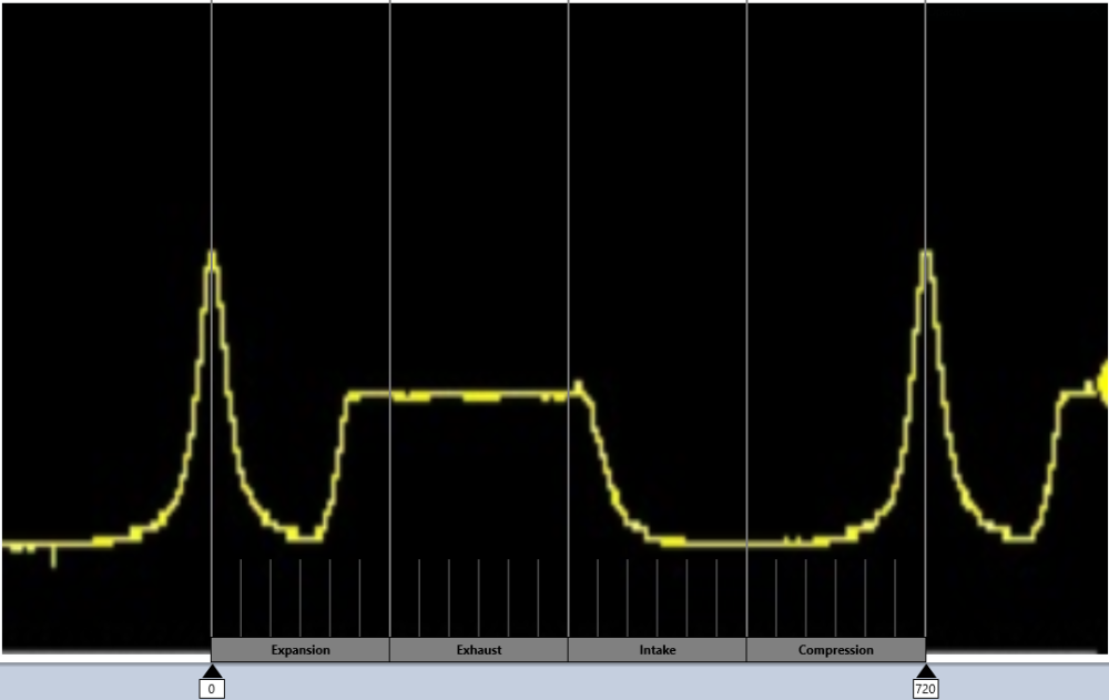

While we're talking valve events, I also noticed after posting this thread that there is no real IVO after TDC-E.

That looks just like the captures I have from some hemis with stuck closed intake valves. Looks like you nailed it to me.
Considering it's intermittent it's probably not a (completely) wiped cam lobe.

One more thing I would like to throw out there for anyone just learning in-cylinder waveforms. Since this thread has a stuck closed intake valve problem, I though I would post a waveform of a NORMAL/GOOD cranking in-cylinder waveform.
In a cranking in-cylinder waveform, the intake stroke event is, usually, not very defined. The slow speed of the crankshaft does not draw the piston down fast enough to create much, if any, vacuum. The result is a, near, flat-line between the expansion pocket and the compression stroke. Many people, mistakenly, think the intake valve didn't open because they see no defined intake event. Tyler's waveform proves that the opposite is true. If the intake valve doesn't open, the in-take vacuum in-cylinder will be DEEP, and round.
The fact that Tyler's cranking waveform has a very defined intake vacuum that exceedes the limit of the Scope/Transducer is a quick/clear indicator of no IVO.
Last edit: 5 years 8 months ago by Chad.
