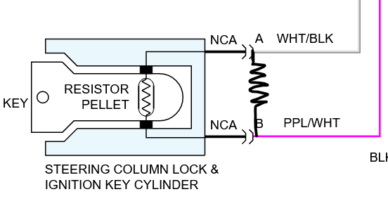

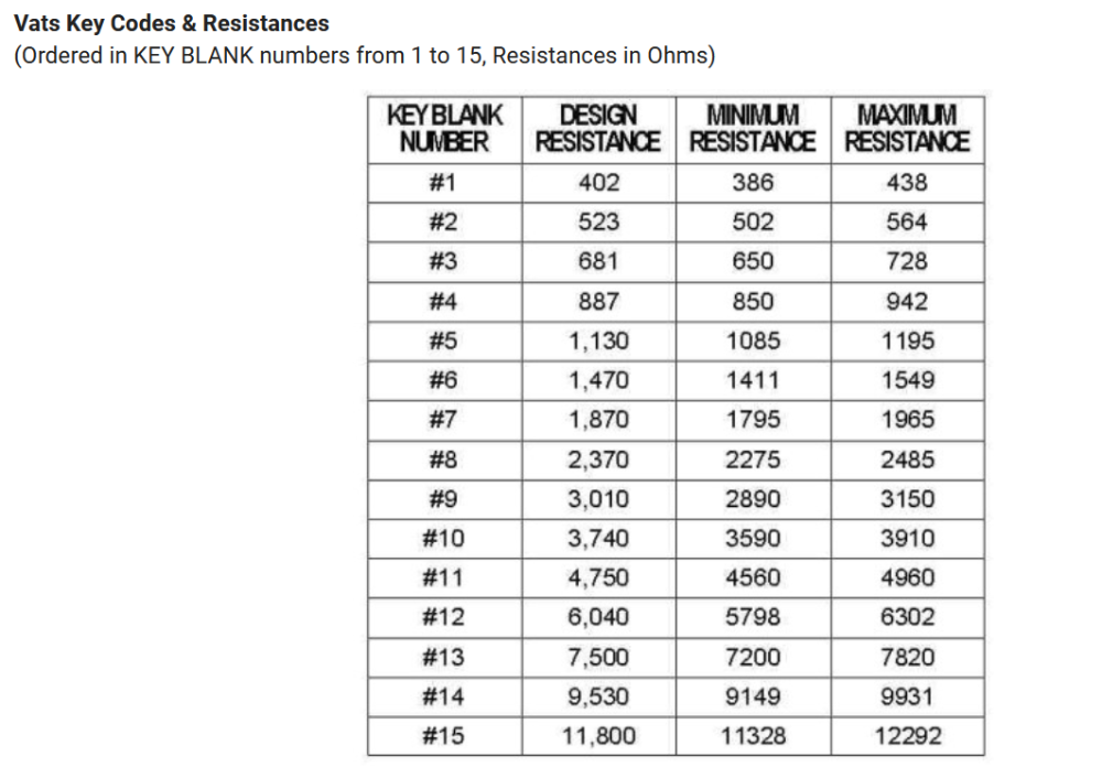

The ebay item id given is invalid, no result has been sentI am not an expert, but what I understood is you can bypass the system with a resistor, but you would need the original key, so that you could measure the resistance and get the correct resistor...
you could probably wire each of these in until you find the one that lets your car start. Probably cheaper and easier than buying and having 15 keys cut

It won't let me post an eBay link but if you search
DEI 652T GM VATS Key Bypass Resistor Kit Pack of 15 GM Multi Ohm Resistors
you will find what I am talking about

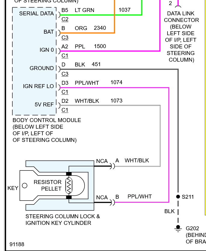

So I cut purple and white wire and solder the correct resistor in.
- Posts: 2223
5 years 8 months ago #47158
Replied by Chad on topic Ignition key on 1997 buick century
Cut the PPL/WHT wire and the WHT/BLK wire. Solder the resistor between PPL/WHT wire and the WHT/BLK wire.

I just got around to the buick.am I right I saw two tiny white wires in a black cover they were in coming down the column. Are these the two wires that change I to the purple/white wire and the white/ black striped wires.
