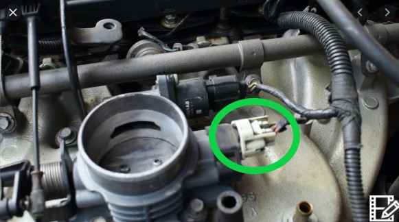

Hey Apav84! First we need some basic information from you. What kind of test equipment do you have available? Multimeter, test light? What scan tool do you have, specifically?
With the 'NO BUS' message, I believe your next easiest test is to check a 5V reference circuit under the hood. The TPS is right on the throttle body, easy to access once you have the intake tube off.
Unplug the TPS, connect a multimeter to the battery negative post, turn the key on, and measure for voltage at all three pins. Note the wire colors and what voltage you found on each wire. Do not stuff the multimeter probe into the connector pins.
Please take the above readings and report back with your findings. This test is very important in determining your diagnostic direction, so please be clear about your results.

Hey I have a multimeter measured tps first slot brown/yellow line wire 0.13 next slot orange/black line 2.90 then last slot orange solid 3.00 ... i have a bad battery in the truck as of now have a jump box on it Idk if this is affecting reading

This is at least part of your problem. The orange wire is the 5V reference wire, and you measured 3V. If this reading was taken with a battery below 11V, charge the battery and take the same measurements again.
If the battery was above 11V when you took this measurement, then you have a 5V reference problem. There are three possible causes:
1.) There's a partial short to ground in a 5V reference sensor or wire.
2.) The PCM has a weak power or ground feed.
3.) The PCM has failed internally.
Your next easiest move is to start disconnecting 5V reference sensors and rechecking to see if the 5V reference circuit comes back up to 5V. Unplug a sensor, turn the key off for five seconds, turn the key back on and recheck. If the 3V reading turns into 5V, you just unplugged the problem.
Do the easy sensors first. Crank sensor, cam sensor, throttle position, MAP. If you don't see a change, go to the harder ones. Vehicle speed and engine oil pressure. I saw that you replaced the crank sensor already - that doesn't matter. Until you find the problem, your new sensor is just as suspect as any other.

I’d first make sure all the powers and grounds at the pcm are good. They should be since you got some voltage at the sensors. I’d still verify though before you go chasing your tail. Do you have a wiring diagram?
On your pcm connectors:
A2-12V ignition
A4,A6,A31,A32- ground
A17, B31- 5v supply
A22- 12 battery
Check those and let us know what you have.

Hey so I got a new battery then went to test map sensor again and while the key was on I moved the map sensor and when I moved the little cluster of wires the relay kicked on and I heard the fuel pump kick on so I think there’s a broke wire in the cluster it’s dark now so I’m gonna pull apart that part of harness tomorrow because i think that’s the issue
