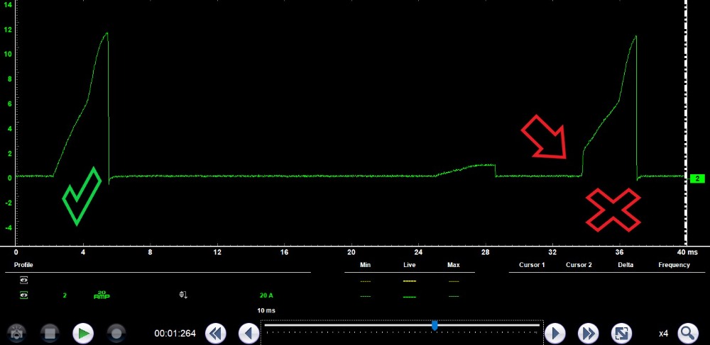

I've never done a current ramp tests but did watch one of scanner Danner videos where he does it. Il do some more research on it tho. How do you know what a good waveform is for the current ramp.
Looking at enough of them, mostly. :silly: Paul has some fantastic videos about current ramping coils on YouTube. As an example, I took these ramps off a 2008 Nissan Altima 2.5L:
Coil on the left is lovely. Coil on the right is missing the first part of its ramp. Straight up line. Classic indicator of a shorted secondary winding in the coil itself. This also had a dead misfire at all times.

I feel like a moron! Lol it was a bad coil. It was only an issue under a load but not wot. Today while driving it I noticed number 2 had alot more misfires than the others, it made me think this may be a single cylinder misfire and since I had extra coils and still don't really know what I'm doing with ignition waveforms. I caved and swapped parts. Fixed it right up I ever verified the fix by reinstalling the bad coil in a different cylinder, misfire followed. I then did a current ramp test on a good and the bad coil and they were Identical, I assume because it was idling. Since this was only an under load misfire how would I could about troubleshooting this type of issue next time? Like what kind of test could I have done to see this?
