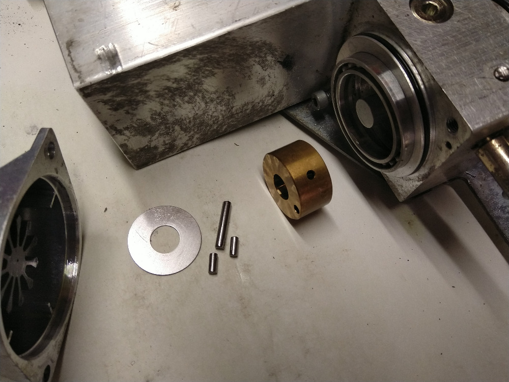

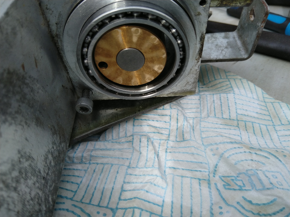

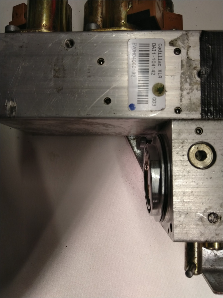

Yesterday I think I found the root cause. Pulled the hydraulic pump out and it's motor is stuck solid. - Strangely it was working briefly/intermittently so with so many inputs needing to be right to get it to go it was not the first suspect. However commanding it from the scan tool I was getting an overcurrent warning. Bench tested and yep its locked rotor.
Pulled the motor off the pump and the motor has obviously been replaced very recently as it was shiny and new. However it looks like the re-assembly was a botch job as the bearing housing is not in square and I don't think the jiggly bits are all there. Motor runs perfectly off the pump. Solenoids ohm out the same, but 2/5 connections were bad.
Jaunty angle of bearing housing :ohmy:
Missing dowel
Has anyone got disassembly pics or an exploded diagram of the section in the pic. The bearing seems to be a guide for the dowel pins (only 2 came out, should be 3 I think!) that act as vanes.
I believe it is the same as the Corvette pump. Last resort I can send it off to "Top Hydraulics" for a re-build or swap out but that's $200 and weeks in shipping to start with (plus insuring a $1,500 part) even before their costs, so if it just needs to be put back in the right order with the missing part and I can press in that bearing square to the right depth then that would make the customer happy.

Looks like one of the dowels is a drive pin that goes from the motor spider into the brass piece. Can't really tell more than that from those pics.
Haven't been able to find a parts breakdown. 04 and up Saab 9-3 pumps look very similar on the pump and motor side. You could buy one of those used for cheap and dismantle it. Might even be able to rob parts from it. The 'vette C6 pump is an even closer match and I did find a UK based rebuilder of those.

Yes the long pin is a drive from the pump spider wheel, the 2-should -be-3 short dowels are in the off centre brass bush holes, they slide out from the centre into a groove in the body to act like vanes I think. They are kept in the groove by the bearing. As the bearing is not in straight I think it worked for a while before jamming.
My worry is that there are pieces that are not there or have been substituted - I think that might be the wrong bearing for example.

So I had another think about this and realised that I have the principal of operation wrong.
It's a radial piston pump. en.wikipedia.org/wiki/Radial_piston_pump which means that the bearing should be all the way in the recess for the pins to contact, however as it is stuck solid at an angle the wrong size bearing may have been used or there may be a circlip missing to hold it in place.

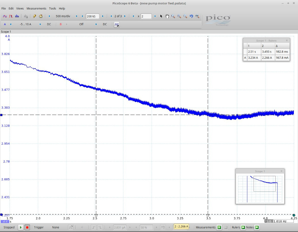

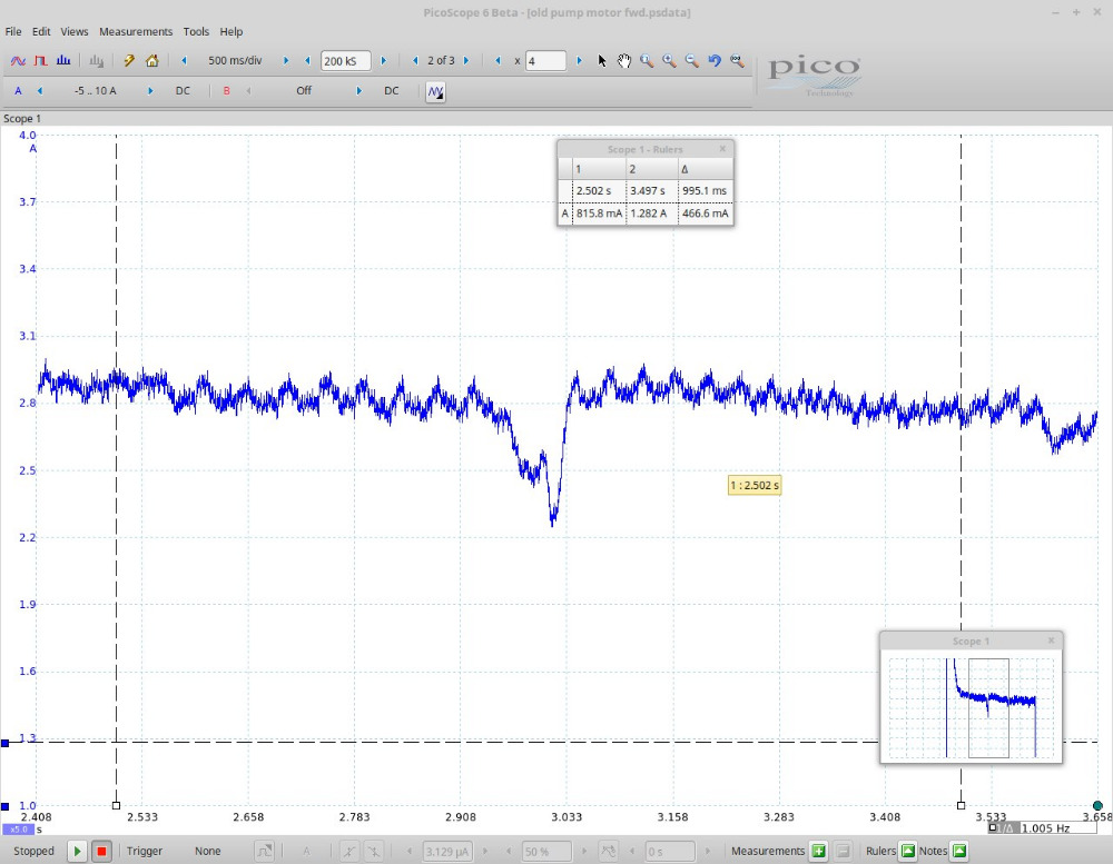

5 years 7 months ago - 5 years 7 months ago #47576 by Wightscope
Replied by Wightscope on topic Cadillac XLR / Corvette roof pump
Scoped the two pumps on the bench, looks like the original "new" one has a big 'ol dead spot and is a bit rough to say the least - the dead spot may explain the locked state rather than the bearing. The Saab one is pretty good. Two pics at the same scale 60A clamp on low (ancient version of Picoscope as my desktop runs Linux and Pico never updated it)
"New" on the car
Saab on the replacement

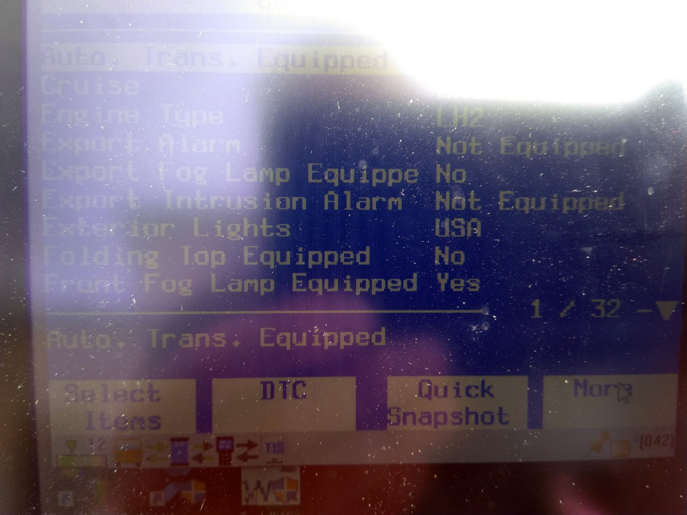

5 years 6 months ago #48102 by Wightscope
Replied by Wightscope on topic '[--Cadillac XLR / Corvette roof pump
Long story but got a Tech2Win setup working eventually.
However with the car now having sat around a bit there is no response at all from the folding top switch so I can't do a calibration.

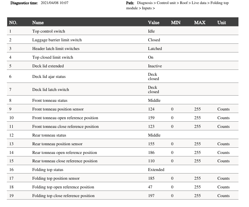

Have checked all the pre-requisites (windows showing normalised, in P, valet off, top extended and latched etc). The valet switch is connected via the HVAC module on the class 2 and so is the DLC so that's working. Pic of status before attempting to calibrate.
Obviously the 2 tonneaus are wrong - but that's why I need to run the calibration.
I can see the inputs, outputs and live data to the FTM so pretty sure that's working. However no reaction at all - first action should be an express window open (I guess commanded by the FTM on the Class 2 to the DDM and PDM . Also no reaction on the dash - the "top not secure" message is there but does not appear in reaction to the switch as previously it had.
The switch is connected to the FTM and I can see the switch when activated on the Tech2/Autel, I can command the solenoids and pump motor on the Autel via the FTM and they work (after I repaired the ground connection )
The Tech2 had flagged some non-comms on the class 2 and from splice pack investigation it looks like the RCDLR might be causing intermittent issues. I will disconnect that and see if any change. I can only think that it's a network issue
One real oddity on the T2W was the BCM configuration thinks it does not have a folding top. Which is odd as the car only came with one. Anyway it was working previously so putting that one aside.
Ideas on what I might be missing welcome.

I went through the manual for calibration and still all the inputs read as ready to go - except the front tonneau position - but that is what the calibration is for. No codes in the FTM
