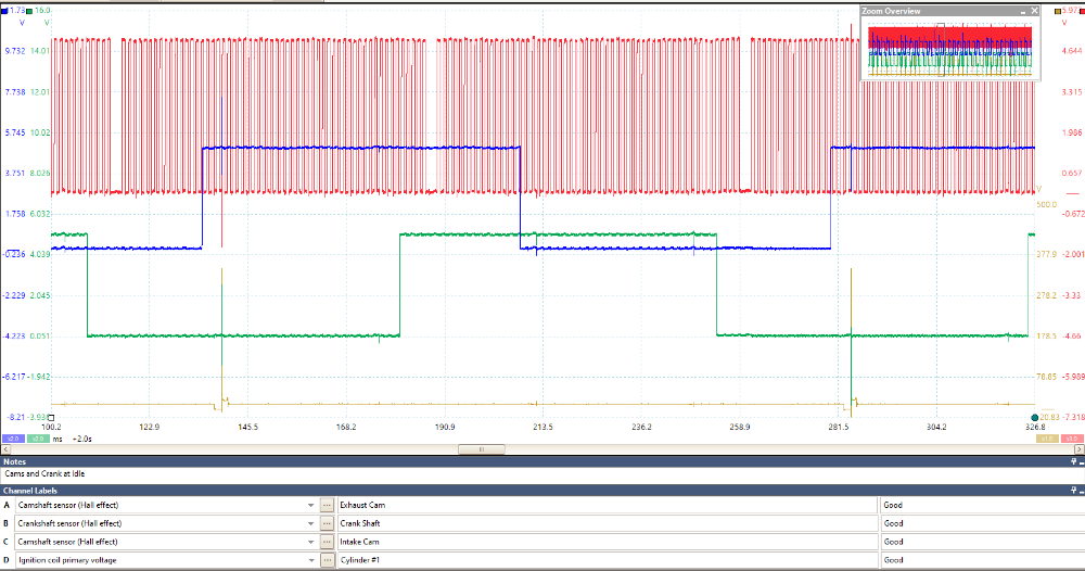

Hi all,
I have a Dodge Journey over here with a P0017 code, Crankshaft/Camshaft timing misalignment Bank 1 sensor 2.
I'm in holland and we don't have the examples in software here. Maybe someone of you guys have a known good example for me?
It's a 2009 Journey with a 2.4 liter gasoline engine. The engine code is ED3.
Thanks in advance!
5 years 7 months ago #47513 by Chad
Replied by Chad on topic Known good timing example Dodge Journey
This is from a 2010 Dodge Avenger 2.4L.
Pico .psdata file
5 years 7 months ago #47536 by Ferox
Replied by Ferox on topic Known good timing example Dodge Journey
Chad wrote: This is from a 2010 Dodge Avenger 2.4L.
Pico .psdata file
Great! You helped me alot! Timing was ok by the way.
