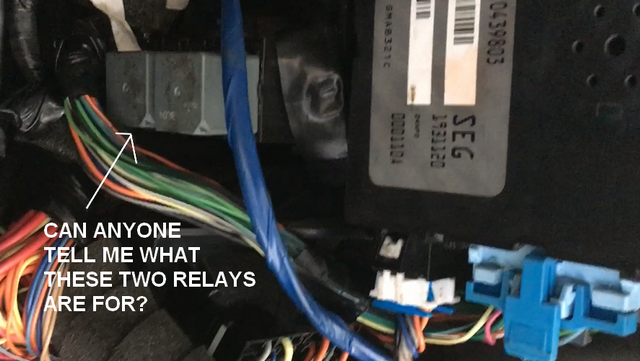

Possibly Solved....I need help identifying 2 breakers under passenger side of dash. When I flipped them after my test drive one of them was pretty hot. I think this could be involved in a 5v issue if they aren't plugged in correctly. Years ago, after the "electrical expert" had it, the module these two breakers was plugged into was hanging and I plugged it into the clips that hold the module in place. I also put black tape around the relays to keep them from coming loose. However, I never took them out and flipped them around until the other day and then I put them back the way they were because I figured I didn't solve the problem. Today I flipped them and my gauges did not go nuts since and I don't hear any fuel pump and relays and injectors flipping out while the key is in run. They did when I was shutting off before I flipped them.
I cleaned up and made grounds better through all of this but I do not think the grounds were my problem. I think my original problem its related to this. Thank you to everyone who has responded to my posts to help me think this through and not give up even though I was ready to throw in the towel.

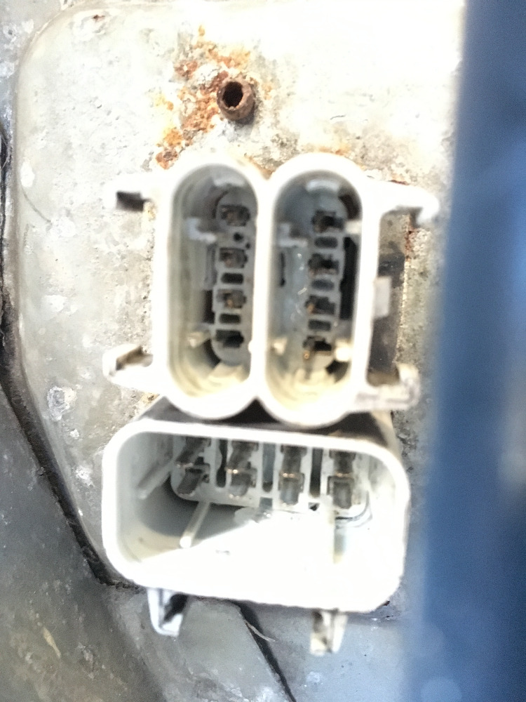

I feel that I need to crack open the PCM before I do anything else and try to do a video showing the two pins (inside one of the plugs not on the PCM) that I see are pushed back. I think one of them may actually be pin 1&2 that If I understand correctly is ground on this attachement. I feel like I need to correct those pins but I do not know how to get in to do that correctly without screwing up other pins. I am not sure pins are the correct term. If I remember correctly they are inside the clear terminal plug as there is a big terminal plug that is clear and one that is blue.
Last edit: 5 years 6 months ago by Sopey52.
5 years 6 months ago #48147 by 70monte
Replied by 70monte on topic Could this be root cause?
If those pins are pushed in, they are probably not making contact and will cause problems. Whether they are related to your running issues will be determined by which circuit those pins are for.
Have you checked all of your power and grounds at the PCM?

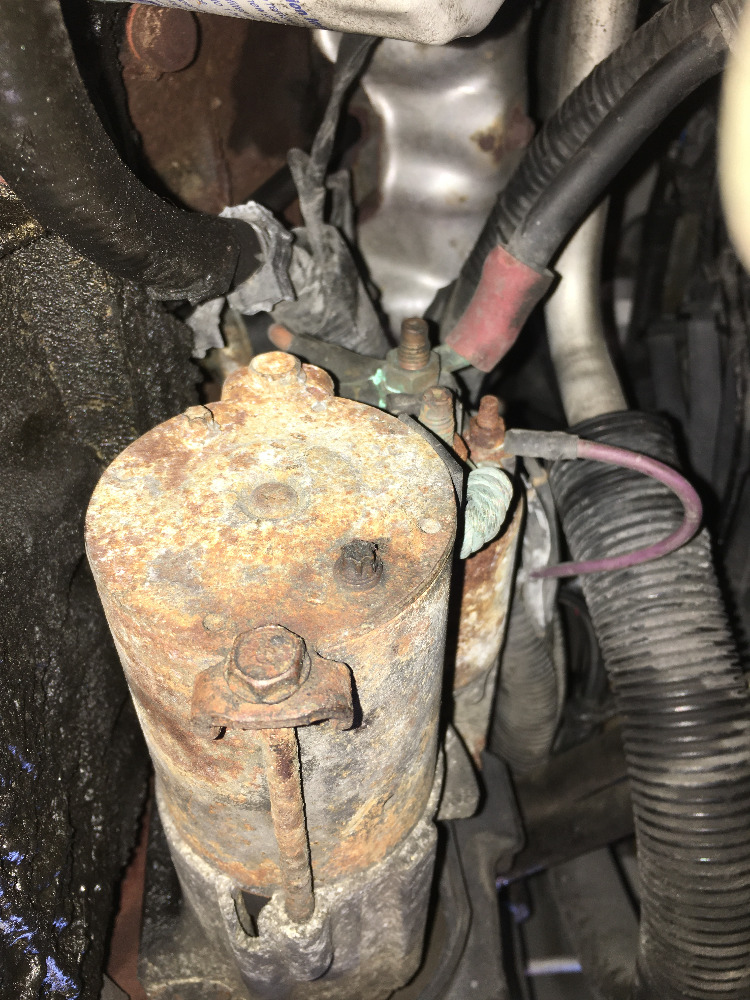

How old is your starter? You could have some internal electrical problems with it that could prevent the vehicle from starting.

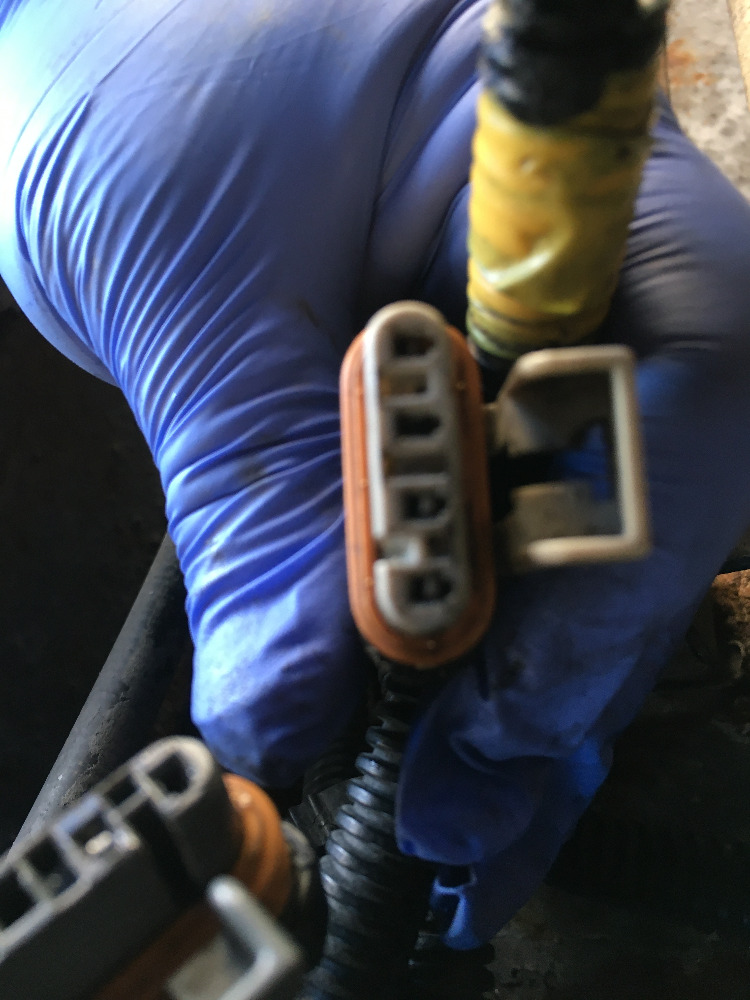

@70Monte ....Funny you mentioned Transmission Range Sensor. I had to deal with that on our Focus this week. So I was wondering if I could have an issue there...however I can read that many sensors can cause my issues I am experiencing with this van. On the Focus, I just cleaned it up and reseated it and so far so good. It may have been banged up a bit from fender bender, included a cv axel break, a year ago and there was sludge all over it.
UPDATE UPDATE UPDATE.....I managed to get rid of 1/2 of the codes and still have the P0122 Throttle positions sensor low voltage and the P0452 fuel pressure circuit low. I also found a way to get my security light to stop being part of the rotating Battery Security Low Fuel by pulling the PCM Program fuse and moving the key to the accessory position and then plug that fuse back in. It was just something I decided to try on a hunch because the manual says to pull that fuse with key in accessory to customize settings which include the alarm and or disarming the alarm. So then all I see is battery low fuel battery low fuel...I can get the van to start but it only runs for a couple of minutes and then shuts off. Then it is difficult to start but then shuts off. Eventually the Security light comes back to that sequence but does not stick around. It eventually goes away until I can finally get the van to start and run a bit and if it stalls Security is there with Battery and low fuel until I turn the key off..but then if I put it to run I only see battery / low fuel/battery/low fuel. So now Security only shows up after the van shuts off instead of being there all the time.

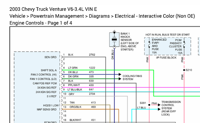

I have done a lot of testing without commenting on this forum (believe it or not) and I am now convinced that my problem is a bad computer. Meanwhile my coolant fans and my heater blower fans will not work. I have verified that the fans work by powering them from the main plug that splits between them and I can make one fan run slow and high from coolant fan 1 and coolant fan 2 relay. I spotted that the main diode fuse in the underhood fuse box was half way out...I test it for ohm and get resistance. Its the dark black fuse with arrow on it and I can't see through it to see if it is shorted.
So far I can now get the van to run until the engine starts to overheat and I either shut it off or it shuts itself off. The battery / security / low fuel never goes away.
I found a video on youtube where a young guy solved the exact same problem with battery/security/low fuel (Buick Rondevous) by going to a junk yard and pulling the PCM, BCM and Passkey 3 module. He put it in his vehicle and all he had to do was the 30 minute key relearn and his problems were solved. Before seeing this I actually pulled everything but the PCM from a Venture. I went back 2 days later to get the PCM and the van was gone and crushed. I could have bought the PCM for $21 if I had known this.
I thank those of you who have tried to help me. I watched enough of Scanner Danner videos and did enough of my own testing to believe this is a bad computer issue.
I have also called and talked to 2 Dealerships. Nobody on this forum and even those two Dealerships cannot tell me what the two relays are that I asked about on here. I am betting they have something to do with antitheft. Meanwhile the dealerships listened to my saga and believe I either have a bad computer or it needs to be reprogrammed. I like the idea of going to a junk yard and spending maybe $70 to pull the PCM, BCM and Passkey 3 + there is one more module under right side of dash. IF I try this and fail, I give up.
5 years 6 months ago #48636 by Hardtopdr2
Replied by Hardtopdr2 on topic Could this be root cause?
That's a one way diode not a fuse (dark black fuse with arrow) fyi

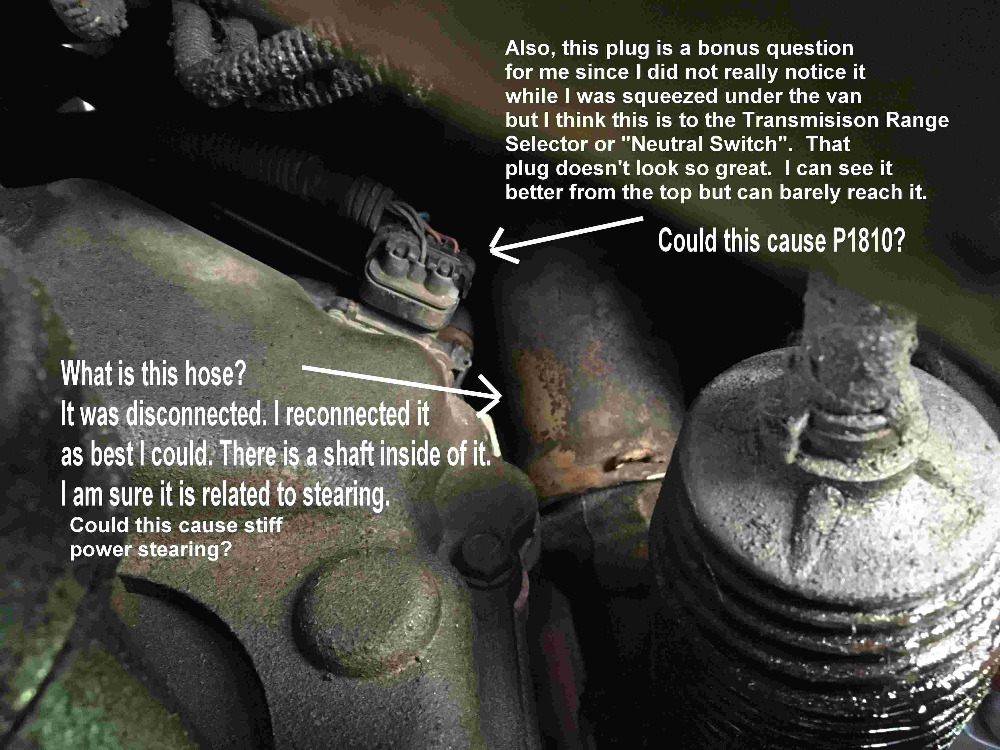

FOLLOWING UP. I am in agreement with Matt T that the secondary air pump does not exist on my van. Even though the Haynes Manual says it is there, I got underneath the van and I cannot find the pump or the solenoid where the manual says it should be. Advanced Auto cannot get the part to show up for 2003 Chevy Venture FWD. If I search on Amazon, I either get the "this part does not fit your ______" or I get a part without "this part fits your ____". So I am going to ignore those codes.
What I need to resolve is P1810 which has come back and with some hard shifting. This seams to happen only if I run the van in D. If I run it in 3 the problem does not happen as far as hard shift but I still get a code. I found a video showing someone who had a Customer with a Cobalt who replaced his transmission due to that code and still had the problem and it ended up being shorted signal wires....he did not need a transmission. I hope I can find something like that again.
I also need to resolve my power steering pump issue where I may have created the problem myself by deciding to use a power steering pump from a Pontiac Montana (I took the PCM from it) because I did not want to spend over $100 for a pump if I was not going to be able to resurrect this van. Currently I have been bleeding the system and using the thick Lucas Power Steering Stop Leak. I do not believe I have a leak anymore but I am hoping this resolves the noise and stiff turning on slow turns and so far it seems to be working. I am making progress as the pump is getting quieter but slow turns are very stiff.
FINALLY, I have attached a photo of a hose that attaches over a connection behind a driver side tie rod. There is a shaft inside that hose and the hose was completely off. I took this photo after I did the best I could to put the end of the hose back onto where it is supposed to connect. The van was not on a lift when I did this. I was under the van after I drove it up a makeshift ramp of boards. I would like to know what this is called and if it has any relationship to my power steering issues. Is it a vacuum hose or just a dust cover for the shaft. I am not a mechanic so I do not know what everything is and just learn as I go. Thanks for your time.
