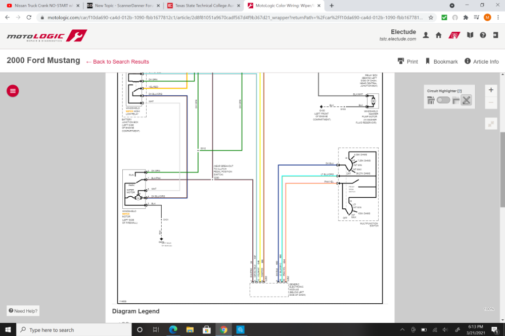

5 years 7 months ago #47647 by youngmarlin
