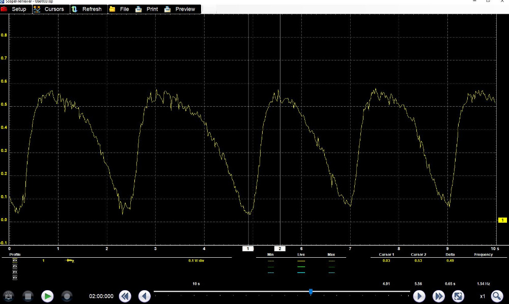

5 years 7 months ago - 5 years 7 months ago #47815 by MGNut
Replied by MGNut on topic '96 Toyota Tacoma P0171 Lean Code
Really appreciate the replies. Attached are a couple of pics of B1S1 Voltage waveforms (there are just 2 sensors, one upstream and one dowstream of the cat). Since the O2 connector is difficult to reach, I had to backprobe at the ECM and got a ground from a powerprobe adapter connected to the cigarette lighter. I have a 20 year old MODIS, so can only display images on my monitor and grab screenshots.
The first pic is fully warmed up, at ~2500 rpm. As you can see the range is ~0 to 550 mV. For that portion of the scan, total fuel trim was ~5%. At idle, I'm flat-lined on voltage and total trim is 20-40%.
I've been looking for vac leaks. When I first started investigating, I found one small vac hose on the back of the intake that was disconnected. Probably has been disconnected since I replaced valve cover gaskets a couple years ago. Reconnecting it didn't make much difference. I wasn't able to check heater voltage and gnd at the connector, but was able to ohm the heater: ~13.2 ohms.
Truck has no drive-ability issues. The O2 sensors are original, w/ 262K miles. Section 5 of SD's book indicates healthy O2 sensors should oscillate between ~200~800 mV, w/ peaks <200 and >800.
Is my O2 sensor just worn out, or should I continue to go down the vacuum leak path?
Last edit: 5 years 7 months ago by MGNut.

5 years 7 months ago #47832 by VegasJAK
Replied by VegasJAK on topic '96 Toyota Tacoma P0171 Lean Code
You have no 02v at idle B1S1? No oscillating at all? But you have 0-55mv at 2500 rpm. The heater in the 02 is out. At 2500 rpm the exhaust is heating the 02 to make it do a little. Even so that mv should go to 800mv. You should be seeing an open loop at idle on scan tool. You're at 37 total trim at idle. ECM is pouring in fuel.
The following user(s) said Thank You: MGNut

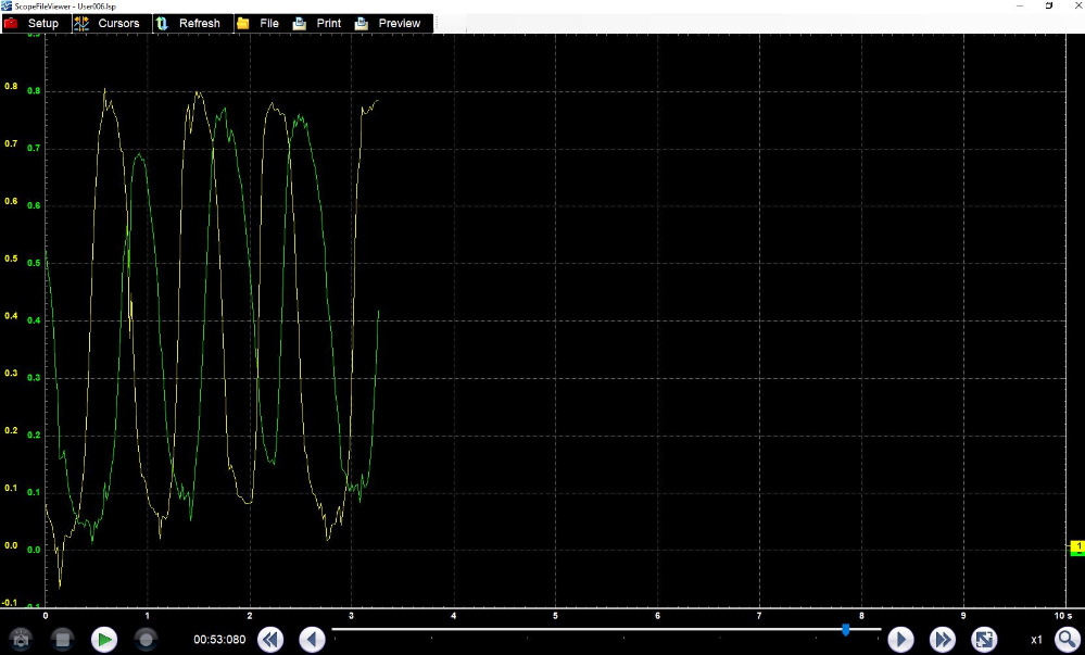

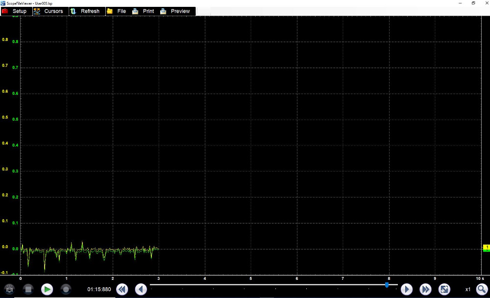

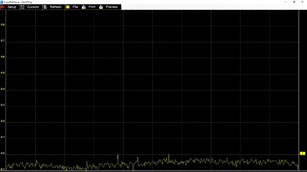

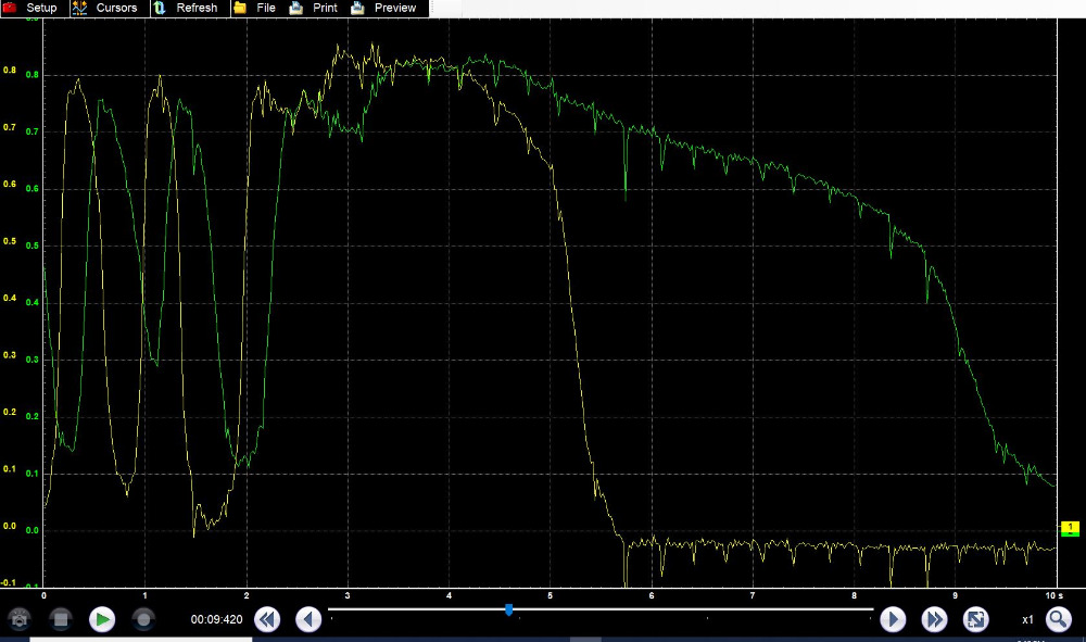

5 years 7 months ago - 5 years 7 months ago #47929 by MGNut
Update: I replaced both O2 sensors w/ Denso units. Waveforms look better at 2500 rpm, but fuel trims are pretty much unchanged. Sensors become active within a minute or so, so I have to believe the heaters are working. I should have let my snapshots run longer. Sorry about that.
Here's Idle (696 rpm, ECT: 86C, AF: 2.38 g/s, STFT: 19.5, LTFT: 27.3)
Here's 2500 rpm (2569 rpm, ECT: 89C, AF: 12.03 g/s, STFT: 3.1, LTFT: 11.7)
Here's transition back to idle
Yellow is Sensor 1, green is Sensor 2.

5 years 7 months ago #47932 by VegasJAK
That wave form at idle is bad... You should have 100-800mv oscillation just like the 2500 rpm not flatline 0. Are they going into open loop at idle?

5 years 7 months ago #47938 by Matt T
Replied by Matt T on topic '96 Toyota Tacoma P0171 Lean Code
MGNut wrote: Here's Idle (696 rpm, ECT: 86C, AF: 2.38 g/s, STFT: 19.5, LTFT: 27.3)
Looking for direction, should I continue down the vac leak path and get a smoke machine or investigate fuel pressure or MAF?
Your idle g/s is way low. Somewhere around 3.5 to 4 g/s would be about right for that motor. Since the situation improves at higher rpm it's more likely to be a vacuum leak than a misreporting MAF.

5 years 7 months ago #47948 by VegasJAK
What I'm seeing is no O2 activity at idle then when rpm is increased to 2500 02's respond then go back to no activity when engine returns to idle.
Heater circuit is not working as I said prior. Not the 02's, the wiring circuit. Check power and ground and check for blown fuse on heater circuit. If fuse is good you have an open on power or ground.
The reason you get activity at 2500 rpm is that exhaust is heating 02's.
5 years 7 months ago - 5 years 7 months ago #47949 by Matt T
scannerjohn wrote: What I'm seeing is no O2 activity at idle then when rpm is increased to 2500 02's respond then go back to no activity when engine returns to idle.
Is that no activity or pegged lean? Whatever it is happened pretty quick in the "transition back to idle" trace. And happened to the upstream first.

5 years 7 months ago #47953 by MGNut
Cheryl wrote: You pinch off the brake booster hose? And purge valve? Also I’d try a capacitor discharge on it to reset the computer. Unhook both battery cables connect a jumper wire between them for 10 minutes. Not the terminals on the battery but the cables. Then retest. On them older Toyota’s like that I’ve had them not correct after a repair
I have pinched off the hoses mentioned and more. After replacing the O2s I did disconnect the battery for ~10 minutes. Fuel trims started at zero and it stayed in open loop for awhile. After ~15 minutes or so of driving it went into closed loop and trims went back to where they were.

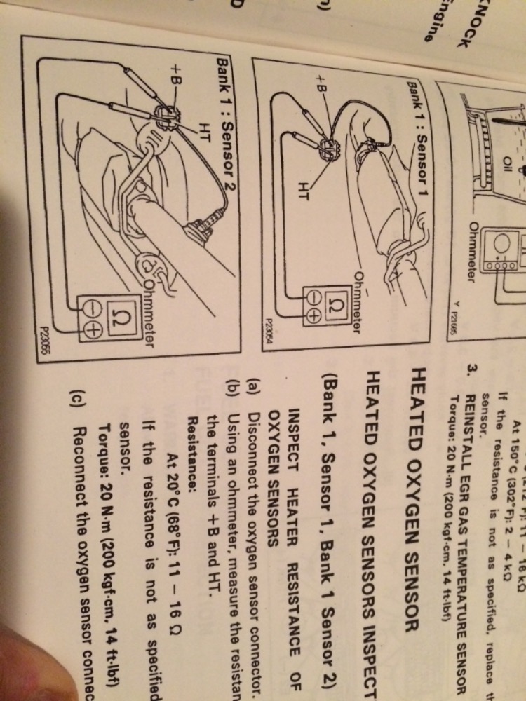

5 years 7 months ago #47954 by MGNut
When I first start the engine at idle, the O2s do oscillate pretty quickly. As it warms up they oscillate slower and finally flatline. It does stay in closed loop when flatlined.
With the old O2 sensor, I have the makings for a test harness. I'll put light bulb on the end of the heater wires and report back.

5 years 7 months ago #47965 by VegasJAK
Paul
You have a 3.4l V6 engine. You will have three 02's. Two upstream, one each just below the exhaust headers on each side of the engine, and one post cat. Your scan tool should show B1S1, B2S1 and either B1S2 or B2S2 for the post cat 02.
The upstream 02 heaters are controlled by the pcm. At startup the they are in open loop so the heater circuit are active until they go into closed loop at which time the pcm monitors signals from other sensors ECT, MAF, IAT, MAP to tell it to pulse ground the heater circuit according to engine conditions and 02 heater temp to keep the 02 at 700+ degrees. Above idle the 02 will remain hot from exhaust gases but will be pulse grounded as they drop below 700 degrees.
When you use your 02 light adapter, the light should be steady at startup for only a few sec or so then pulse on off.
Your engine temp is low. Should be 205-210 and the MAF g/s should be 3.4-4 at idle. I'd you have not done already, clean the MAF and IAT. Take care in cleaning they are delicate. So not touch them only use a spray MAF cleaner.
The voltage on the post cat 02 should be steady at 500-700mv. It should not oscillate.
Look forward to hearing your next post.
