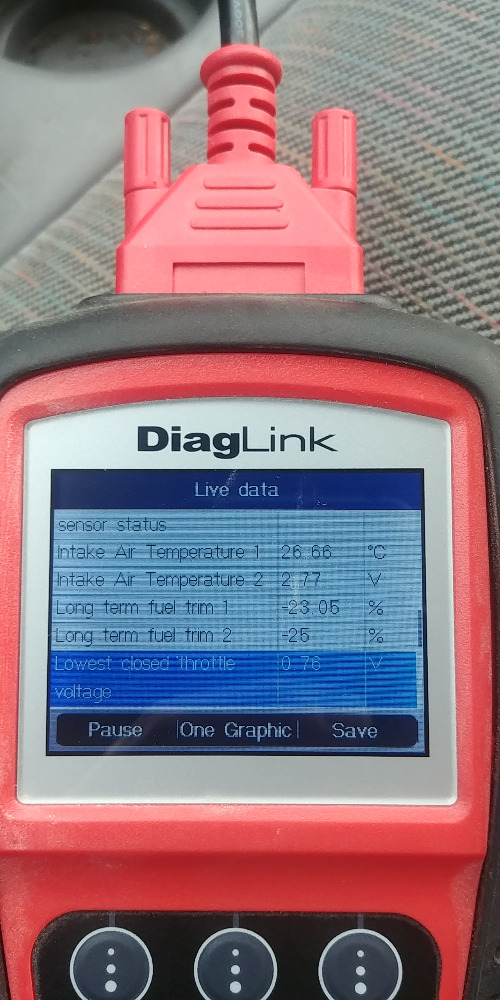

Scanner shows:
-Massive negative -20s LTFT & negative STFT also (BOTH BANKS) – also throwing code
-O2b1 & O2b2 showing normal average of .45v, and so is O2b1-2 downstream

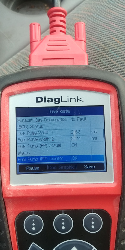

-FP is 35ish regulated, and slightly higher with vacuum like pulled off
-FP slightly rises with throttle on tank1, and drops to a crappy 20 on rear tank (known weak pump in this tank)

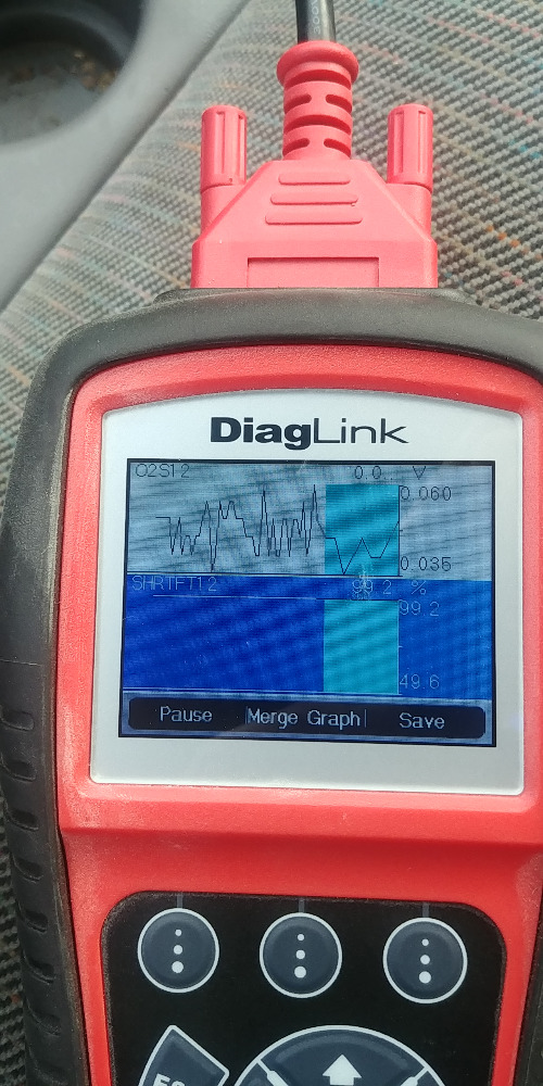

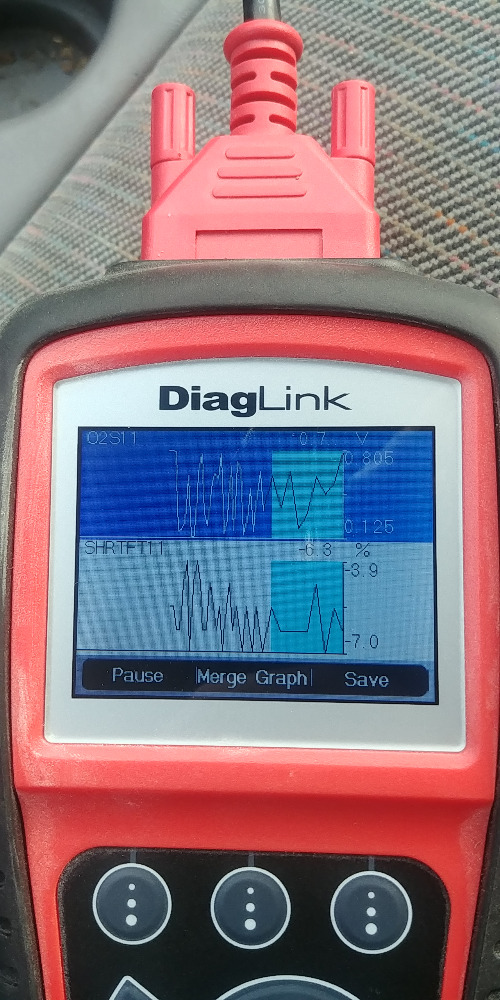

After another 20 minute drive I graphed the secondary o2 post cat and found it was way way down in the .0x voltage range and only spiked infrequently.
Any help would be great.

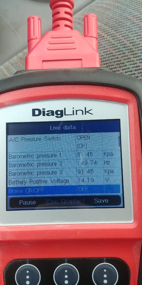

5 years 7 months ago #47741 by Cheryl
Can you post a pic of the front and rear o2 sensors graphed? With engine rpm and temperature. From the sound of it the .45 might be a bias voltage like gm uses. Not sure if that vintage of ford used bias voltage. Also it might not be a. Bad idea to actually scope or use multi meter to check the actual oxygen sensor voltage Incase the pcm isn’t interpreting it right. From the sound of it sounds like 2 bad oxygen sensor in the front because you said the rears were dead lean
  • SILVERFOXTRANS
  • SILVERFOXTRANS's Avatar Topic Author
5 years 7 months ago #47757 by SILVERFOXTRANS
Replied by SILVERFOXTRANS on topic 1996 Ford 5.0 Truck diagnosis (massive negative LTFT)
Thanks...the Autel can't show me more than 2 graphs, but I will get a combo of pictures at least then. Something is telling it I have 25% more air coming in. I plan on use the DVM on the MAF this weekend.
as for the .45v, I am just suggesting that is the average I am seeing as it floats from .1 to .8 when it switches.
I also need to pull the fuse and let it re-learn for a better picture.
It does also have a canister purge code...solenoid replaced twice now. I need to check wire integrity - there are no other sensors to suggest CAN P is bad other than the EEC verifying there is ohm value at the solenoid...so if two units fail, I assume there is a wire issue.

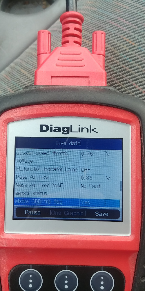

If I pull the spout and the MAF connector it would be stay in open loop no spark advance, and read a pre-set table of fuel curves based on o2's still right? Will the o2's still function and graph proper?
  • SILVERFOXTRANS
5 years 7 months ago #47800 by SILVERFOXTRANS
I have ran without the MAF connected and it still ran like crap.

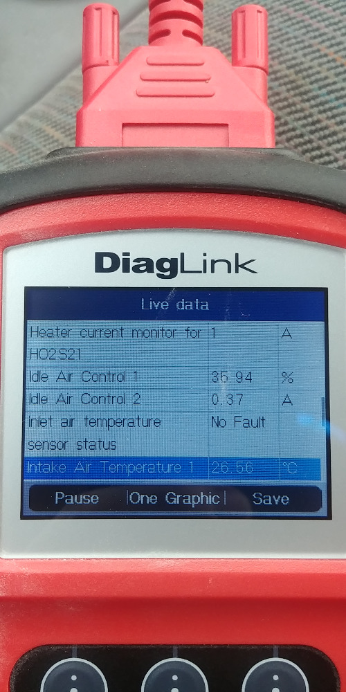

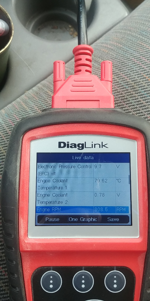

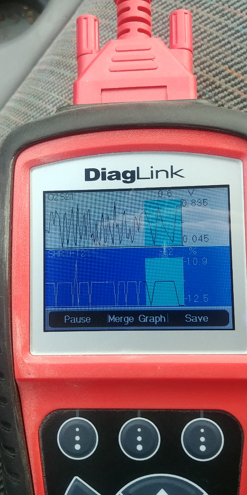

next images
  • SILVERFOXTRANS
5 years 7 months ago #47802 by SILVERFOXTRANS
My EEC is pulling fuel hard.
CODE PO172 and P0175 popped up today
I AM NOW SERIOUSLY QUESTIONING THE AMAZON INJECTORS FLOWING TOO MUCH!
If that is true, I am super confused why it runs like it is out of gas when I am providing too much?
5 years 7 months ago #47810 by Tutti57
What do the o2 sensors say on the freeze frame data? I'm with Cheryl thinking that low rear 02 voltage indicates that the front sensors may be lying. Do a if the sensors respond if you introduce a vacuum leak or propane? Is there any way the front and rear sensor wiring was accidentally reversed?
