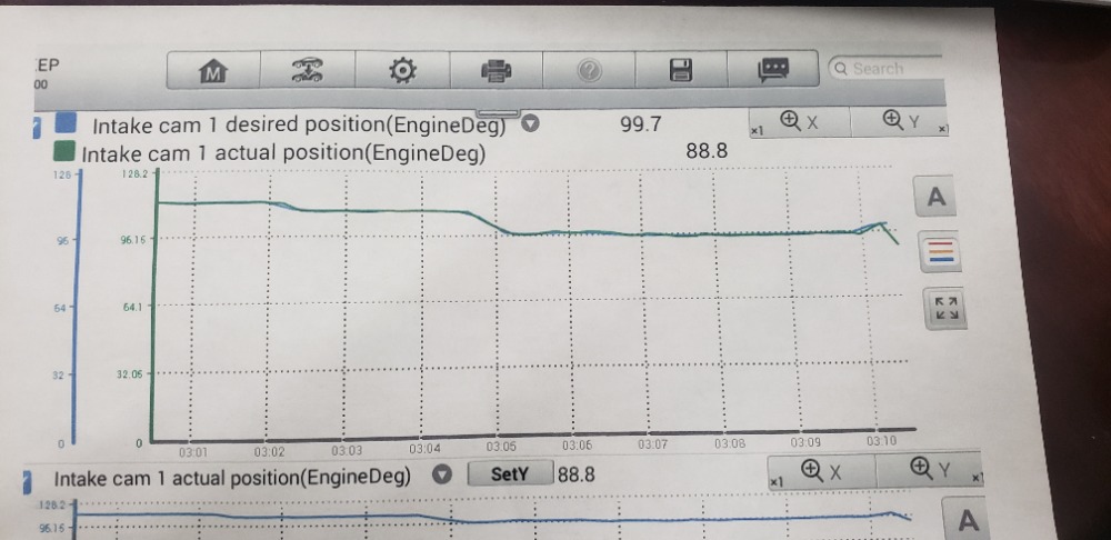

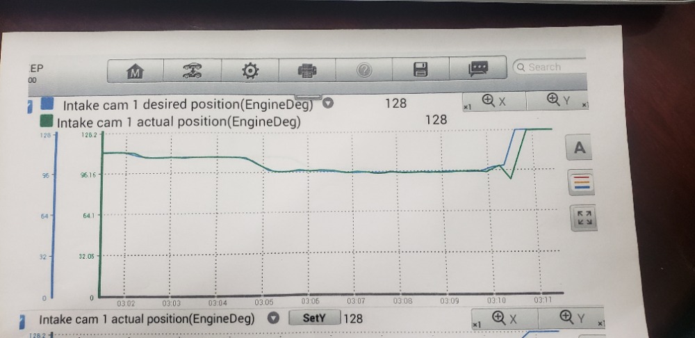

5 years 6 months ago #48103
by BLEE
Replied by BLEE on topic 2013 Jeep Wrangler 3.6 (P0369)
I didn't hook up the oscilloscope but I did do a driveability test with the scan tool data showing desired and actual position. It was out of range only pulling rpms up a hill or towing.
