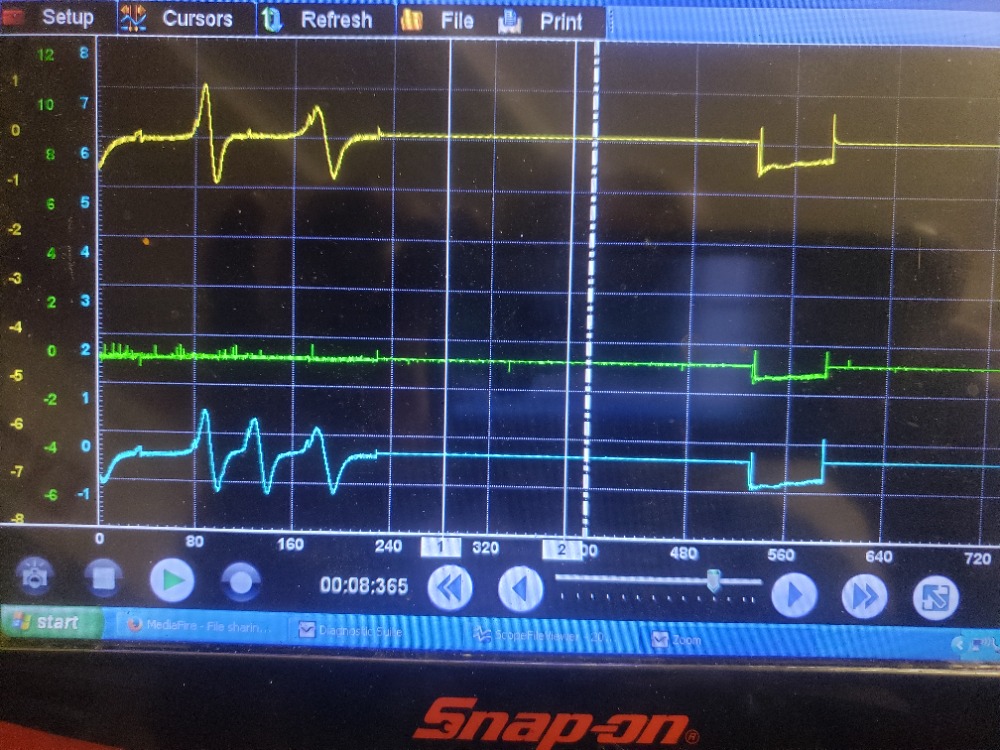

Truck came in after another shop installed a remanufactured Ford motor it will run for about 1 hour then shut off .........after it stalls it will not start up it will spin for a couple full engine rotations then the starter will disengage if you hold the key in the start position the starter will re-engage and begin to crank the motor again I have a capture of this I will share also sometimes it spins like a starter dragging or timing out other times spins normally but always with the engage disengage of the starter after the stall........when the engine stalls and when the engine will not start it appears the crank sensor signal is failing I also have a capture of that I will share.

In the first pic the green. Trace is the crank sensor? You could if you wanted put it in clear flood mode or unplug fuel pump fuse or relay then scope the cam and crank sensor check amplitude when it’s cold because you know it’s a good signal. Then compare when it stalls . Any codes?

In the first pic, the (green trace) crank sensor's riding on 2.5v bias then later on it flatlines to 0v for a brief moment. I'm asking myself what happened to the bias? Did it short? Did the computer hiccup? Do you still have 5v ref and communications? Perhaps recapture with a lead on a 5v ref somewhere.

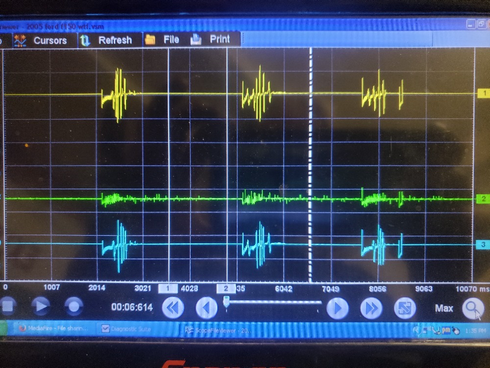

Then in your capture you labelled as "wtf.vsm" the green trace doesn't appear shorted to ground as there's noise on there. So maybe its been disconnected from the PCM. If there's an open to the computer, where's the crank signal then, lol ?
The second pic has a flat green line, so maybe it's shorted then, I dunno.

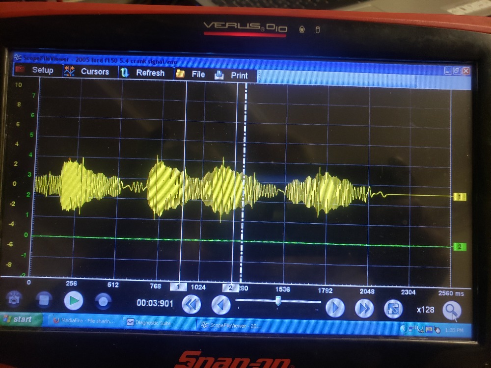

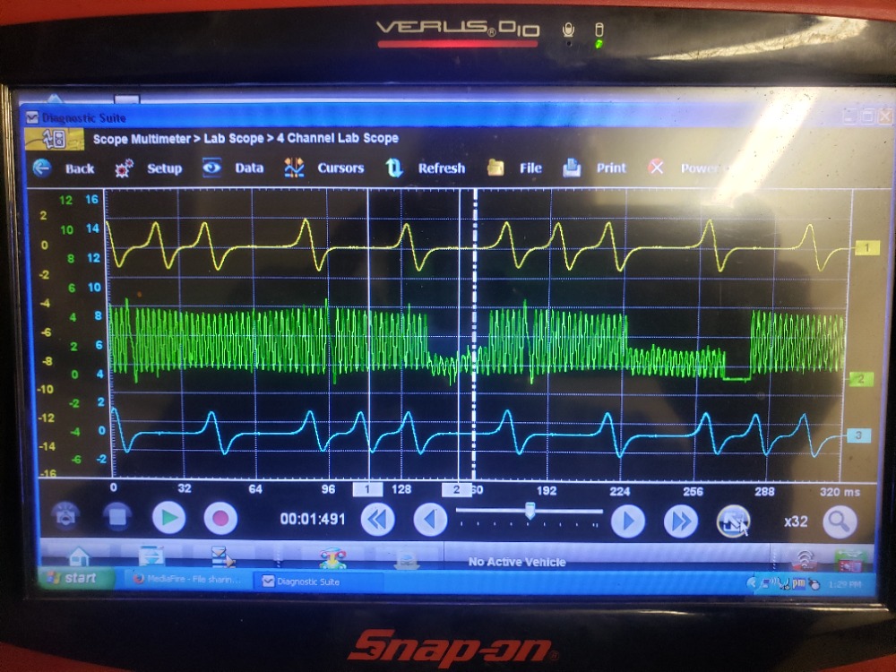

In the last two pictures is after a stall and cranking the engine as I said hold the key and the starter engages then disengages it did that three times the last time is zoomed to show a drop in the cam crank and cam leads I am not sure why but this is when it cranks with a drag or timing off..........I hope that makes since.

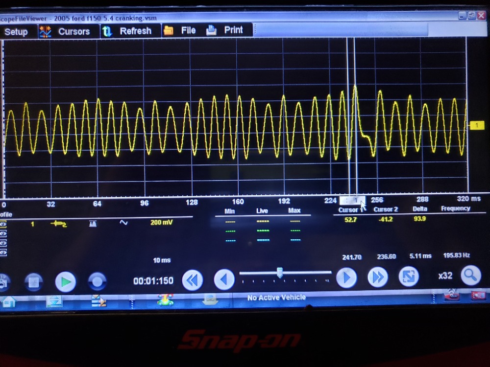

This is a cold crank with the crank shaft sensor unplugged is it me or does the notch look weird? Also notice the volts this is in ac volts on a 200 mv scale.
Last edit: 5 years 7 months ago by tim.smith1.

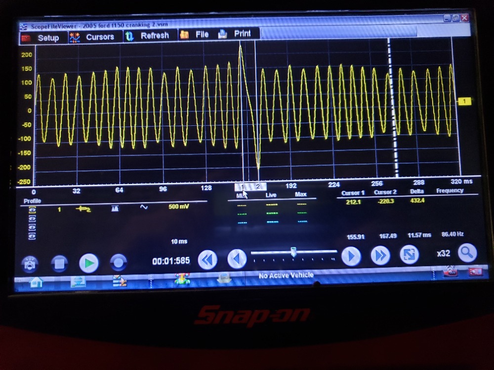

This is after it stalled and would not start up with the crank sensor unplugged and testing at sensor, notice notch and when I set it at 200 mv it was off the screen so I had to retest at 500 mv.

That sync notch does look weird. In the second picture, the sync notch is clean again. I'm suspecting the crank sensor's not tightened down enough and there's some movement of the sensor.
Are you probed into the CKP negative? I'm used to seeing the CKP notch rising, not falling.
