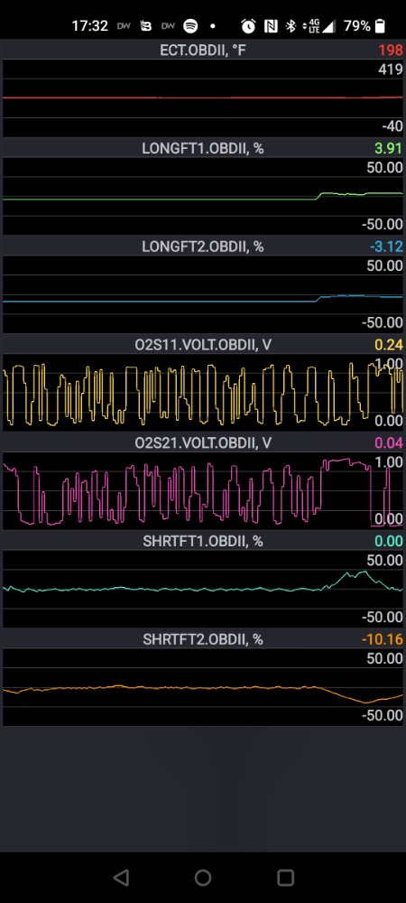

2002 Ford Explorer 4.0. Idles ok, but throws misifire codes on bank 2 when under load, and doesn't want to climb anything somewhat steep faster than about 45mph.
I was looking at several data points, and noticed the fuel trims diverge from each other when the vehicle is climbing.

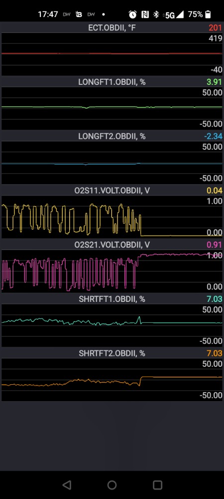

The other odd thing I'm seeing, is the fuel trims and O2 sensors flatline when the cruise control is set
Is this telling me the O2 sensors are going bad? They appear to be original to the vehicle (connector colors match the vehicle connector colors), and it has 200k miles.

5 years 7 months ago #47946 by Matt T
Replied by Matt T on topic Diverging fuel trims, help me understand
Looks like a bank to bank breathing problem. Bank 1 getting too much air and Bank 2 not enough. Maybe a plugged Bank 2 cat or a cam timing problem.
The flatlining with cruise set it might be going into open loop for some reason??? Try monitoring loop status PID to see if it goes open when you set the cruise. Pretty sure it's just a symptom caused by the breathing problem but I'm just wondering why the PCM is doing it......

5 years 7 months ago #47950 by VegasJAK
Replied by VegasJAK on topic Diverging fuel trims, help me understand
Does B1S1 peg lean and B2S1 peg rich at 2500 rpm while not on cruise?
Not while driving, check the 02's from idle then increase to 2500. What the readings?

5 years 7 months ago #47951 by Speedwagon
Replied by Speedwagon on topic Diverging fuel trims, help me understand

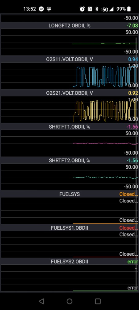

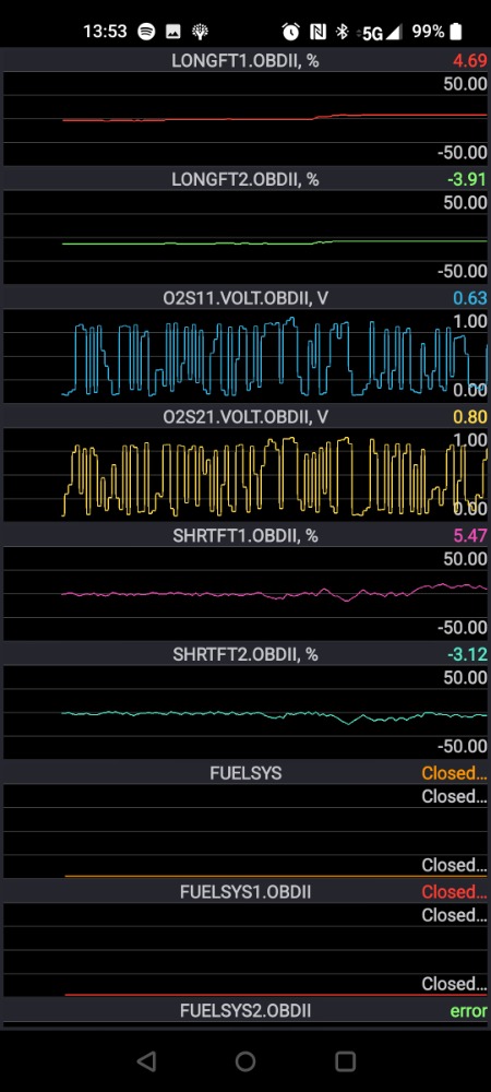

Turns out, I have an 'error' for bank 2 fuel loop. Before is idle, and 2500 rpm in neutral
5 years 7 months ago #47961 by Noah
Replied by Noah on topic Diverging fuel trims, help me understand
Error is likey a default message for a missing pid.
I've never worked on anything that actually used that fuel system 2.
The FuelSys pid is the only one you want to use.

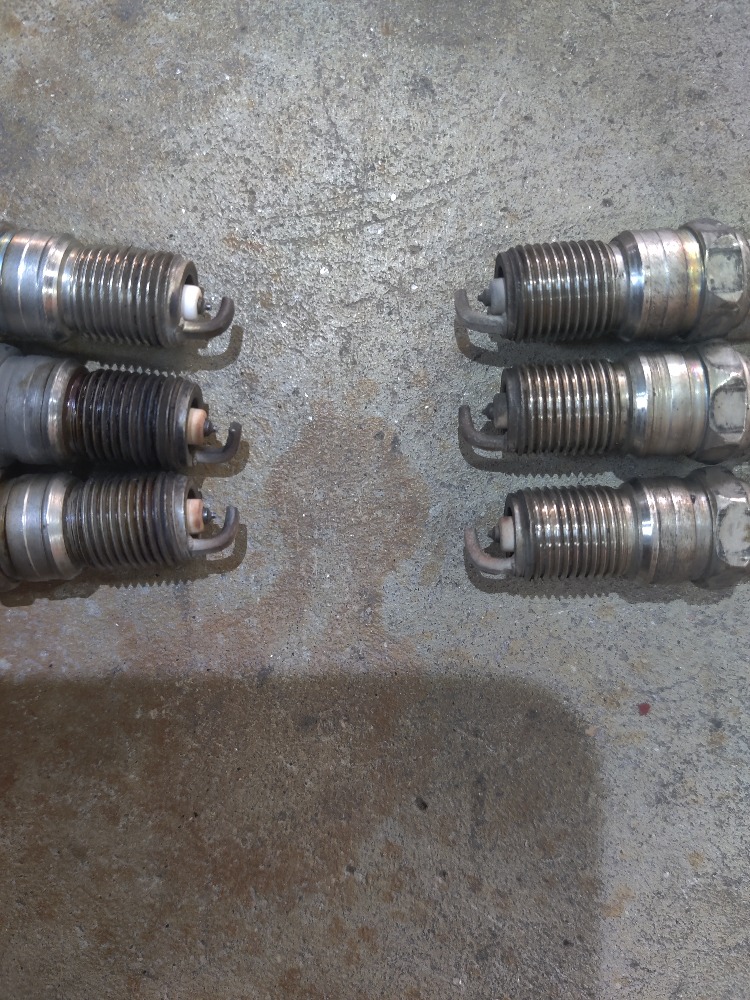

Trying to eliminate things, just did a compression test. 145-152 on all cylinders (warmed up for a few minutes, but not at operating temp, and at 5000ft Denver)
Resistant check all injectors, 15.5-15.8 warm (cold, they all measured around 14.5 if I recall correctly)
edit to add: Injector pressure drop test, starting at 59 psi on each, I got 30, 31, 30, 32, 32, 30
These are the plugs. 1 in bottom left. Doesn't look like 3 is firing correctly.
Last edit: 5 years 7 months ago by Speedwagon.

Speedwagon wrote: These are the plugs. 1 in bottom left. Doesn't look like 3 is firing correctly.
#3 looks a lot newer than the other plugs. Maybe it ain't been in there long enough to get dirty? Do you know the history on this vehicle?

Somewhat. I went through it after purchasing it for my mother, and found #3 had some random plug in it. So I replaced that one with what should be in there. Several of the plugs weren't in tight when purchased, either.
If memory serves, bank 2 is where I found 2 loose spark plugs. 4 and 6, with 6 being buggered threads that I had to reverse chase.

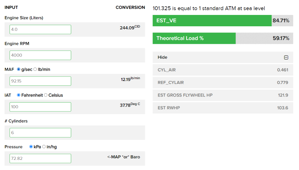

5 years 7 months ago #47986 by Tyler
Replied by Tyler on topic Diverging fuel trims, help me understand

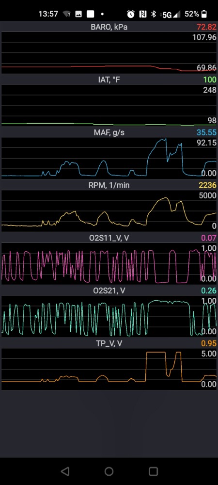

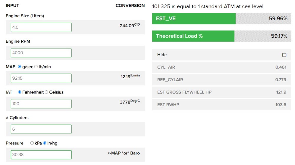

Thanks for that capture! Confirmed terrible VE:
Note that I added the actual BARO reading for Denver, which is currently 30ish inHg according to Google. But that's not what the scan data said. ;) The scan data says the local BARO is 72.something kPa, which is closer to 9000 feet. That's because the BARO is calculated by the PCM based on MAF readings. Because the engine isn't breathing correctly, the BARO calculation is impacted. With the skewed BARO reading, the VE numbers look like this:
That's closer to what they SHOULD be. But the first calculation tells the real story. I still maintain you're looking at a plugged cat on bank two. A timing problem is possible, but you'd think it'd show in the static compression readings.
