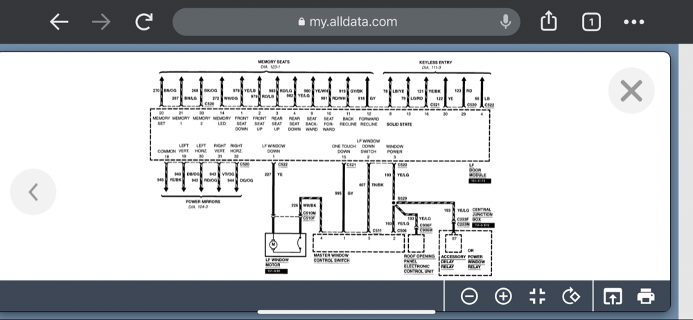

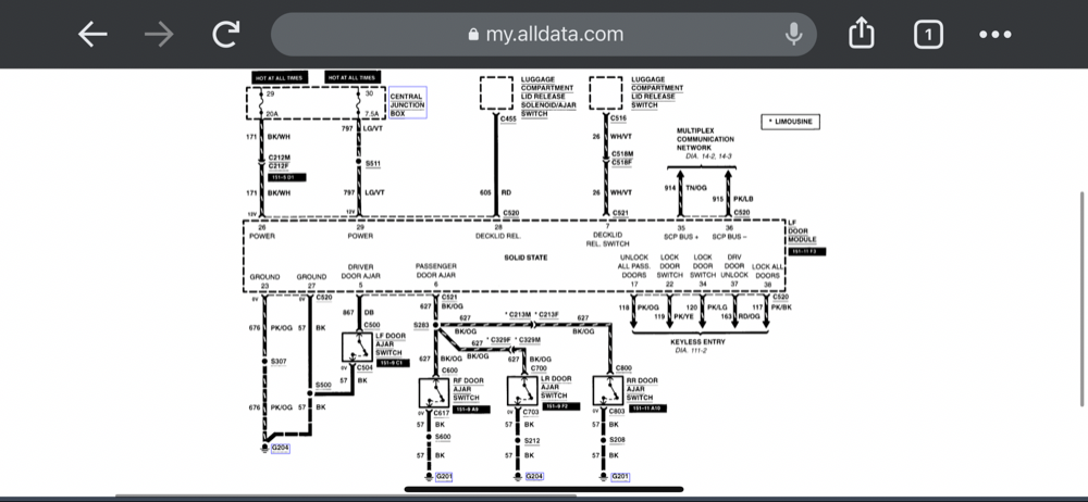

Needing a wiring diagram for the door locks and remote control door locks. Working on my brothers car he said he tested the remotes they were good. Noticed the passenger door switch doesn’t control the locks wonder if it’s related.

5 years 7 months ago #48024
by jreardon
Replied by jreardon on topic 2000 Lincoln tow car Cartier edition

Thanks guys! Can you post the keyless entry system?

5 years 7 months ago #48032
by jreardon

Fixed. Turns out guy at auto parts store put the new battery in backwards of my brothers new key fob. Used autel tons tool to test rke nothing was being put out. Flipped battery around programmed it. All is good. No FTC’ sun drivers door module either
