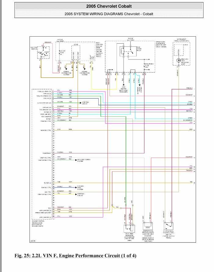

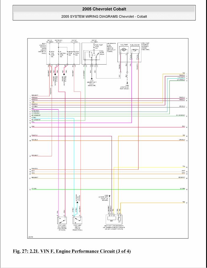

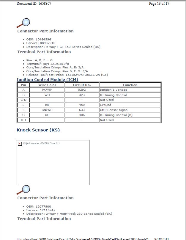

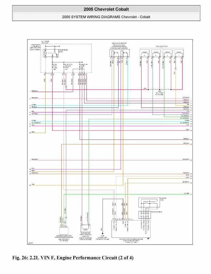

What does engine rpm read while cranking? Also you wouldn’t have a wiring diagram of the coils would you? To see if your missing a power or ground feed

Last edit: 5 years 6 months ago by twmckune. Reason: Added the wiring

I’d definitely use a test light backprobed or pierced on the coil power feed while cranking. Or you can voltage drop it if you want
