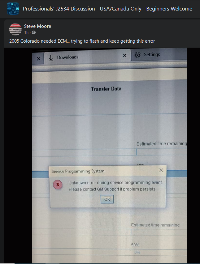

Unknown error during service programming event. Please contact gm support if problem persists. I am at car now having another go

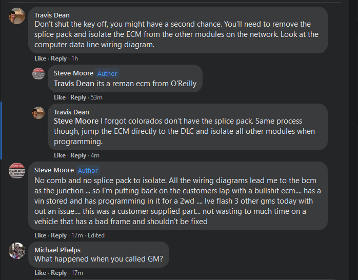

This was just posted in the Facebook Group. It appears that someone else is having the same problem.
Last edit: 5 years 6 months ago by Chad.
