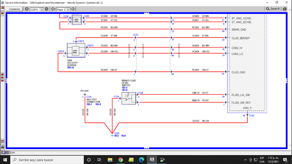

brake fluid level switch circit design trying to figure out

by Electricsanti22
brake fluid level switch circit design trying to figure out was created by Electricsanti22

Replied by Chad on topic brake fluid level switch circit design trying to figure out
Post the code ID, and I will look up the code setting criteria.
5 years 6 months ago #48204
Replied by Andy.MacFadyen on topic brake fluid level switch circit design trying to figure out
That is a pull down ciruit which makes a short to ground code confusing and puzzling.
As Chad posted we need more information from you to help. Including not only the code but the vehicle.
What scan tool are you reading the code with ? Some scantools give the wrong code definnitions and some revers hi and low states.

by Electricsanti22
Replied by Electricsanti22 on topic brake fluid level switch circit design trying to figure out
it is a ford explorer 2006 4.0, dtc is c1769-60 and scanner used is launch x431
