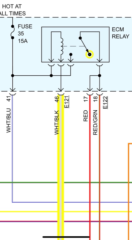

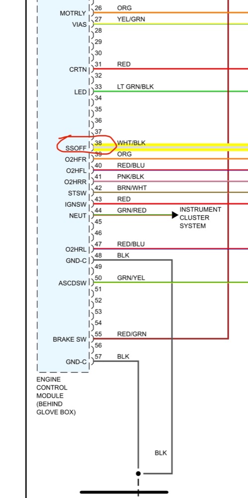

Hello Danner. I'm a new member and thanks for the cool videos you've posted on youtube. Here's the problem I'm having. My son's 2004 Nissan Altima 2.5L was having issues. First, it wouldn't start one morning. Cranked but wouldn't start. So he checked and changed the cam and crank sensor. Still didn't start. So he changed the spark plugs and it started and ran. Then later on he would start it in the morning and go get gas and it wouldn't start. It would take some time for it to start. So one day we drove it till it got up to normal temp. Pulled over and turned off the engine. Then it happened again. No Start. Waited, then it eventually started. It had a new fuel pump, Cam and Crank sensor(Aftermarket. Maybe the problem), Sparkplugs. MAF Sensor. Then it got worse. It wouldn't even start and the fans just started going on. I removed the ECU Relay and it stopped. I put a jumper wire in the 30 & 87 pins and the car would start and run great. I pinpointed that there is a power ground wire that is triggered from the ECM to the Relay. I even had the ECM rebuilt and the company said that there was only an EFI transistor that needed replacing. I still have the same issue. Here's My question. What triggers the power ground to activate? Can it be the Cam or Crank sensor?

Verify control. I’ve included a diagram if you need it.

What activates the Wite and black wire?

Replied by Cheryl on topic 2004 Nissan Altima No Start with ECU Relay installed
Use test light connected to ground and back probe the black and white wire. Should energize the relay if the wire is good from pcm to relay.
You need to check pins 6 and 14 at the data link connector. Battery unhooked. Should see close to 60 ohms. And if the relay doesn’t activate doing that test before you need to check the wire for an open.
