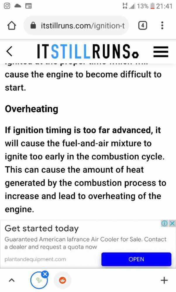

My car is Nissan Sentra 2008, it having these symptoms.
-Knocking/Pinging
-Overheating (Not Extreme)
-Lack of power
-Poor gas mileage
I curiously checked up my timing (BTDC) via thinkdriver obd and I saw that timing was way too wrong, check up the picture attached.
I hooked the same obd to a friend car and the timing is perfect.
Was at 5 (5~30) according to the obd
Can this be the reason?
Can I set the timing myself? (Diyer)
Any video to assit me?
My car is not having a distributor, I dont know what it have but definitely not a distributor because I know what a distributor is.

5 years 6 months ago #48221 by John Curtis
Replied by John Curtis on topic Help BTDC timing
Under what conditions is it overheating?
Are there any codes?
On a cool engine, I’d pull the coolant cap and have someone crank it to see if you can see air pushing through the coolant. If you’re head gasket is shot it may effect your decisions on how to proceed.

5 years 6 months ago #48238 by Tutti57
Replied by Tutti57 on topic Re:Help BTDC timing
Has it been like this for two years?
5 years 6 months ago #48246 by John Curtis
the condition in which it overheats is important. Is it while at idle at stop lights? does it get better when driving down the road? at freeway speeds?
The test I mentioned and not seeing anything doesn't completely rule out bad headgaskets as it would have to be pretty bad to really see it there. A small head gasket failure might not be so obvious. I use a pulse sensor in the coolant system as the most accurate way to prove a head gasket failure. beats the accuracy of the chemical test.
It can absolutely be a timing related issue. But I don't think the overheating and the timing problem are related.

I can rule the overheating out of my symptoms.
Can you direct how to test the overheating issue with the pulse sensor ?
Overheating symptoms can be related to btdc, research well on it well.
When btdc is too advanced its cause engine to work harder than OE specs thereby increasing pressure and heat inside the engine.
Sent from my VS995 using Tapatalk

5 years 6 months ago #48265 by John Curtis
Replied by John Curtis on topic Re:Help BTDC timing
Mariowinax1 wrote: I can rule the overheating out of my symptoms.
I’ve never seen a vehicle overheat due to timing. But... you put the pulse sensor into the coolant system, disable the injectors so the car won’t start, and crank it.

5 years 4 months ago #49371 by Mariowinax1
Replied by Mariowinax1 on topic Re:Help BTDC timing
Issue fixed
That's normal for nissan sentra to have these btc values
Its doesn't use manual setting of timing to run, its uses the camshaft and cranshaft to automatically set timing.
Thanks everyone
