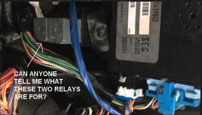

5 years 6 months ago #48292 by Sopey52
Please Help Identify these 2 relays was created by Sopey52
At the risk of being rude I am making a separate topic asking for help Identifying these two relays under the right side of dash in corner behind glove box to left of BCM in a 2003 Chevy Venture. I think the 2 relays or at least one of them are anti-theft related. I have searched all over the internet with many keyword variations and have only found speculation that they are Retained Access Power relay and or anti-theft.
Can anyone please tell me what these are?
Thank you in advance.

Replied by Sopey52 on topic Please Help Identify these 2 relays
Bump. Hoping someone can tell me what these relays are for.

Replied by Paul P. on topic Please Help Identify these 2 relays
The left one is the Rear Window Defogger relay; the one on the right is the Theft Deterrent realy.
