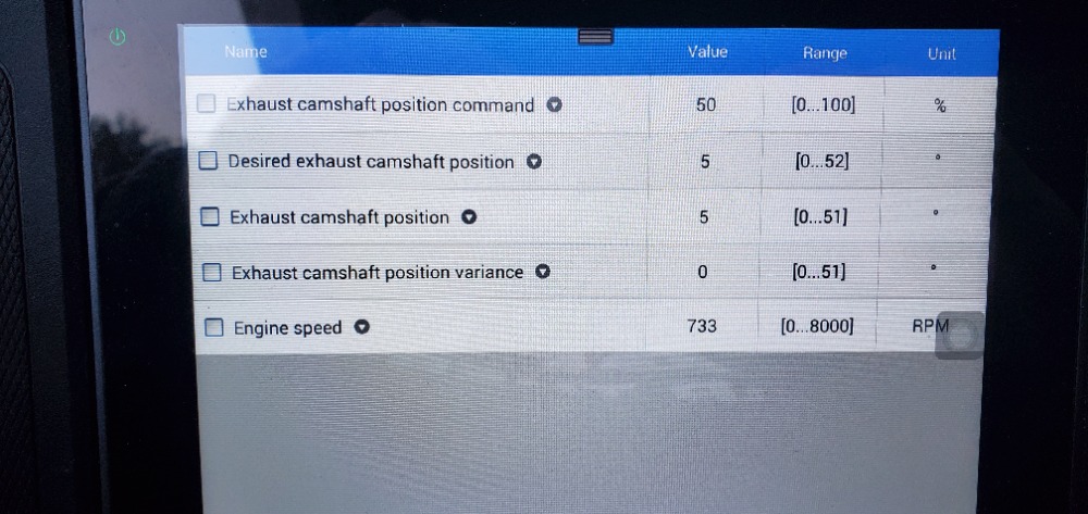

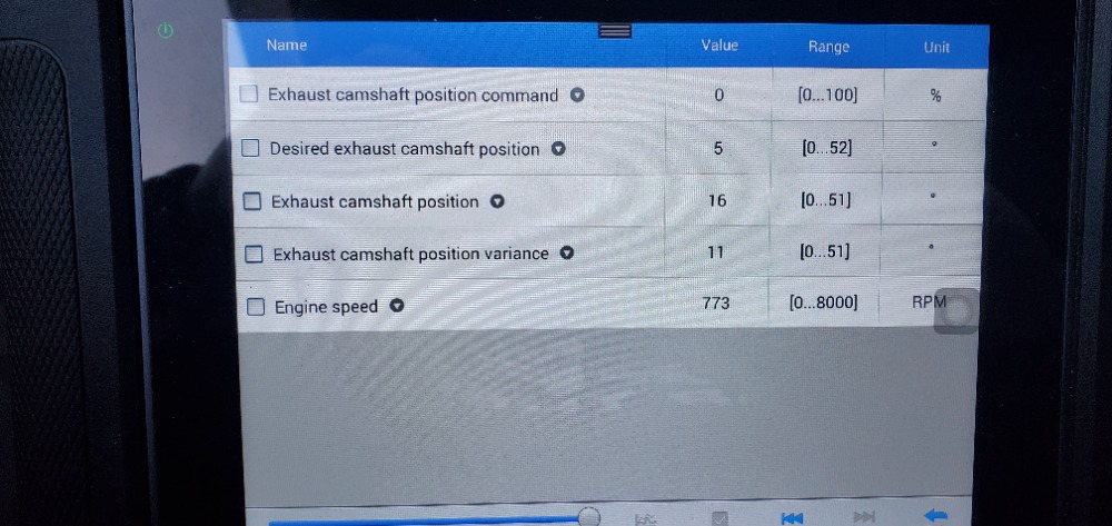

Bit of additional info that leads me away from cam crank correlation issues is the fact that I did the timing chain and tensioner on this buggy 4 times double checking my work. First time was because I did time it incorrectly because I did not know there was a shim on the face of the crank and used a different mark and did have a correlation code. Re-timed it and that code never came back. Permanent code cleared for cam crank correlation.
I then aimed my sites at solenoid, problem persisted then aimed at actual cam actuator. Then bought an actual Autel scanner along with the maxiscope with the intention I could see more and test more.
What I did find is that the scanner says exhaust cam desired is 5 degrees at idle and the Mitchell diy manual says it is supposed to be zero any other info I found on the net said back to zero at idle. When I unplug the solenoid the actual timing reading on the scanner goes right to zero and the engine smoothes right out.

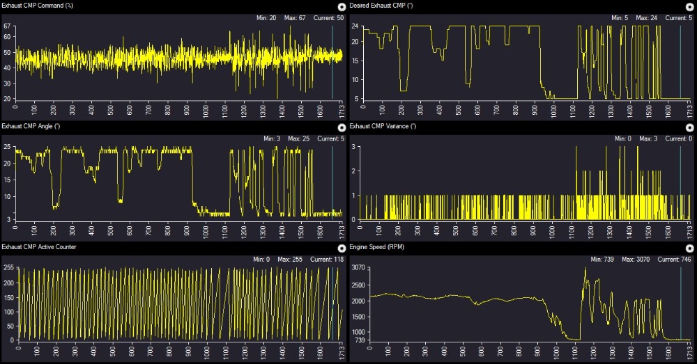

As I recall, the PCM commanding the exhaust camshaft to 5° at hot idle is not unusual on these engines. Some intake advance isn't unusual, either. Not saying the problem isn't VVT related, just noting what I've seen on other LEA/LAF engines.
What do the Exhaust CMP desired and variance PIDs say during the misfire? If the desired PID shows that the PCM is asking for 5°, then I'd argue that the PCM is getting what it wants. If the desired shows zero, then there's definitely a problem there.

I find it odd that 5 would be okay when the manual says expected desired at idle is zero for both intake and exhaust. But the actual position when it starts to misfire becomes erratic with a variance from about zero to 9 degrees if I am remembering correctly possibly higher from desired 5 degrees at idle. Which could possibly be the reason for this cams sensor code I think. Never staying at 5° at idle and rarely hitting zero where the manual says it should be.
The variance of 0-9 seems suspect, IMO. Like the PCM can't get a hold of the exhaust cam.
For whatever it's worth, I dug up a known good capture from a 2013 Equinox. LEA engine, VIN K:
www.scanshare.io/share/RR6x5wkks0OwIsJzZRperg#0,2,4,6,8,11,13
Not trying to prove it to you, as much as prove it to myself. :silly: Hate to say stuff like that in a public format and not be able to back it up.

5 years 6 months ago - 5 years 6 months ago #48409 by troy.villeneuve
I appreciate any and all ideas as well as proof. My eyes go a bit crossed when reading graphs but I do see at idle it is clearly not bottomed out at zero. Not sure if I can trust anything now in this manual... The scan images are worth a lot, thank you. I don't think my scan tool graphs them this well if I was trying to do that. I don't think the time base is as fast or adjustable but I did run this test cold vs hot yesterday. While it wasn't misfiring badly enough to log misfires yesterday I could feel them and the variance and command were both erratic during misfire. The command to keep it stable is erratic as well when the variance at a higher value than what you'd think is acceptable the command usually drops to zero percent but seems to be jumping around when the variance is not stable but more stable if that makes any sense. On the rare occurrence it hit zero variance you can see command is at 50% When doing the active test on the cam phaser I did not see any noticeable difference cold vs hot. And was able to get it up to 25 well 24. With only 30 seconds to run this test it failed just before it would have needed for a millisecond to catch up with the command. Remembering back to doing this phaser/actuator test before and after replacing the phaser the new phaser was much more responsive and was able to get past that 20° limit it had before. I had previously pondered oil pressure or flow thinking that the same oil is giving the intake cam good performance I was thinking it was probably okay. When I had the phaser and solenoid out I made sure to blow through the oil journals in the cam end into the block to be sure there was no blockage there but can't be 100% sure there isn't a blockage somewhere in the head but I imagine it likely uses the same flow path as the intake cam supply. Looking forward to any thoughts/advice you might have. Thanks againTroy
Last edit: 5 years 6 months ago by troy.villeneuve. Reason: Wrong image

5 years 6 months ago #48465 by troy.villeneuve
Apologies for my last response and it being laid out terribly. Saw that I posted two of the same image, tried to edit and it seems to have been turned into one big paragraph.
Either way I am hoping for some tips or advice on how I should proceed in determining why the exhaust cam angle actual and command becomes erratic at idle.
