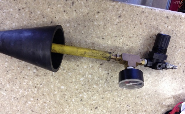

As for finding it, there's a few different ways. Smoke machine is one. Using a mechanics stethoscope around the flanges and O2 ports is another. Personally, I use an exhaust cone adapter with an air pressure regulator. That way, I can look for leaks with the engine off, and spray the exhaust with soapy water to find leaks.

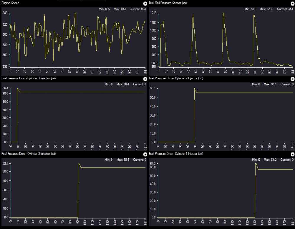

I have heard from a few different sources (ScanShare.io, iATN, others) that fuel injectors are a common cause of this code. :blink: It doesn't have so much to do with their flow rate, as it does with the injector tips becoming clogged and degrading their spray pattern. The fuel trims don't notice it, but the downstream fuel control is sensitive enough to pick up on the imbalance.
I know, it sounds crazy! :lol: But that's what I'm hearing out of dealer techs. If you have access to a scanner with OE functionality, you can try the built-in injector balance test as a starting point. Here's an example off a known good 2.4L, as an example. Note, the ScannerDanner rule-of-thumb about 1.5 PSI variance between injectors does not apply here.
9 years 8 months ago #6507 by ghost
Replied by ghost on topic 2010 Traverse 3.6L showing a P2099
Thank you both for the ideas. Right now my plan of action is to figure out a way to plug the exhaust and pressurize it from the rear. Climb under and look for leaks with a soap solution. I know it won't take much pressure but is there a recommended max pressure so nothing gets damaged?

9 years 8 months ago #6562 by Ephratah
Replied by Ephratah on topic 2010 Traverse 3.6L showing a P2099
Tyler what kind of pressure do you use on the Exhaust tester that you made?
9 years 7 months ago #6608 by Tyler
Replied by Tyler on topic 2010 Traverse 3.6L showing a P2099
Ephratah wrote: Tyler what kind of pressure do you use on the Exhaust tester that you made?
I usually dial in about 5 PSI, maybe 10 depending on how many leaks are in the system. I find that, if you keep dialing in pressure above that, you end up making stuff leak that wouldn't under normal operation.
I've been TOLD that you can damage stuff if you go too far, but I've never seen it. I consider it a pretty safe test overall.
